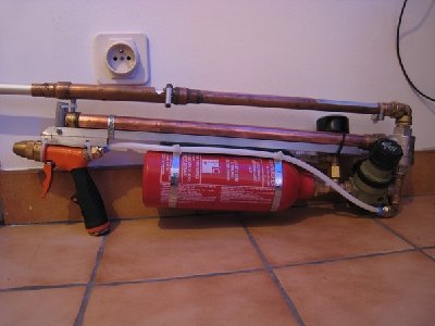

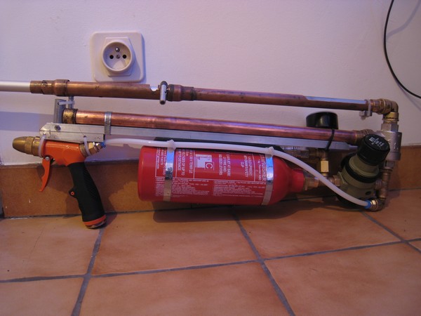

I'm proud to show you le last air rifle I've created (2 years ago at least, I'm a bit lazy since returning to studies)
Air supply is in semi-auto mode but I have to feed ammos by hand in the breech (10mm ball bearing are commonly used)
Fire extinguisher pressurized to 20 bars (300psi) , pressure regulator to adjust the power of shooting, 1/2" QEV and because I'm french the trigger is a hose trigger as usual here !
Typically, I shot at 6 bars, and even with this low pressure, ball bearings go through metal sheet of approx. 1mm, plus 15mm of agglomerated wood...
I can also shoot some 14mm ball bearings which have some massive impact on th target but not so much penetration.
Third choice ammo is obviously a nail taped whith paper (homemade dart)
With specific concrete nails, you got a reusable dart with impressive penetration power !
I can trigger about 8 times before the pressure drops below 6 bars.
I use my fridge compressor to pressurize the tank.

Hey X3,good job and nice rifle!What kind of adapter have you used for the fire extinguisher?Because i have the same tank but it isn't a standard bsp thread and won't fit with common adapters.
For your cannon,the only suggestion is to reduce pilot volume that seems to be too big.

-X3- wrote:Hi all,
if you would of make your own qev your gun would be much pretty and easy to cosmetize
