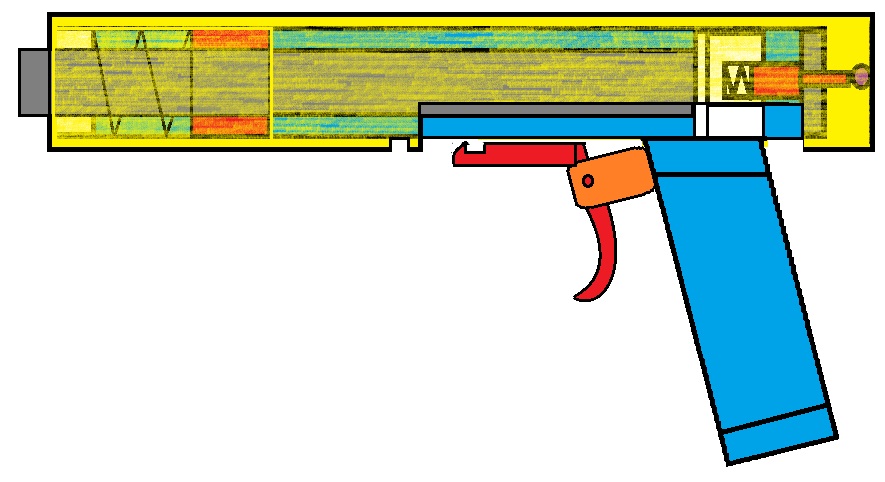

Netherlands
Posts: 3497
Your pressurevessel welding skills could really come in handy.
Not many members could pull my proposed idea off..
As so happens it does need some part of it sticking out past the grip.
I'm quite sure there are numerous improvements possible but ...
Here is the basic idea:
High-PSI
Posts: 231
Joined: Sat Oct 09, 2010 7:43 pm
Location: Nothern Illinois
Looks very good. I like it! Many of my thoughts are fleshed out in your design.
Hmm, I guess the only real question for me is firing mechanism. A purely pneumatic pilot system sure is easy to acheive and does not require cocking. But, it is not as compact and does not lend itself to pressures above 600 psi (or it becomes much more difficult to use reliably above that pressure) at least from my experience.

OK, I think I have a bit ironed out;
If I were to build this gun right now, I think I would go with a piston coaxial. A diaphragm coax is a touch shorter, but I do not want to trust a diaphragm with this much pressure. I think steel would be a good option. The tank face would be machined and welded. The rear would have a flange that would be welded with a series of holes drilled and tapped to bolt the rear of the chamber/piston valve housing to.
I think a 1 to 1 tank to barrel ratio would be best for this due to space constraints as well as efficiency. I like coaxes for the nrear zero dead space as well.
