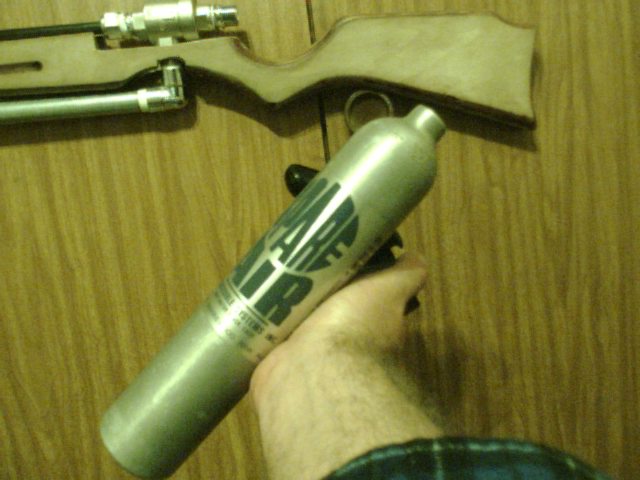

You can buy c02 cylinder's similar to this hpa air bottle (in photo).
Search "aquarium co2 cylinders" on ebay.
$35 bucks, plus postage...refillable
and 3000psi pressure tested. They can be
sent to australia coz their "empty" when sent.
