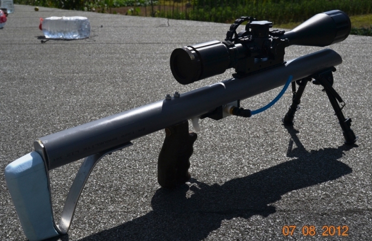

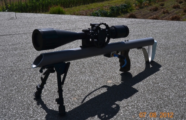

Recently I got a lot of good stuff, hydraulic/pneumatic parts, etc.
So, I decided to build a airsoft sniper rifle, my objective it´s to see how accurate a airsoft bb can be.
I used a 1/4 3-way valve to pilot a 1/4 QEV, the exhaust port of the 3-way is suppressed. But I´m not going to make it semi-auto, instead I will use bolt-action plus magazine for reloading.
The gun isn´t finished yet, I still haven´t decided the barrel/bolt configuration.
Video made at 5 bar, I tested 10 bar after the video, the QEV really rocks off the ground :D

Your stuff is getting better and better!!
Love the clean look so far!
I'm looking forward to seeing it completed.

Thank you sir :P
By my stuff getting better and better you meant the scope isn´t it :lol: actually it wasn´t expensive.
For the valves, I bought like 10 DCVs plus a couple of QEVs and other parts for less than 100 euro :P :D also now I have 6mm steel bbs :twisted:

That is a very appealing creation that you have done!
Excellent work and keep it up. :)

That looks really nice, you should make the barrel come out of the grey tube.

Goats the barrel isn´t there yet :wink:

Have to agree with everyone else...that IS looking good. :thumbup:
Kind of a Condor/tube gun thing going on that has major appeal. :)
