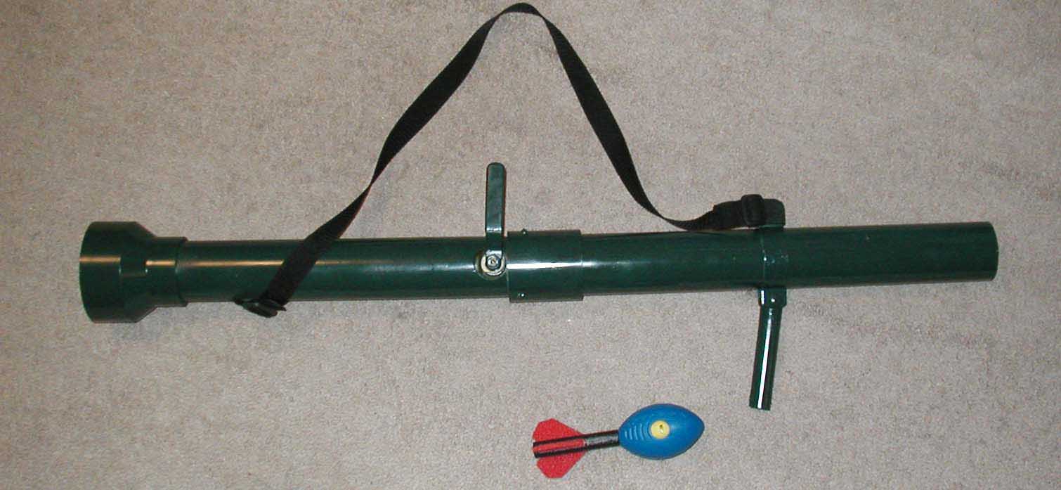

Hi guys! I have built a couple of pneumatic cannons over the past few years but now I want to step it up a notch. I play milsim airsoft and the game I am going to be playing at I need to make a 2" nerf cannon to be able to take out vehicles. This needs to be something that I can attach a paintball hpa or co2 tank to. I want to go with the single line look similar to a LAW. I understand how to make simple cannons. I was wondering if you guys could help me with the design of a constant air nerf launcher. I attached a pic of something i would want it to look like, i just need to know how to make it a constant air cannon. thanks!

I guess that didn't make much sense lol. I want a constant supply of air going to the air chamber so once I fire ( by moving the ball valve lever down) I can return the ball valve lever to the closed position. Then the air can just fill up the air chamber again. What I need to know is how to limit the amount of air that goes into the air chamber to about 150 psi. Is that even possible? Or should I look into another design. Sorry I really don't know what I am doing on the project but it needs to get done somehow

I'd start with an HPA tank rather than CO2 because you don't want to freeze your gun. Or you could make it out of metal... But I was going to suggest a pvc chamber filled by a regulated HPA tank. You just have to buy a regulator. I believe Palmer makes some good regulators that will dial it down to the pressure you need. They're called low pressure regulators or stabilizers I believe, just look them up. From there I would use a modded sprinkler valve to keep things simple; that way it would close right away so your chamber can fill up and it is actuated by an actual trigger unlike a ball valve. Then a few feet of 2" PVC nerf vortex barrel and you're all set!

Dart: I don't think a cartridge burst disk would be the best idea. seems expensive and a little slow to use in war.
I agree with gun freak and go with a modded Sprinkler valve with a breach.
