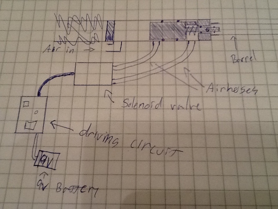

I was discovering PolarStar Fusion Generator and I got idea of semi and full auto valve MAYBY based to PolarStar but I'm not sure, becose I can found diagraphs for PolarStar.
So theres my idea
Semi and full auto valve idea
How does it work exactly? Does the solenoid push the bolt back and forth by alternating flows?

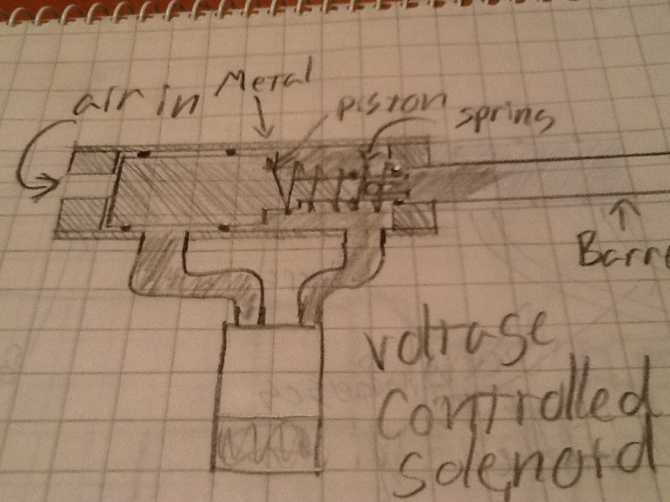

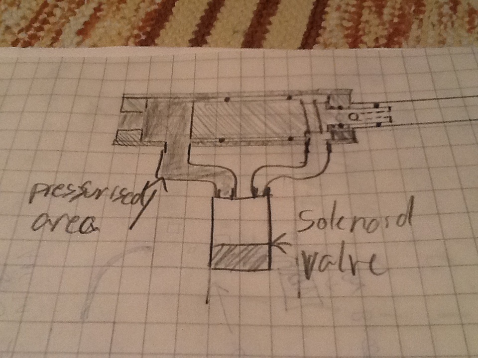

Picture says more than thousand words.
From picture 3 cycle comes back to picture 2

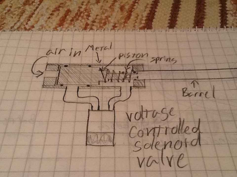

So you are using a solenoid valve to "pilot" a shutoff valve? Good idea, hope it will work

The problem I see is this: if the air goes in too fast it might slam that piston up against the front pretty hard and over time could deform the front. Maybe add an o-ring or rubber washer as a damper.
I see no reason why this valve shouldn't work. Are you going to extend the point of the piston to act as a BB injector? That would prevent double feeding.
I agreeGun Freak wrote:The problem I see is this: if the air goes in too fast it might slam that piston up against the front pretty hard and over time could deform the front. Maybe add an o-ring or rubber washer as a damper.
Yes. Theres maby bb feeding problem at high ROF.Gun Freak wrote:Are you going to extend the point of the piston to act as a BB injector? That would prevent double feeding.
