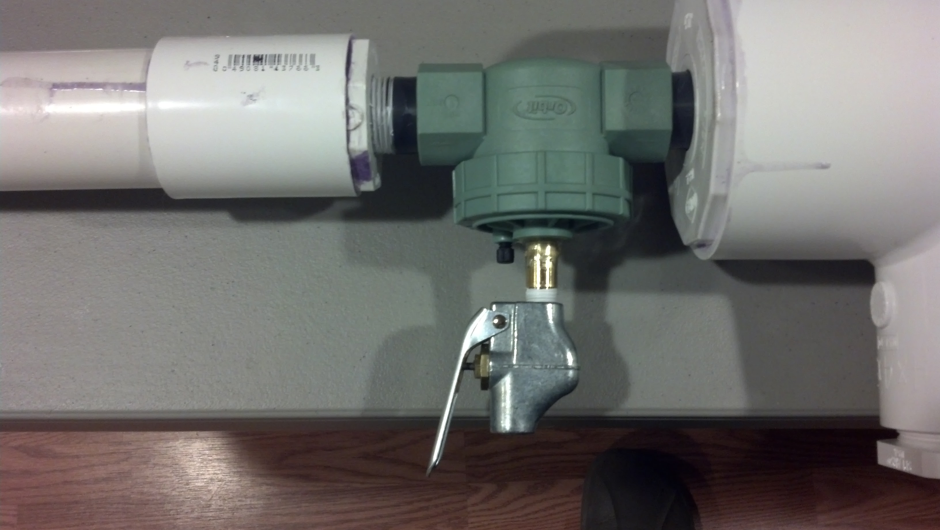

I am building a pneumatic cannon using a modded sprinkler valve and schedule 40 PVC rated to 175psi. As I will use it to launch paintball grenades at people, and fire sabot rounds full of paintballs, I would really love to run it off of a CO2 tank. If I can regulate the CO2 down to 150, then I would likely fill a big 4" PVC expansion chamber with an inline valve, load, and then fire with the sprinkler valve. I intend to make it pump action with a gravity loading clip once I get the basics working...

Got to thinking that this thing might be more space efficient to lug around and allow for a longer barrel without being unwieldy if I went with a coaxial design.
What do you guys think? In-line design with a chamber behind the valve, or coaxial design? I am using a blowgun to trigger the modded sprinkler valve. Any suggestions on a good way to make this pump action loading with a vertical gravity fed grenade magazine?

Quick question about my current blowgun piloted sprinkler valve design: if I give the blowgun a quick squeeze to fire, will the sprinkler valve automatically reclose as soon as I release the blowgun trigger? I am thinking about having the palmer reg supplying constant ~150 psi input to my 4" diameter chamber and just firing with the modded sprinkler valve using the blowgun. The other possibility is just adding this button valve http://www.amazon.com/gp/product/B0098W ... UTF8&psc=1
between the palmer reg and the 4" air chamber to allow manual control of when it is filled.
Do you think that is necessary or a waste of a valve?

That's the theory.Quick question about my current blowgun piloted sprinkler valve design: if I give the blowgun a quick squeeze to fire, will the sprinkler valve automatically reclose as soon as I release the blowgun trigger?

Cool. Thanks, Jack. I am going to go with an in-line design with the main supply coming in the back of the firing chamber, then a modded sprinkler valve between the firing chamber and the bolt.
I'll post some pics of the build process along the way. Just waiting on some PVC fittings to arrive after ordering them online from Homedepot.com. They aren't the fastest...
