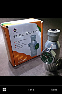

This is one I was looking at.

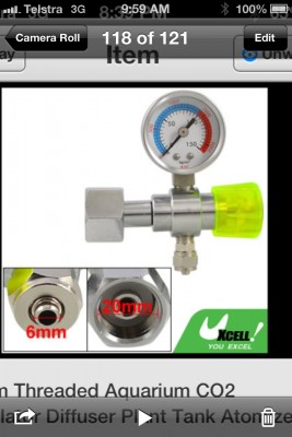

And this is the other. Sorry about the double posts. Really need to get back on my computer and off this phone, need a bloody magnifying glass to see the screen.
Thanks for any info guys .
Gabriel S wrote:it seems to have a good useful regulator you need to spend a wee bit of cash
This is the unfortunate truth, regulators are one area where you can't really skimp on spending a bit more to get a quality product.

Thanks guys. I'll have to look around some more. Not sure if I'd get in one of those palmers into Australia. Would this one be any good? (First pic sidnt work) Similar to the second one Gabriel s posted.
Cheers again guys
I think the general rule is that if it's cheap, Chinese and sold for aquaria, it's not going to be safe or reliable.
