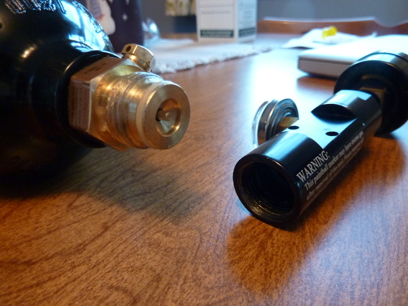

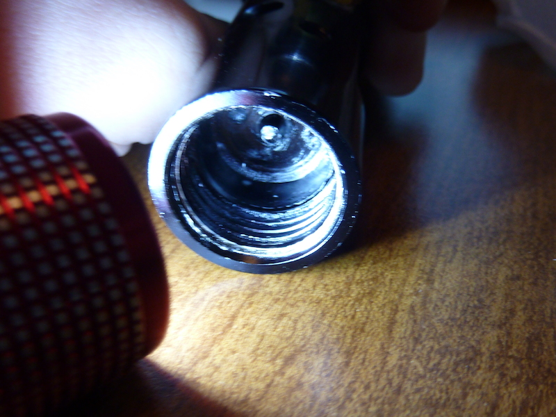

Trying to mate a a paintball tank out with an asa female regulator. Pics:
- Been thanked: 350 times
A paintball tank has an ASA thread, they should fit... is the reg not deep enough to reach the threads?
