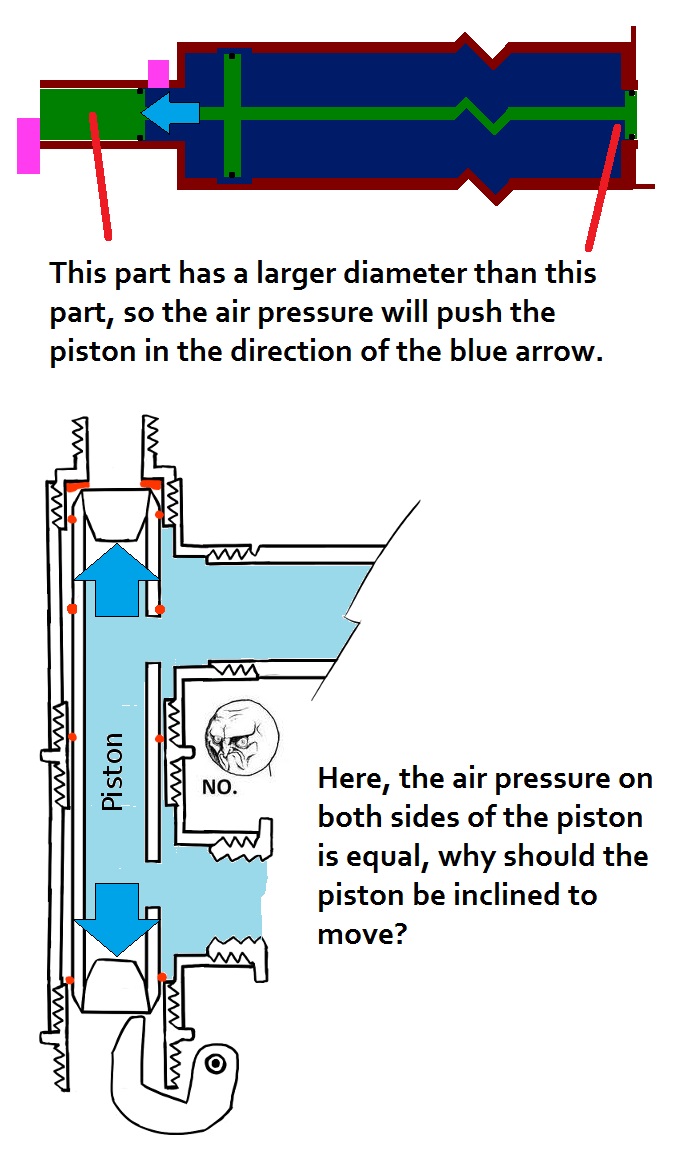

Ukilliheal's gun (maybe you already know) uses the already familiar sprinkler valve as a Q.E.V./pilot triggered valve, and a special bolt which makes it self loading. What enables it to be automatic is a safety valve (otherwise a valve that opens once certain pressure has build up) connected to the pilot of the sprinkler valve. Therefore, a reservoir (in his case, a compressor tank) will fill the chamber controlled by the sprinkler valve to a certain point where the safety valve opens releasing all the store pressure into the bolt, risen and repeat.
I find Ukilliheal's design quite inefficient because each time the safety valve opens, it will waste reservoir's air to the outside. So, I deviated somewhat from that. In the research I made, I've found out about the "HEAR" valve by GB Semi (which if I'm not mistaken, means "High Efficiency Auto Reseating"; http://www.spudfiles.com/pneumatic-cann ... c7899.html). He also uses the same self-loading mechanism as Ukilliheal and myself (although, we three are building it differently). Nonetheless, I disliked how complex looking and difficult in building his HEAR seemed to be. So I also modified that and in a quite heavy way. This HEAR valve acts as the sprinkler valve, safety valve and a regulator (I guess, must test that to be sure), all in one valve.

At the time of writting, I have all the essential parts made but I'm still struggling with the alignment in the bores of threaded unions in which the pistons slide (any tip? Should I tap a pipe instead of using off-the-shelf unions?). Also, I think that I'll be needing O-rings and gaskets, but first I need to buy an adapter for my tank compressor to try that out.
