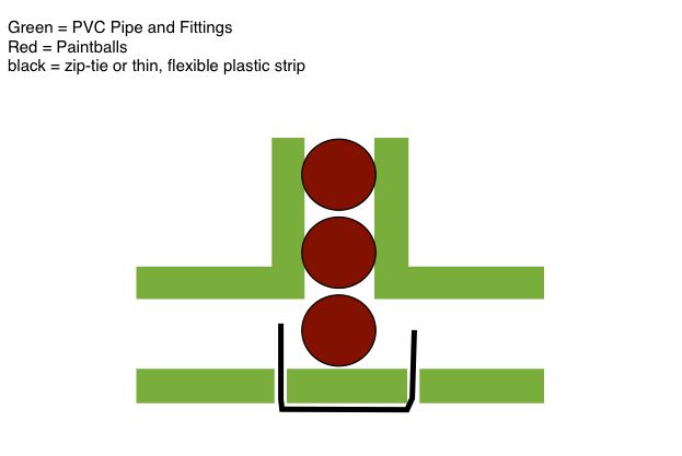

Easy Detent system to keep your paint from rolling out of the barrel:
Screen Shot 2014-03-05 at 5.31.23 PM.png (25.82 KiB) Viewed 7096 times
