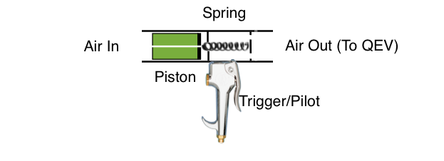

Due to size constraints, i'm not sure if it can fit in the gunstock. So I was doing some thinking, and came up with a shut-off valve:

How does the "shut off valve" work exactly?

What it was supposed to do, was work like a slide valve in the fact that it should shut off the air source while piloting. I built one, and it kind of works, but not really any better than just putting a flow restrictor in place behind the pilot.
If I make a cast epoxy qev piston, and spring behind it, could I chamber fill and pilot from behind with like a blowgun or something simmer?

1nxtmonster wrote:If I make a cast epoxy qev piston, and spring behind it, could I chamber fill and pilot from behind with like a blowgun or something simmer?
Pretty much what I did here using a schrader as a pilot.

Yep, pretty much that. I'm making a pilot valve like this:
