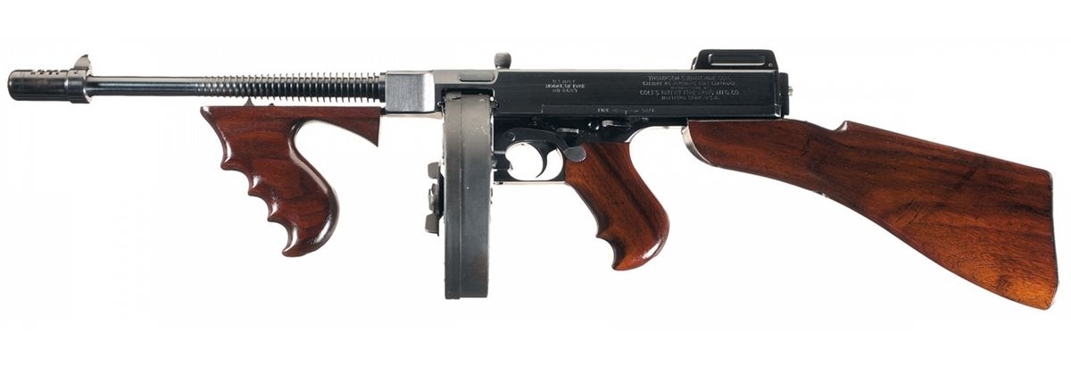

by Talk
Since you have some machining skills, you can make a steel body for that and give it a Thompson SMG design
The attachment Thopmson.jpg is no longer available
I don't have any resources to build guns so I thought I could give it to someone who can build these.
