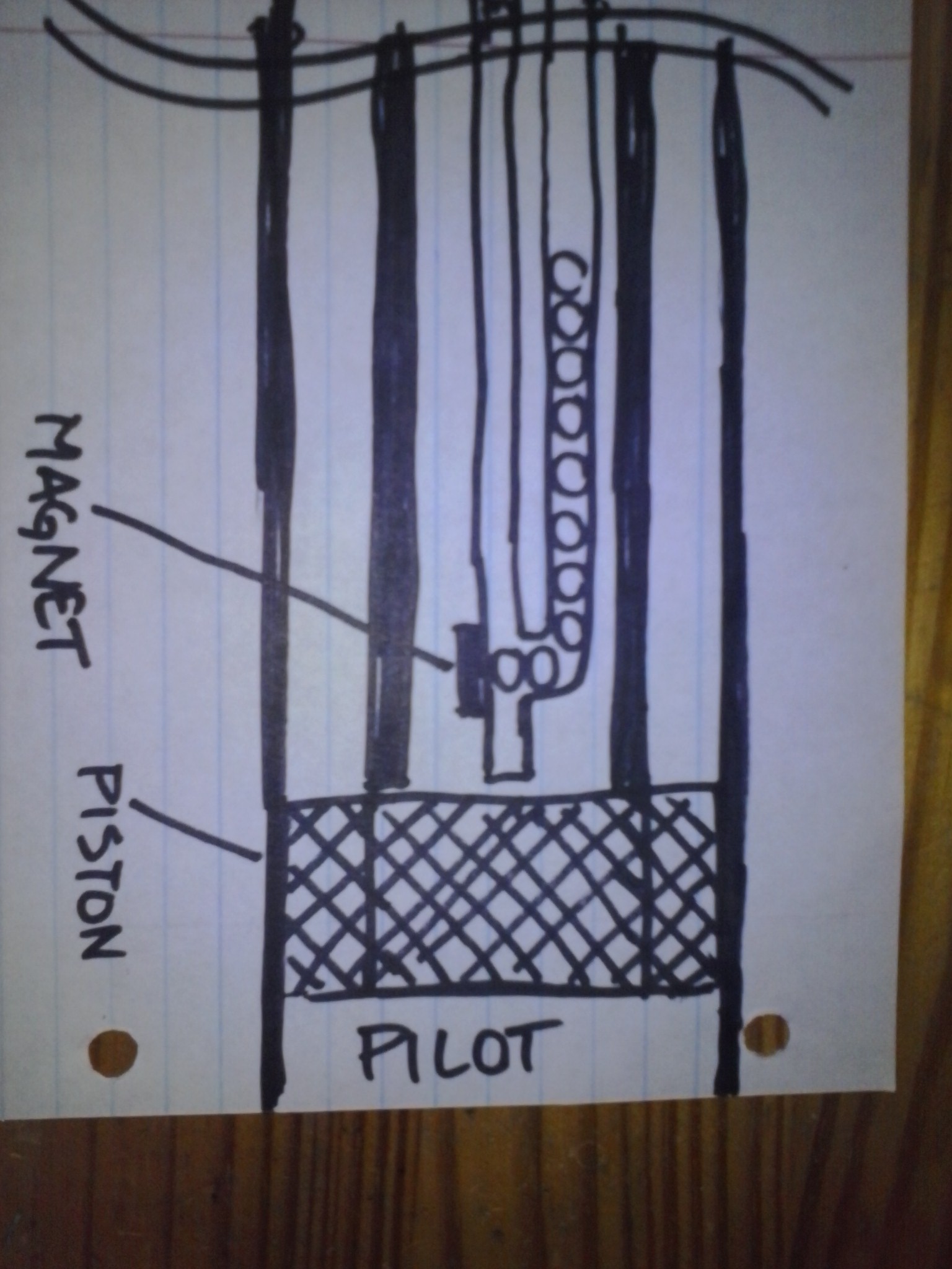

So this is my "re-rendering " of your idea. Standard coaxial but the "barrel " actually holds your barrel/mag. combo. I do have soft copper for the mag. tube so the 90* bend at the breech can be fairly uniform. ( I didn't draw in the epoxy plug at the sealing face ,just assume it's loaded with epoxy !)

dajoro wrote:I think I read you had some issues with feeding ammo around the "BEND" at the barrel's breech , the ammo had to turn 180 degrees.
This one?
http://www.spudfiles.com/airsoft-pellet ... 21851.html
IIRC the issue was with the detent, not the bend. In your case, you wouldn't need one.
What seems to affect power with detent mechanisms is how quickly the next round follows the first into the breech, because effectively the delay between one projectile fiting and the next one sticking in the detent is the "valve dwell time".

""IIRC the issue was with the detent, not the bend. In your case, you wouldn't need one.""
WHAT? why I no use detent !? The magnet detent is very important to control ball drop.I suppose it also adds a slight resistance to the ball in breech , just like a mecanical detent would . Of course, that only effects steel balls. I could re-design the device to accept plastic balls , lead balls or the customers required balls of choice.

dajoro wrote:WHAT? why I no use detent !? The magnet detent is very important to control ball drop.I suppose it also adds a slight resistance to the ball in breech , just like a mecanical detent would . Of course, that only effects steel balls. I could re-design the device to accept plastic balls , lead balls or the customers required balls of choice.
A magnet detent is fine, it was the o-ring seal detent that was causing the issues.
