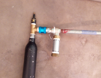

New QEV+Slide Valve combo, I was wondering, I removed the pin valve from the tank and I noticed that the threads inside the bottle were really close to 3/8 NPT, however, after about 3 turns the 3/8 nipple wouldn't screw in anymore. I looked around and read that the thread was like 5/8-18 UNF, but since the 3/8 nipple can go in a few turns, is it safe to force it in there further? I'm asking because I want to remove the 1/2'' coupling and go with 1/4''-->3/8''-->Tank.

It would probably be safe to epoxy the two fittings together, if you aren't planning to take them apart.

Nope, the barrel isn't an actual barrel, it's a breakline, it's only temporary though because its the wrong size, .5mm too small for .177 =[, I did however, order a stainless steel tube off amazon which the I.D is suppose to be .18'', waiting for that to come in. And then I'll find a way to mount the scope and start shooting. This is a link to the tubes, relatively cheap and comes in a load of sizes http://www.amazon.com/Stainless-Steel-S ... EX83HQF2N6

Ghetto Scope Mount =D

That looks suberb, I will be chuffed if mine looks half as good, I am going for a very similar setup to yours, only think I would. Change is the blue of the slide valve, but that's just how most are.
What did you use for the 'T' is it just a plumbing fitting? Also how did you attach the Schrader filler to there's piece, what parts did you use for both, currently I was just going to solder a derubber valve casing into some kind of brass fitting and go from there, but it won't be as tidy as your set up.
I don't think, or have not seen nice threaded 90° brass pieces like you have used, just googled and they seem to be a US style in NPT thread, ohwell!!

So barrel finally came in today and... my god do the .177 fit in there just right, see for yourself
Sleeved in 1/2'' PVC painted black, scope mounted, finished product =]

@Ianbuckwell The T is a 1/4'' T, all fittings are 1/4'' NPT (including the schrader valve), I got all the fittings from Home Depot (except the schrader valve). Here's the link to the schrader http://www.amazon.com/gp/product/B000HE ... UTF8&psc=1 hope that helps out.
