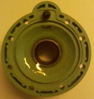

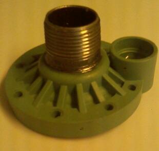

With an 1.5" valve solenoid piloting should probably still be ok, but you still won't get the power you will if you mod the valve.
I usually remove the guide rod or cut it off. Just make sure you seal the hole the epoxy.
I've seen a blowgun added off to one side and it should work, but I've never tried it myself.
If there are any bleed holes to the exit side of the valve be sure they are sealed with epoxy or the valve will not function properly. Some valves do some don't.

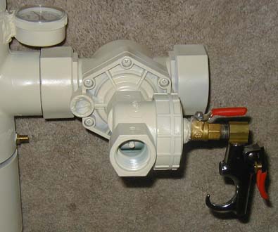

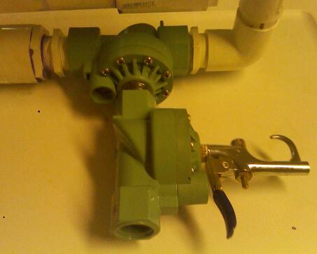

I pilot my sprinkler valves with a smaller sprinkler valve. Here is a 1" valve piloted by a 3/4" valve.
I hope this helps.

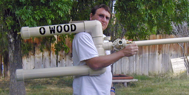

- Many years ago D_Hall piloted his 2" sprinkler valve with a one inch Sprinkler valve.
