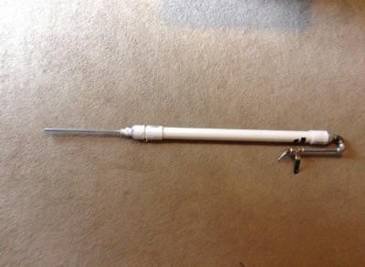

I've wanted to build a smaller bore airgun for a while, I also wanted it to be more compact although that didn't work to well for me :P . I still like it though
The barrel is a length of aluminum round tube that's 3/8'' in ID (not exactly 9mm but close enough with wadding) and almost 1/2'' in OD by 3' long
Chamber is a 2' section of 1 1/4'' pvc pipe
The piston is a 3/4'' pvc cap filled with hot glue and topped off with a piece of sheet rubber (sorry I don't have a picture)\
I wanted to keep it somewhat small and simple so the pilot valve is a 1/4'' ball valve, and I need to attach a thingy onto the quick adapter on the other end of the ball valve
The backstop is a layer of weather sealing tape
I haven't gotten to really shoot it yet since the ammo is still in the mail, but it seems to work pretty well.
The stock is alright but in retrospect I probably should have used 3/4'' pipe and fittings instead of 1/2'', which I had lying around.
Gun without stock
Gun without stock

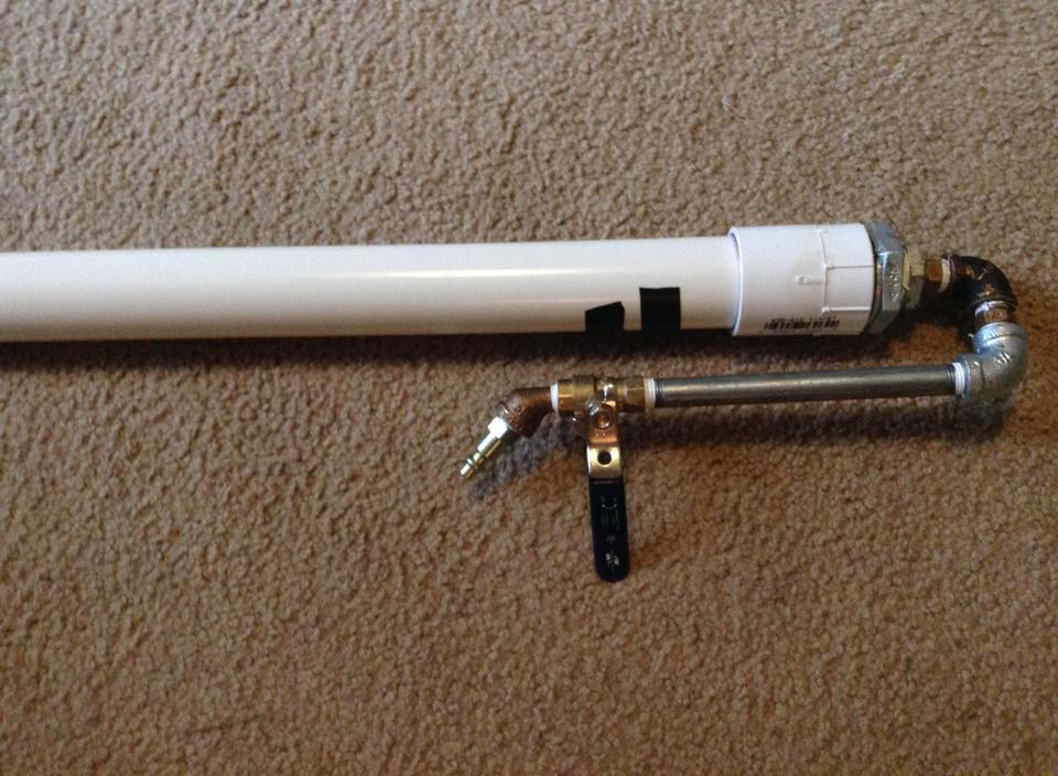

The pilot valve and fill port, the male quick connect is placed at a 45 degree angle down so that air doesn't blast your hand while it's in the stock, and a metal bushing behind the foam backstop

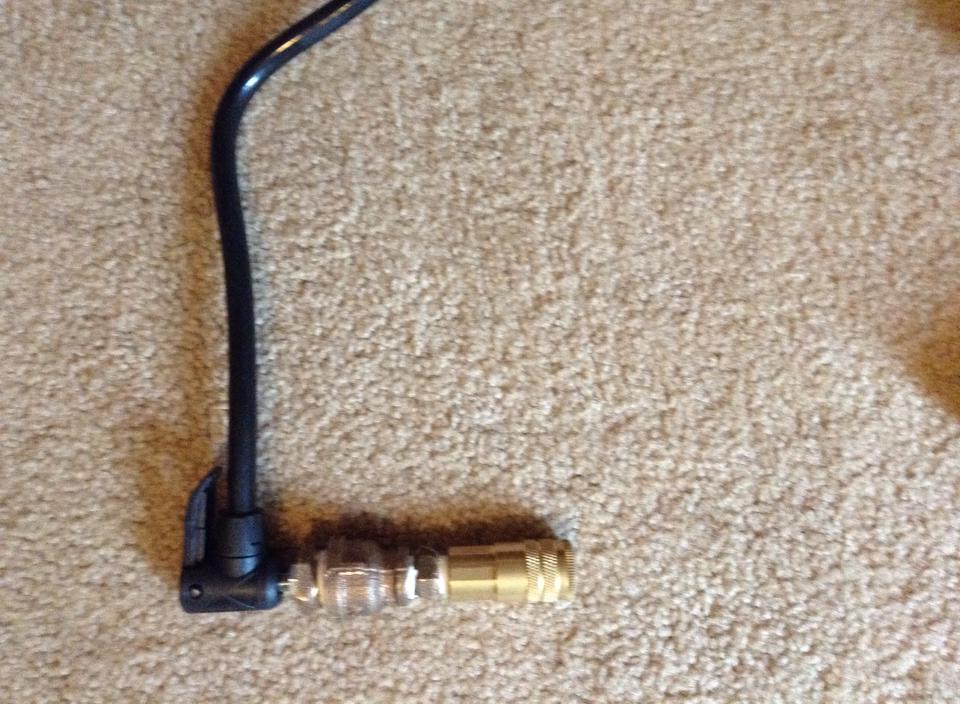

The thingy I mentioned earlier, it's just a female quick connect and a Schrader valve attached together with a 1/4'' nipple

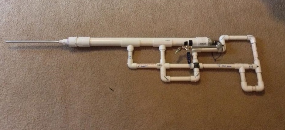

The gun placed in the stock, the black thing near the back of the gun is a zip tie used to anchor the back end down, and the male adapter up front is to attach a barrel shroud or similar, and I want to place a red dot sight I have lying around on top of the gun
