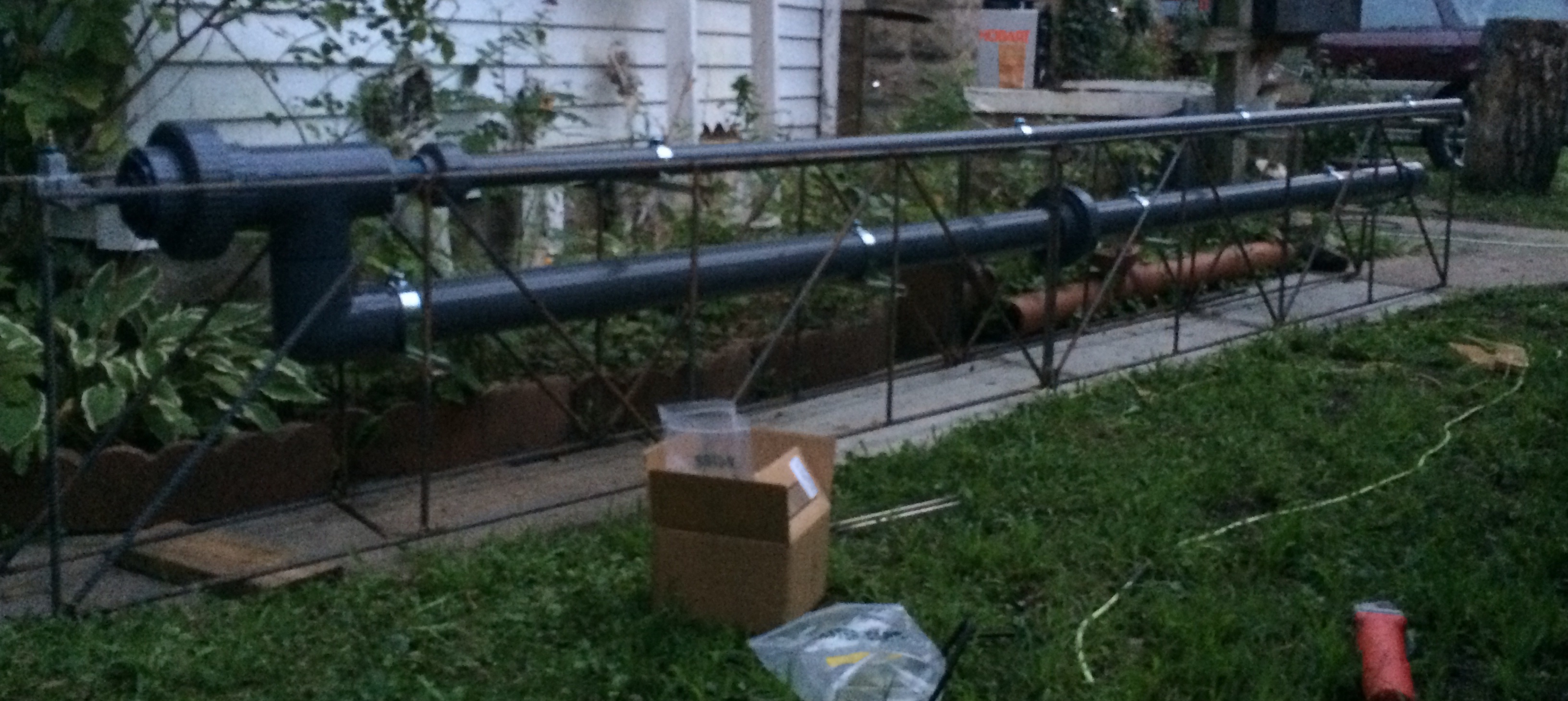

Hello, I am working on building a relatively powerful pneumatic. I am using all sch 80 PVC for construction
With a 2" barrel and 4" for the chamber. it will have a piston valve, and should be good for 300 psi max depending on temperature. I do intend to pressurize, and fire it remotely due to the pressure involved and it being PVC. Now I am trying to determine how to pilot the piston valve which will be based in a 4" tee. I was considering a QEV but was not sure if I could push it to 300 psi. So mainly I am looking for suggestions on how big, and what type of valve to pilot the main piston valve with.
Also I think I came up with a good way to get a 300 psi fill in a reasonable time for cheap. I was looking into it and came across the fridge compressor method, which obviously would take a ridiculous amount of time to fill that much volume. (4" x 10' pipe). So at first I thought I would use multiple fridge compressors, I asked a friend what he had and he had no fridge compressors but had a central ac unit. Got the ridiculously heavy compressor out, simplified the wiring, and by luck it puts out 300 psi while running below rated amps with 120 psi in, with quite a bit of flow. Only major draw backs are the oil like the fridge compressors, and you need access to 240v power. But hey it was free!

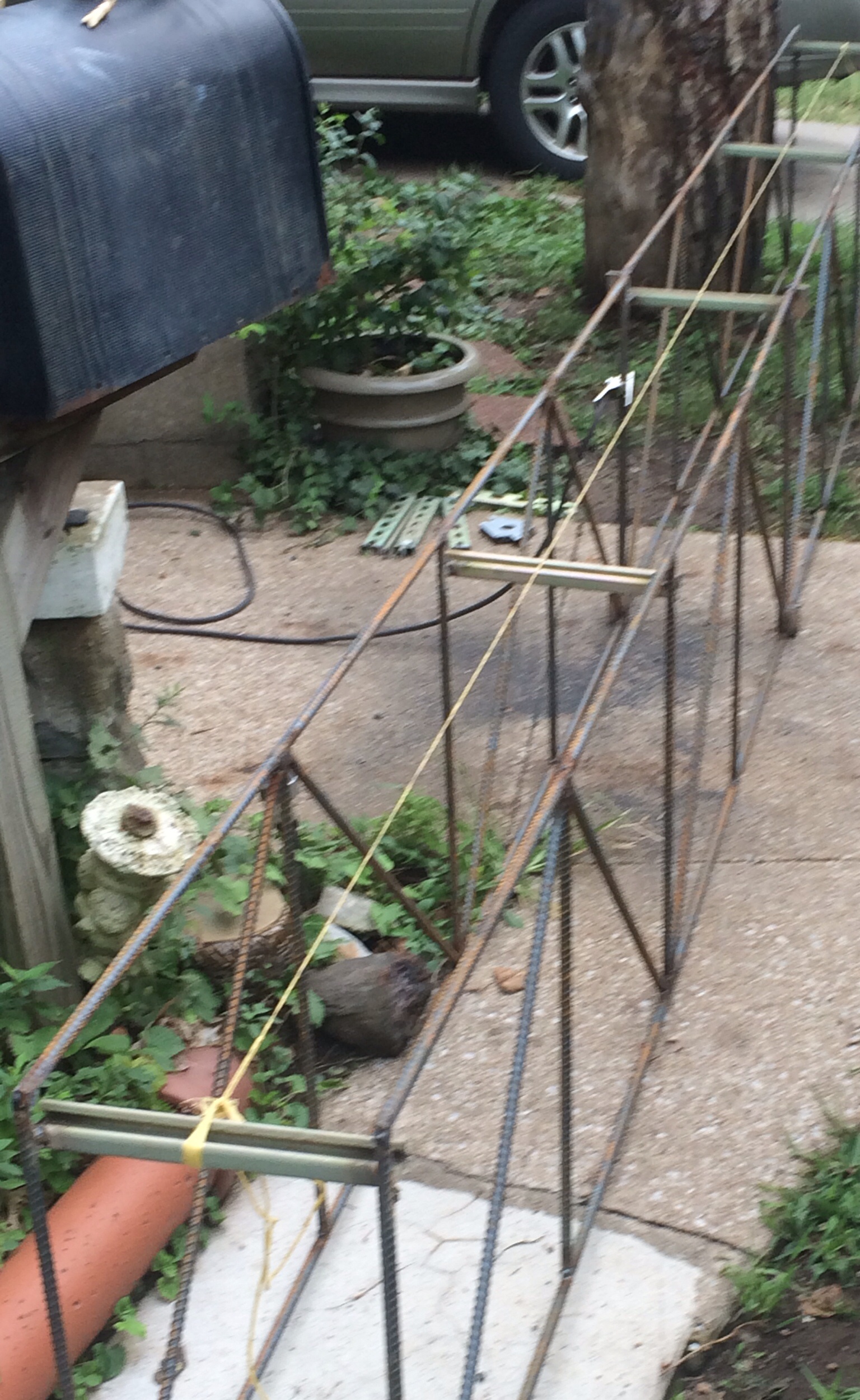

Yes I am definitely aware it may turn out to be more grenade than cannon. I am going to pressurize and fire it from at least a hundred feet to the side so that I am out of range of shrapnel, and the piston if it decides to take flight. Even if I get only a few shots, I will have built a large, medium pressure pneumatic from pvc. I think it may do okay. I am using all glued joints, except for the pilot connection which will be a glued bushing to 1" which retains the 300 psi rating when threaded. I plan on bracing it well to prevent excess stress on the joints. And like I saw somewhere on here I am going to use a small piston on the back of the main piston to block the pilot opening as it opens forming an air cushion to slow the piston with less stress on the housing. But yes, I plan to take precautions to mitigate the hazards of an explosion, and I am entirely aware I may only be buying an expensive learning experience.
