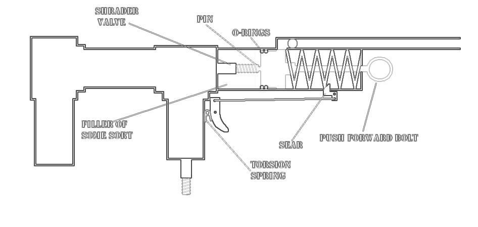

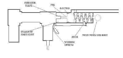

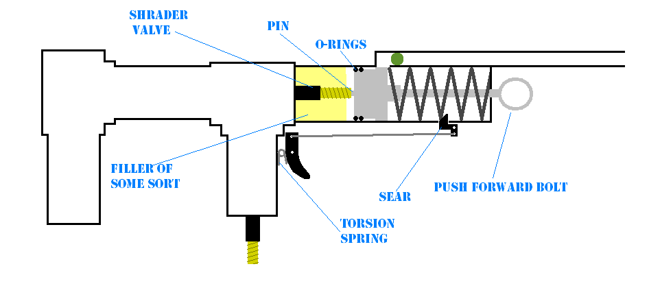

This is just an idea, it would be cheap and easy. I know i should put on a magazine but i forgot to draw it on. Tell me what you think and if you think it will work please. Also I know they are the same picture but can you tell me which looks the best and is easiest to understand? Thanks.

I don't think you will get alot of power out of that because schardar valves don't let air out fast.Have you see a brass one way valve?they do the same thing,do you need me to post a pic?

i think u misunderstood him, he wants a quick refill from the large reservoir into the smaller place.
i dont like the positioning of the shear, what if the spring flexes and cause a misfire? other than that, if you think you can make the small parts work, go for it.
and wouldnt shot after shot be weaker and weaker? use a strong compression spring and a piston in the reservoir to maintain constant pressure
the coloured one is easier to understand btw

Cool thanks guys. Your right saladtossser the power would get consistently weaker. I would use a brass one way valve but none of the shops near me sell them! I might think about ordering one but maybe this design is doomed to fail too. I think maybe hammer designs are going to be hard to perfect but Ill have a go at making one and tell you how it goes. Thanks.
