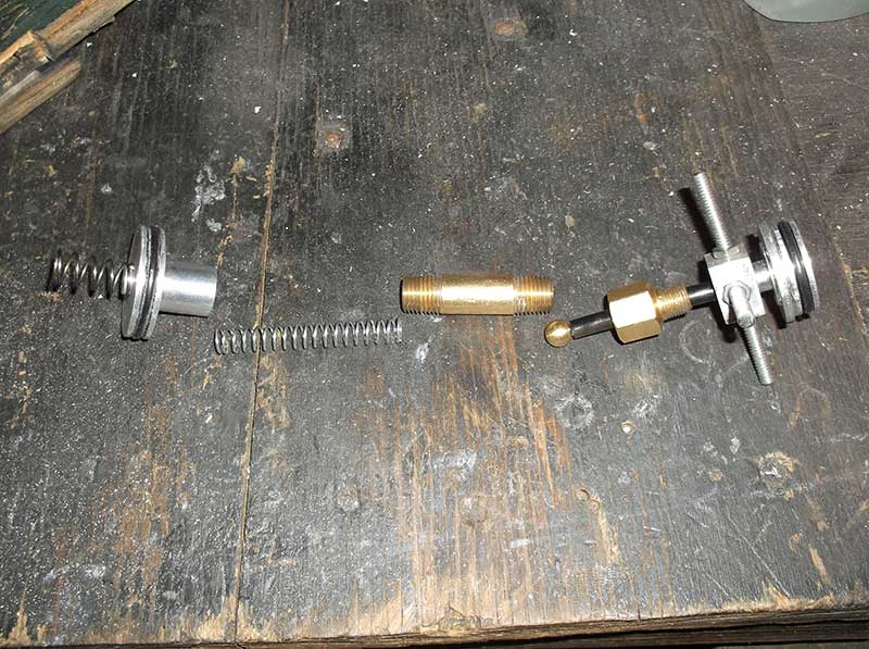

Hey, Jack. I wanted to experiment with using counter-balanced valves like BTB's pilot valve but make it a main valve. I also wanted a small pilot volume.
To explain how it works (if anyone wants to know), I'm going to refer to the back piston as the pilot piston and the front piston as the port piston.
The pilot piston goes back just far enough to unseat the port piston but not far enough for the air to have good flow around the port piston and into the barrel. So a spring is put behind the port piston so it will go back far enough to allow good flow to the barrel.
That cuts down on the backward force of the pilot piston when the pilot volume is emptied because the pilot piston travels back only about 1/4 inch. The rest of the force is transferred to the port piston which pushes back on the long spring. I think this is what is happening.

Technician1002 wrote:You might be OK with the port piston O ring in the smaller diameters if you don't use a floating o ring.
My initial tests of a 2 inch floating o ring in that configuration resulted in loss of the ring on shots above ~60 PSI. Non floating ring designs tend to get stuck and fail to fire reliabily.
I also had trouble with the o-ring flying off the port piston on ealier versions. I solved that problem by adding a type of wind breaker behind the o-ring. The diameter of the piston is larger behind the o-ring so as to divert the air flow above the o-ring. It also guarantees the piston can not escape through the port hole.

The green part is not airtight. I think the backward force of the pilot piston is transferred to the port piston when the pilot piston abruptly stops.
