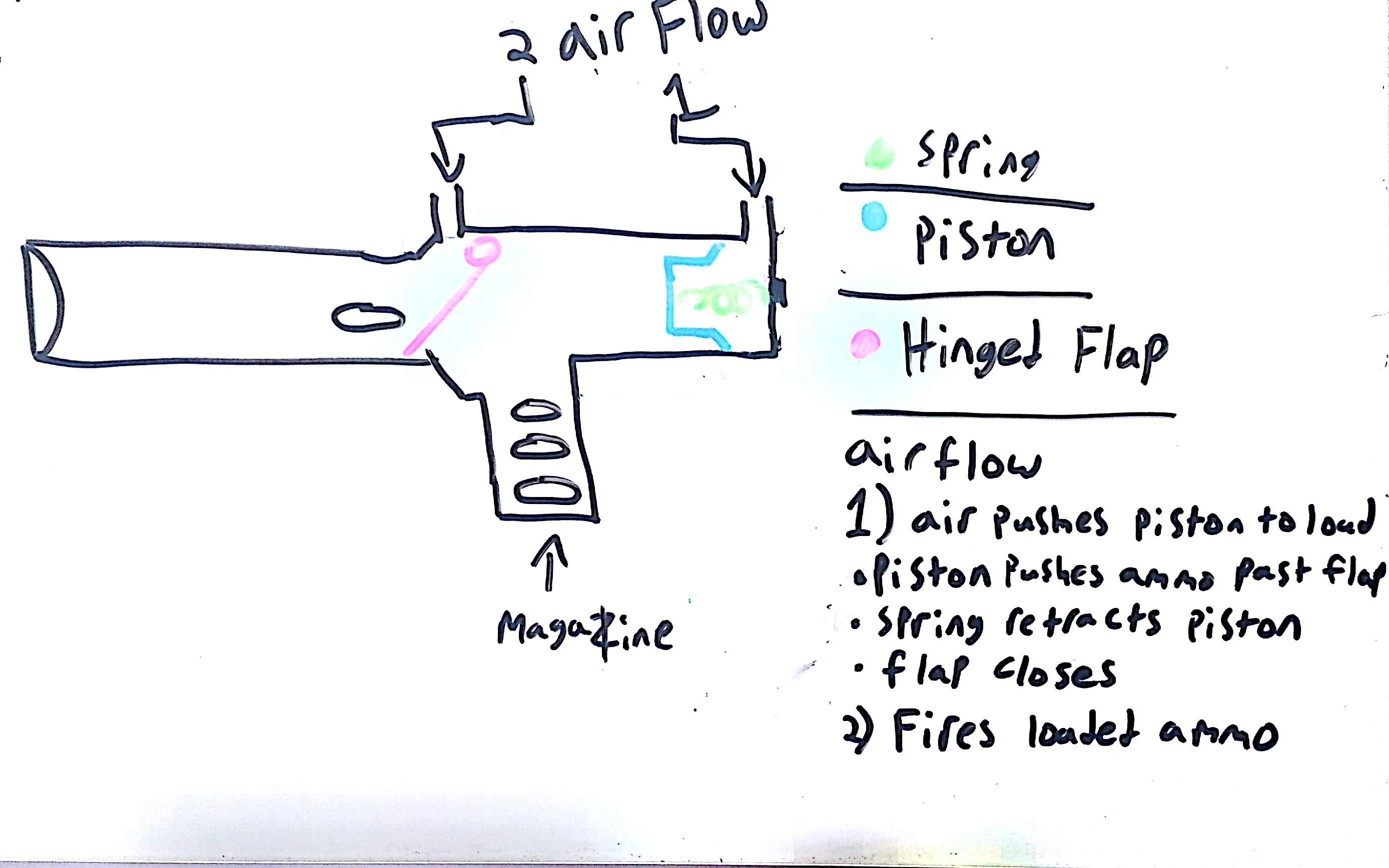

So this is my first Semi-Auto Pneumatic rifle, I have made Single Shot cannons in the past but I wanted to really reach out with this one. I had a idea for a system but I can't figure out how to do this mechanically without two triggers the first to load the ammo by air pushing a piston into the ammo from a spring loaded magazine past a hinged flap (spring loaded closed?) then a spring retracts the piston. There will probably be a magnet or divet for the loaded ammo to rest in. The Second trigger shoots the loaded ammo pushing directly on top of the hinge to make sure it stays closed. Any feedback or ideas are appreciated. Also excuse the bad handwriting an expo marker plus spending all night working on this idea mixed with horrible handwriting to start with ends up like this.
Don't you think a blow forward valve would be a better idea?
@jack The blow forward in the video double feeds at the end that worries me and the ammunition I am going to be using is CO2 cartridges cut off and weighted with lead either 1-1/2" or 2" long. And I had no idea what kind of Anything to use, this is all new to me and the idea for the drawing popped into my head, though the picture I put on the post is the third revision.
Is that what what wyz2285 did here http://www.spudfiles.com/how-to-databas ... 24574.html? It look a little different mainly the air is coming from the side hold not through the bolt.

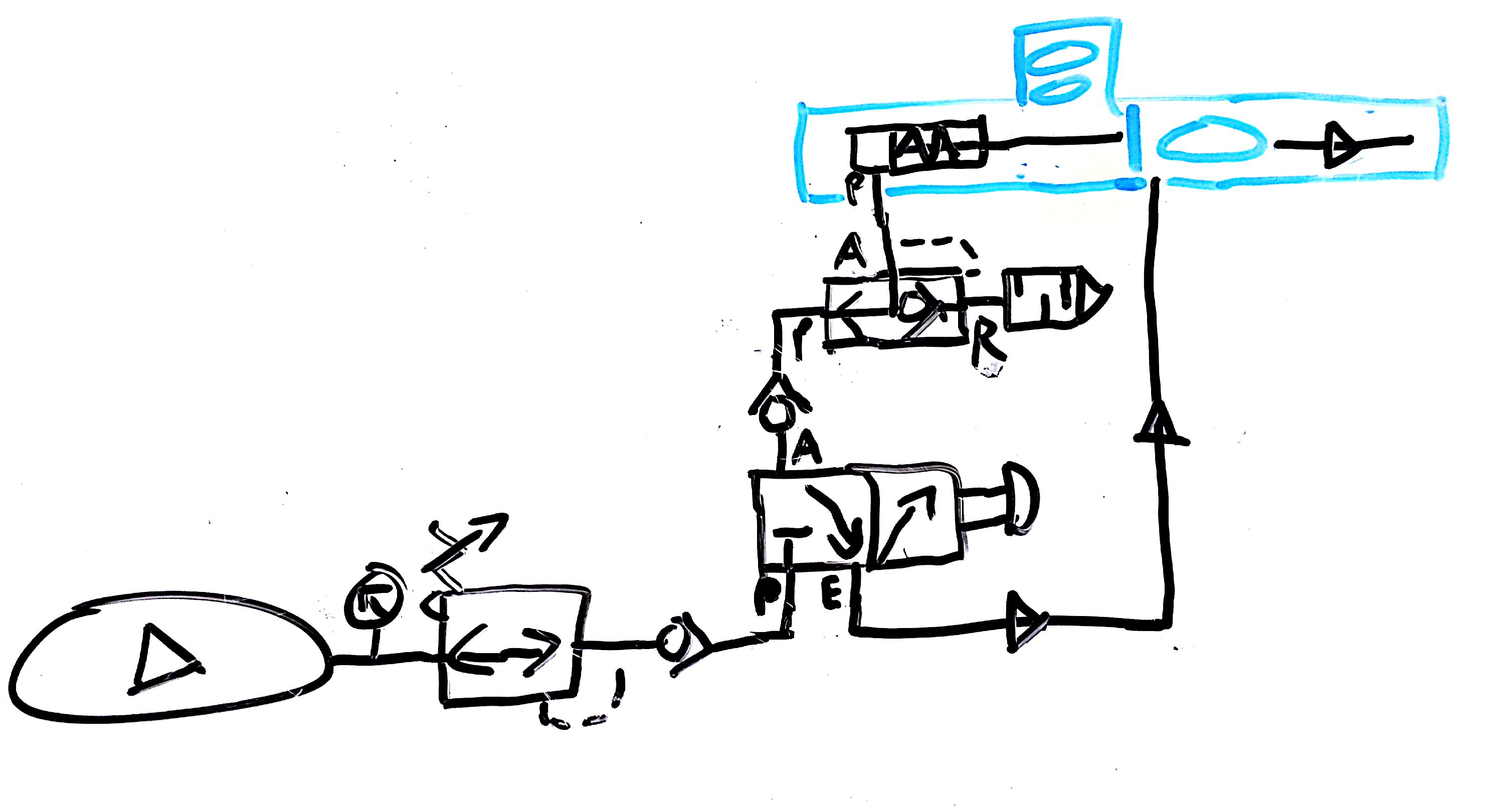

Okay so I have been reading more on the Forum and have come up with this thanks to wyz2285 for his tutorial for a .50cal semi-auto http://www.spudfiles.com/how-to-databas ... 24574.html. This time I actually used pneumatic system symbols. Oh and the magazine will be from the bottom not the top.

If this is your first project, Tetra, I'd really suggest going with a hammer valve system first. The performance/efficiency might be low, but it'll teach you a lot more about how compressed gasses function. Plus, the materials will be a lot cheaper than the QEV system.
However, if you're set on using the QEV system, I'd recommend going with JSR's 20$ QEV semi auto system.
http://www.spudfiles.com/how-to-databas ... 23626.html
If you still need the cycling bolt, just combine the blow-forward valve. Should work just fine and cycle the ammo quite well, without getting overly complex or expensive.
