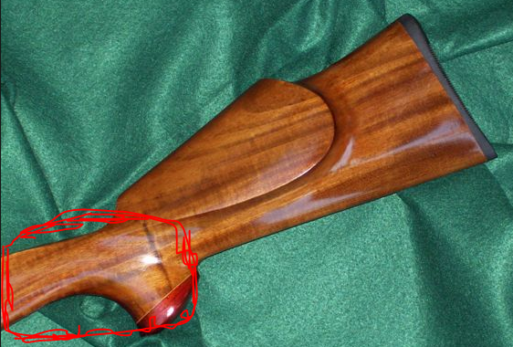

To start, you should select a wood that will be able to hold your fixtures without cracking after the shot. (i will be using bullet comparisons, so sorry to people in places where guns are banned) When selecting a wood or material, you must pick one that will not break, so if you are making a *gun where the projectile will create strong forces, such as a .30-06, you do not want to use a cracked or soft wood. pine is usually not a good choice for a *gun like that (or really any *gun because of its softness). With a recoil projectile like a .22 things become more flexible, because it is only a few lbs exerted back, not like 20 or so when compared to a .30-06. If using wood, a stock should have a grain running along the handle/grip area, if the grain is across there, it has the potential to shatter after a shot, or slight misuse.
the red shows the grain direction, how it should flow through the wrist of the gun
to get the grain pattern it is often a good idea to take a DAMP towel to the grain to check the area in question. (must also be free of large knots, they are brittle and often crack the stock later). you should then lay a pattern down to check how the grain will run through your design. (MidwayUSA chanel on youtube is a great reference for gunsmithing, though a few videos are only for those with special machinery, but can be adapted to fit your designs)Unfortunately I have a bedtime, so that is all for now.

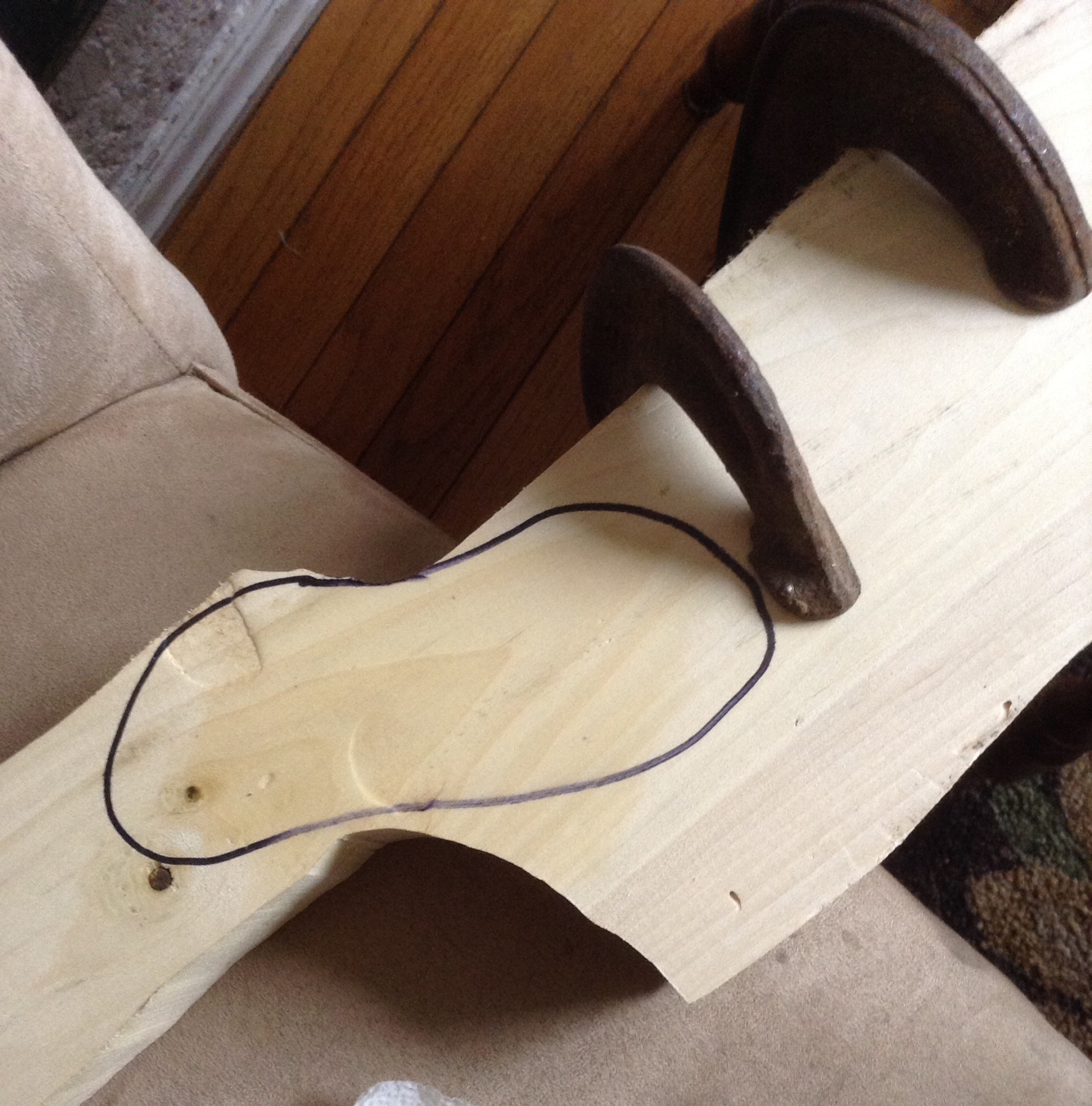

Here cammy I fixed it, it is a log now. I've also built a couple of stocks before for airsoft guns, but I broke them so I threw them away. Here is the stock I'm making with the damp paper towel on the grain to check it, sorry I couldn't really do that while it was in the vice when I started this thread, which I'm going by the process, I didn't want to do more yet because I couldn't go on my laptop. Sorry for your inconvienience.

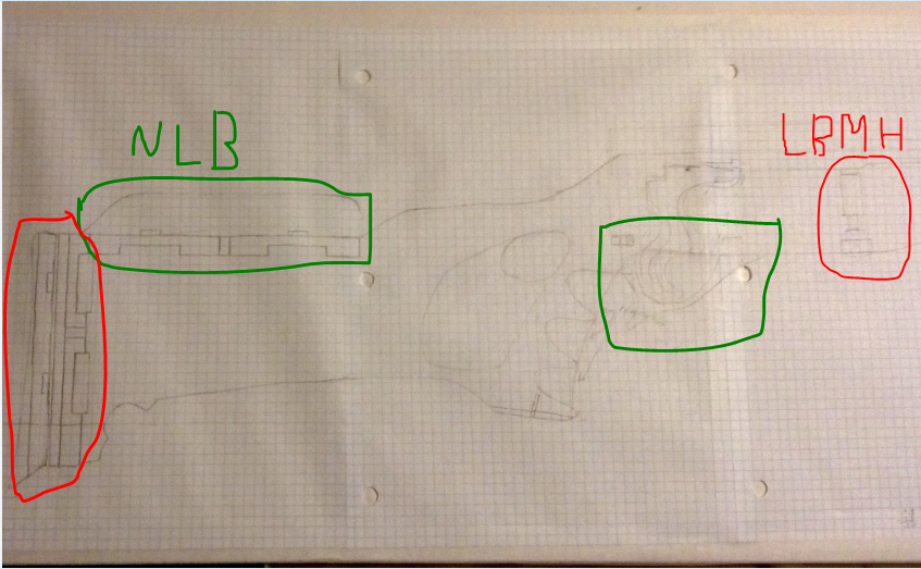

back on topic: design your stock AROUND YOUR *GUN! if you design your stock first, your gun becomes much harder and time consuming. Also borrowing ideas from other guns will help you create your own style,my style leans toward the l-96 with a thumb hole. When i started to design my gun i got graph paper out and got to work, the reason I say graph paper is that it is helpful for drawing lines and getting a size estimate without getting rulers and such. When drafting your stock, lay out the important parts you are going to use, like triggers mech (can be designed and made while drafting), barrel, chamber and holding fixtures. air guns have many more parts, but not all are applicable to every build. and remember the only one who needs to understand your design are the people working on it(depending on what you can accomplish on your own).
DRAFTING REQUIRES:
A Ruler/measuring stick
A pencil
paper for plans
Your mostly assembled gun
problem solving and imagination

Make sure you know what you want to make your stock from first, and also make sure you leave enough material to hold the force, exerted from the anchor points in your design. and one last thing, while drafting, log your moving parts, look at the trigger, I designed it to have a hollow for the trigger to move freely and it is designed based on my ability to work wood.

the next thing i like to do after drafting is to create a pattern that is good to lay out on the wood. I like a paper one because i can cut through the paper, so i can leave an edge away from the line that is 1/4" to 3/8" from the pencil lines. This is important if using a saw that may cut not exactly 90 degrees or distort in the wood blank, like a band saw, handsaw without a jig, or other things like it.
To make my stock, I laminated two pieces of poplar together to make my desired thickness. to determine the desired thickness for your wood blank, first you must determine how it will be put together. If pieces are going to be made separate from the stock, such as my cheek rest is (I left a space in the form of an aluminum plate) make sure you draft in cutting space, and spaces for mounting that do not compromise the stock's integrity. To avoid compromising the stock, you can add pieces of metal and epoxy to the area that needs to be strengthened (drafting it in is a good idea), again, midway usa has a video on it that is better than any video I can currently make. A good rule to keep yourself safe for wood is to make the spots for mounting away from knots or other imperfections and wider than you think they need to be, like 1/4" (1/2" before shaping) wider on a non load bearing area, like the fore-end of the stock(the part of stock in front of mounting pieces)
non  load bearing, load bearing mounting hardware
and for the load bearing parts should have a lot of material around them, like at least 1/2" (3/4" before shaping) on each side of the mounting pieces and should be as reinforced as much as possible to prevent breakage, both of my mounting hardware will have at least 3/4 an inch on each side after finished.
When laminating two pieces of wood together, it is good to have a lot of clamps, like 1 for each 4 inch area, so if you are making a stock like mine, you should, have a clamp every four inches down, and towards the back of the stock there should be clamps to the middle of the stock. to prepare the wood, make sure the surfaces are clean for gluing, if they are not clean and do not have a good bonding face it will create weak areas. Another good rule, have enough glue to seep out the edges when tightly clamped. the whole are must be evenly coated to prevent air bubbles, i coat both sides with a visible layer of glue that I rubbed into the wood using Clean rubber gloves. the glue and bonding surfaces should remain unhandled by hands, which could spread oils. after the gluing, make sure there is alot of pressure, holding the stock together, the end result is a thin, almost disappearing glue line.
