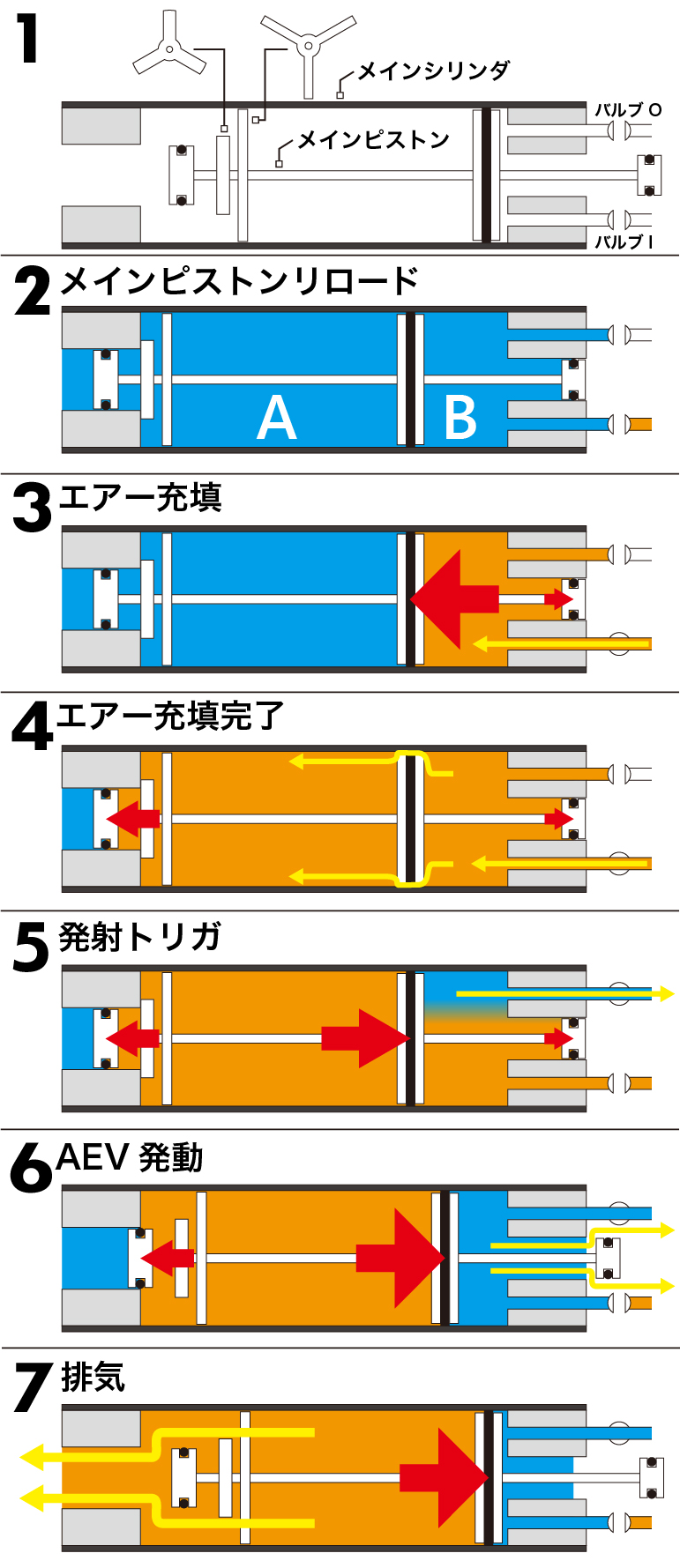

The concept of this Exhaust Cannon Mk.11 is to realize both semi-automatic firing and high speed valve opening for intense shock wave.The direction control valve is pretty good tool for realizing the semi-automatic cannon. However, the flow rate that can handle by DCV is a little small, and therefore I adopted the special valve system that can handle larger flow rate to Mk.11, and we call this valve AEV(Augmented Exhaust Valve). I think that this AEV system has already discussed in this forum as another name, anyway I introduce the principle.
You will understand the working principle of the AEV from this figure. This AEV's advantage is its high flow rate of exhaust at the back-end. As you can see at the figure of 6(AEV発動), the compressed air behind the biggest piston through the back end port, and it is rapidly exhausted. The fast exhaust of compressed air behind the main piston is the most important in terms of making the acceleration of piston unit larger.
I believe that the DCV is the best method to add the function of semi-automatic to pneumatic cannons, but it is only for the cannons that have small volume behind the main piston. And when we design the cannons with large volume behind the main piston, we have to adopt the another valve system which have large flow rate like AEV.

I love the quality of the drawing you posted above as well - looks like a very well designed and thought-out iteration of a Toolie valve - http://www.spudfiles.com/spud_wiki/inde ... ston_Valve
As Gipetto mentioned - your pilot venting method is ingenious as well - it incorporates some of the best aspects of the piston valved hybrids we have on this sight!

The principle is coequal, but the configuration is different a little bit. The biggest difference is the existence of acceleration interval of piston which seals nozzle. By providing this acceleration interval, we can accelerate the piston unit until the nozzle is opened, and it results in an intense initial rise of firing. In addition, this method is adoptable for all types of pneumatic cannons, and in particular, it is compatible with AEV system. By using this AEV mechanism, we can fabricate intense cannons relatively easily regardless of its size. And the acceleration system will also improve the action of hybrid cannon (It will maybe cause collapse of piston…).
However, when I tried to add semi-automatic action to cannon with AEV, I could not find the essential and elegant principle. So as a ad hoc solution, I added the pneumatic cylinder behind the AEV's rear piston to push it back to the chamber. But now, I found and developed the elegant principle that can realize not only semi and also full-automatic action with no electric devices last year! So, I'm planning to introduce them later.
