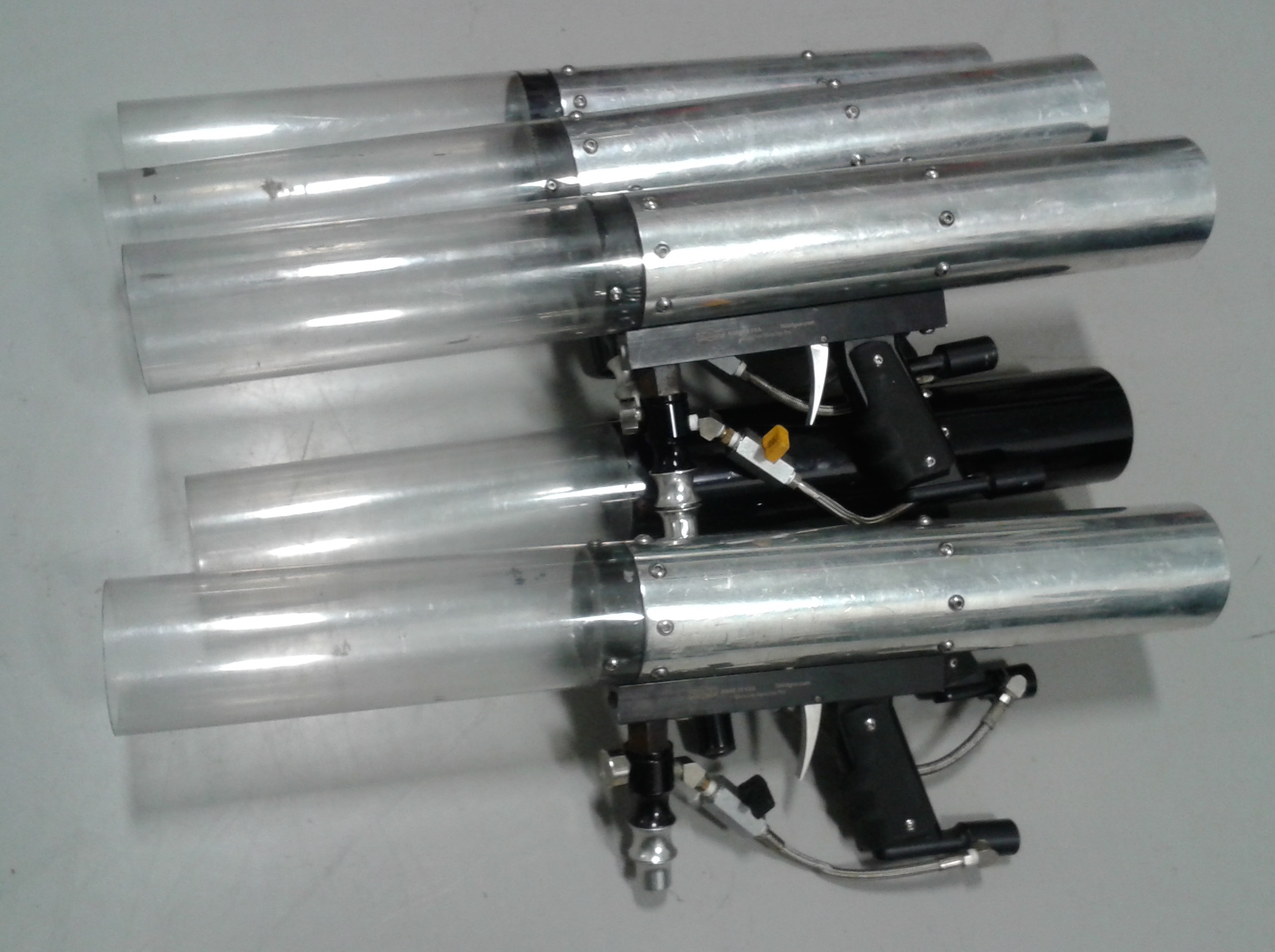

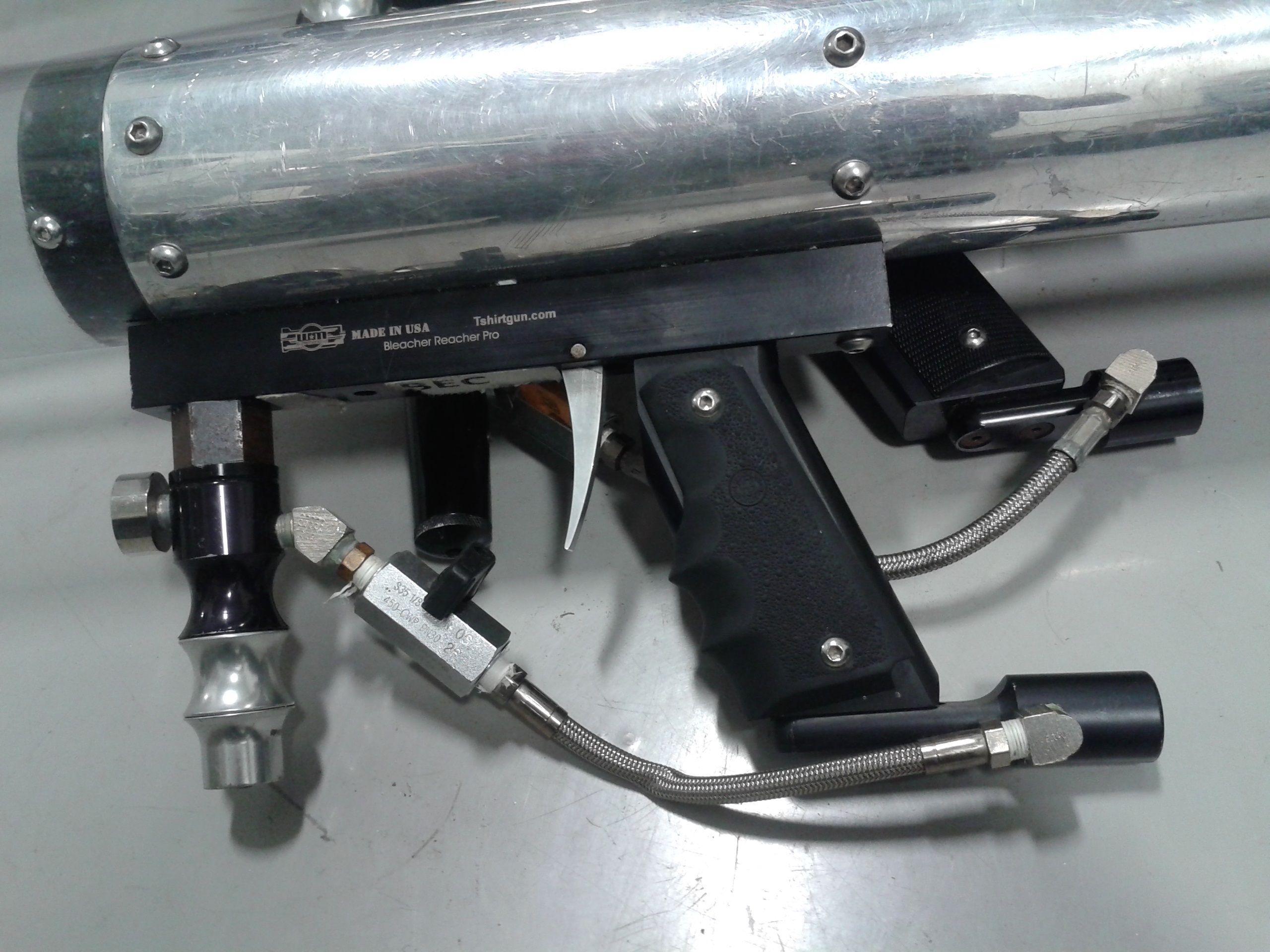

I had a bunch of
these to service and though I'd share a look inside:

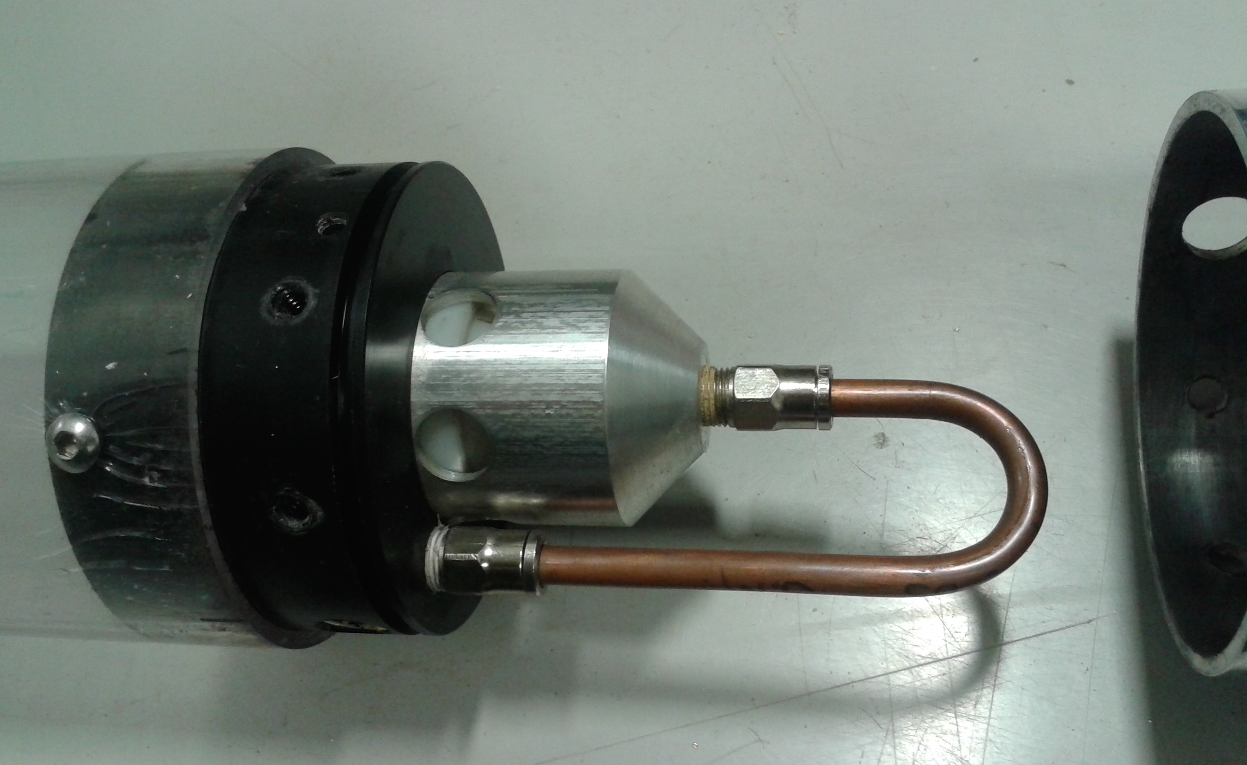

Standard exhaust valve setup but with an interesting configuration that has the piston seal at the front endcap but avoids using a spool or "toolie" type valve. There's no rubber seal on the piston face, it's aluminum on delrin, and it has a floating o-ring to allow air to be filled from the main tank but not to flow back when the pilot is actuated.
Operating in the 300-500 psi range, these things are pretty darn loud!
Also did I mention my workshop has an epoxy floor

Aluminum piston? Maybe there is a dashpot/air cushion effect preventing a hard slam. That's interesting. And a metal to metal seal. That's also interesting. Those are two things I would never consider to try, yet they work.
Re: A look inside the "bleacher reacher" t-shirt launcher
Posted: Mon Sep 16, 2019 9:23 am
by jackssmirkingrevenge
There's no real design for cushioning the impact, it seems to me that it simply travels a short distance that isn't sufficient to cause any damage.
The piston seats against delrin, the while component in
this image. At these pressures I don't think metal on metal would work.
