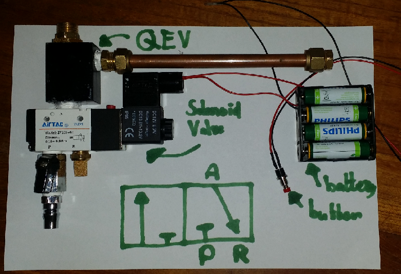

After using a spring return 3-way-2-position valve for a while to pilot my QEV, I decided to order a solenoid valve. It came in yesterday and I immediately tried to install it. It was my first time messing around with wires and all..... but I'm pretty sure I installed it correctly. I run a simple QEV with chamber and as mentioned previously a solenoid valve setup, this is shown below:
Now here is the problem:
When I attach the air supply to port R, I hear a light sissing noise which indicates there is some kind of leakage. Then when I press the button to power the valve, I hear the coil doing its job but it does not switch ports. I suspect that is has something to do with pressure difference.
I was pretty sure that I had to attach the air supply to port R. To make sure I wasn't doing it wrong I attached the air supply to port P to test it. At port P, I still hear a light sissing noise. But now when the button is pressed you hear the chamber of the QEV filling up (which makes sense when you look at the schematics). Then when i release the button, air is released from port R and the QEV pops. Of course this is the desired effect but that would mean that i constantly have to power the solenoid. and it still doesn't solve the problem for the leakage at the valve.
I have no idea what i am doing wrong, but i think it has something to do with the lack of pressure at the ''unused'' port.
I hope someone has encountered the same problem before and that he/she can help me!!!
With kind regards,
BramR, The Netherlands :mrgreen: :mrgreen:

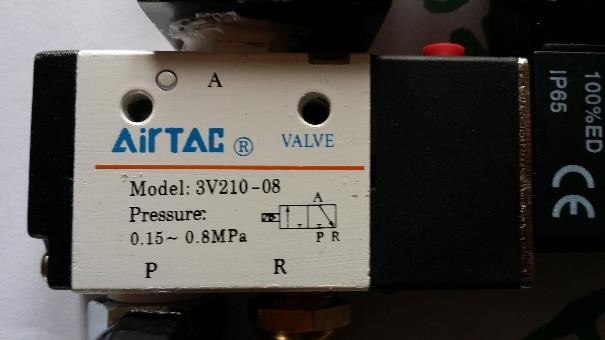

Here is a picture from closer by.
matti
Finland
Posts: 252
Joined: Tue Oct 04, 2005 1:01 pm
BramR wrote:Here is a picture from closer by.
The attachment solenoid.jpg is no longer available
Yeap, thats a pilot operated valve. So to use it you need a constant pressure at port P. Thats the same reason the valve says 0.15-0.8MPa pressure and not 0-0.8MPA :D

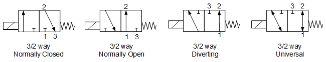

Heres a valve diagram to show the difference of NO and NC valve in their diagrams: http://solenoidvalveshop.co.uk/img/arti ... nction.gif

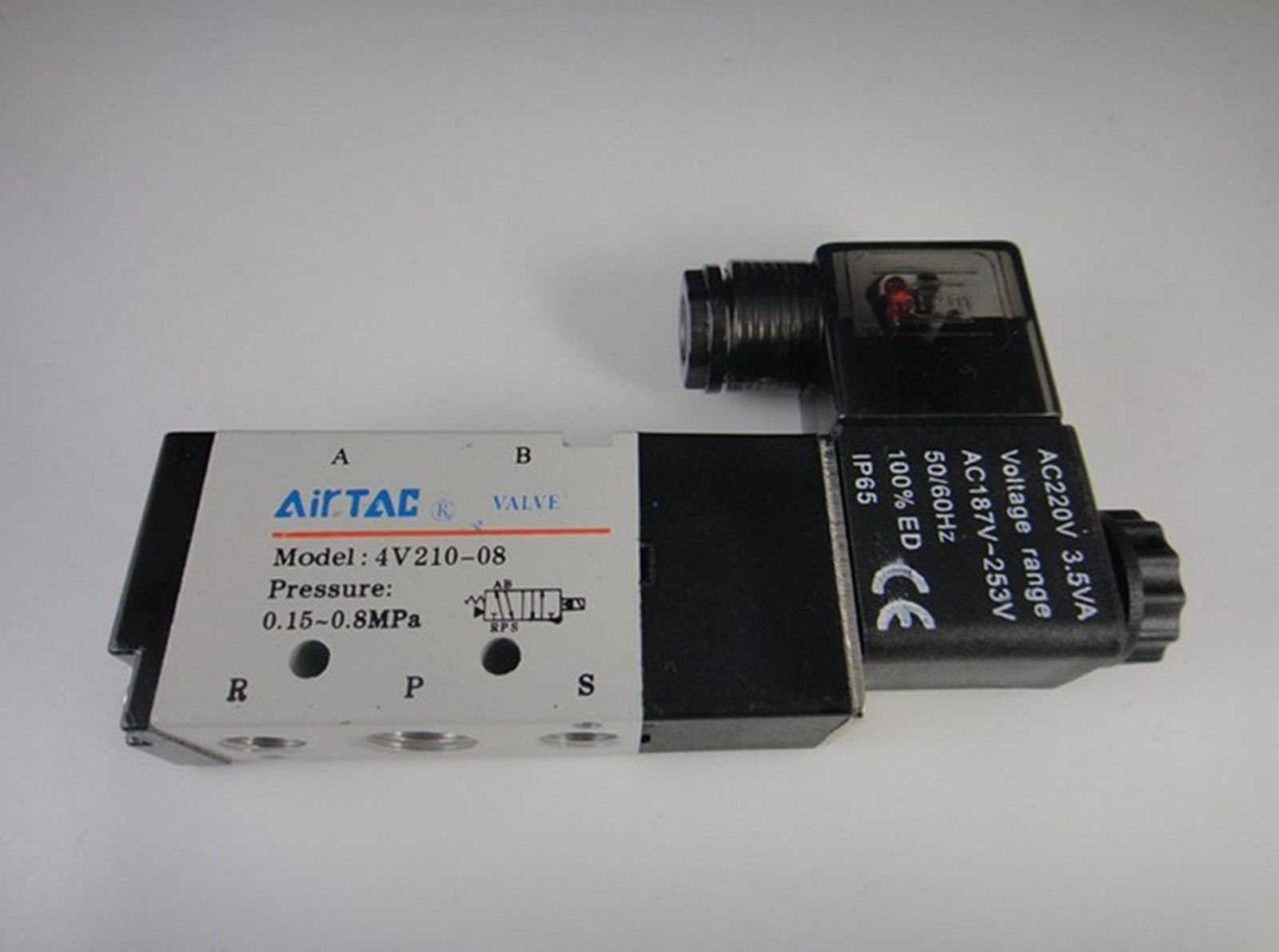

When i buy this 5/2 solenoid valve, i basically cant do it wrong as long as i seal one of the ports so the air supply wont leak out?
http://www.ebay.com/itm/1x-4V210-08-5Po ... ilOZYWy1rg
Its an 5/2 solenoid because for some reason it is cheaper than a 3/2 only 8,55 dollars:D
