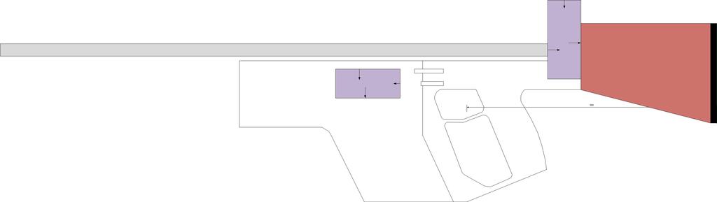

Anybody got any ideas on a fully pneumatic powered semi automatic bolt action set up.
I'm thinking pulling the trigger switches a pilot valve to send air down the barrel, pulling the trigger fully in, shuts of that air and triggers the reload cylinder ( bolt action ) so a secondary actuater on the trigger.

by farcticox1
Worked on the circuit a bit, going to get some parts and make a test set up of this.
Pulling trigger should operate main valve then operate the control valve after a short time set by restrictor, which shuts off main valve and opens breach to load 1 ball. Releasing trigger should reset valves ready to fire again.
On initial loading, before firing, 1st round can be loaded manually as breach cylinder is spring return, just like a real gun.

by farcticox1
Made the skeleton for the grip and trigger mechanism

Re: Semi automatic ideas?
Posted: Wed Jun 29, 2016 5:35 pm
by farcticox1
Just playing with layout, this looks interesting, the stock will be the main chamber. So what is a good chamber/barrel volume?
I have read 4:1, I should be able to achieve that easily.
