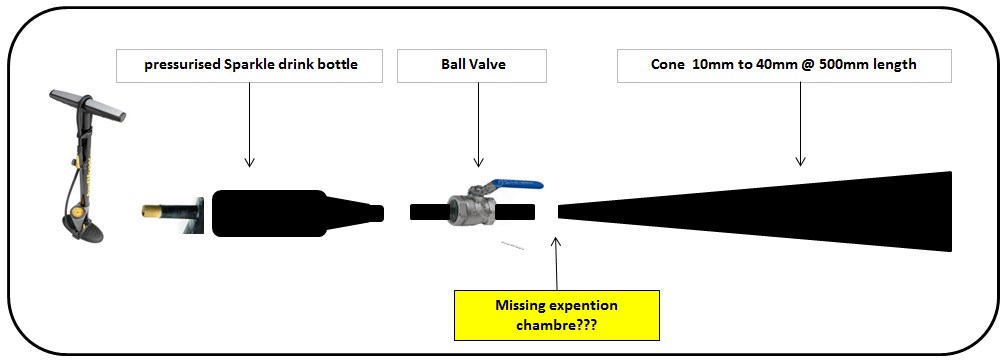

Somehow I noticed a video about the vortex cannon and I decided that I have to try it out and build a prototype. Thought it's going to be simple job...
I tryed this configuration:
Basic configuration - not working
all I got was a PUFFFF :cry: :(

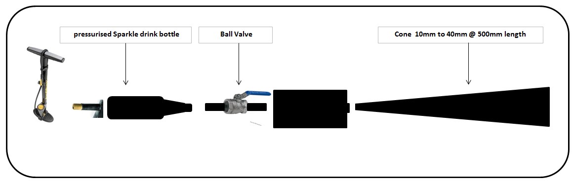

I am not sure but maybe I have to add some chabmre to create the vortex ring
probebly kind of this configuration:
Any Idea what was wrong with the basic configuration ?

I'm pretty sure you have too large chamber for that size nozzle.. you might also want to upgrade to QEV (quick exhaust valve), like the other one that Jack linked.. actually the smaller cannon linked is quite exactly what you probably want..

As I understand my problem is the slow response of the manual ball valve.
Therefore I tried today to correct it by emulating quick response even with Ball valve.
I have attached piece of balloon to the outlet of the ball valve. Now when I opened the valve, I got a Bang.. but I did not get any air ring.
Tomorrow I will try it without the chamber that was added few days ago.

faster valve and smaller chamber is the way to go.. Not my fist time building vortex cannon...

As for the suggestions raised by Matti & Jackssmirkingrevenge:
1. Since all I wanted is to build a prototype just for fun. I thought it will be an easy job. Anyway thank you for your ideas; I will try to implement them.
2. Faster Valve – I believe the idea of stretching a piece of balloon on the outlet pipe of the Ball Vale could emulate the response of QEV. Tried it once, when the ball valve was nearly fully open, I heard the blasting sound of this piece of balloon. Of course I have to dismantle this piece of pipe each time and stretch a new piece of balloon over it…
3. Smaller Chamber – My drawing was just for illustration, I used a piece of 2" PVC pipe at about 200 mm Length. I believe I should make it shorter, maybe 100 mm.
4. I can see that the cone that you have used has bigger slope than the one I used, maybe I will change mine.
5. I tried to find some designs with dimensions of a simple Vortex canon. Is there any database with simple designs and dimentions?
