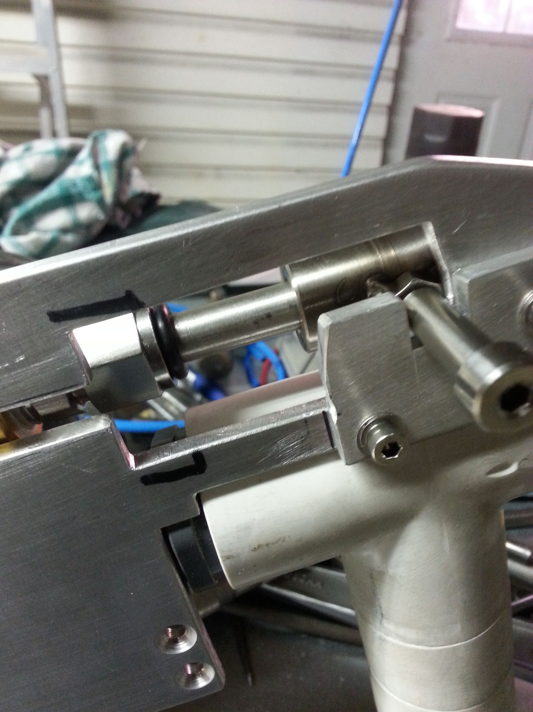

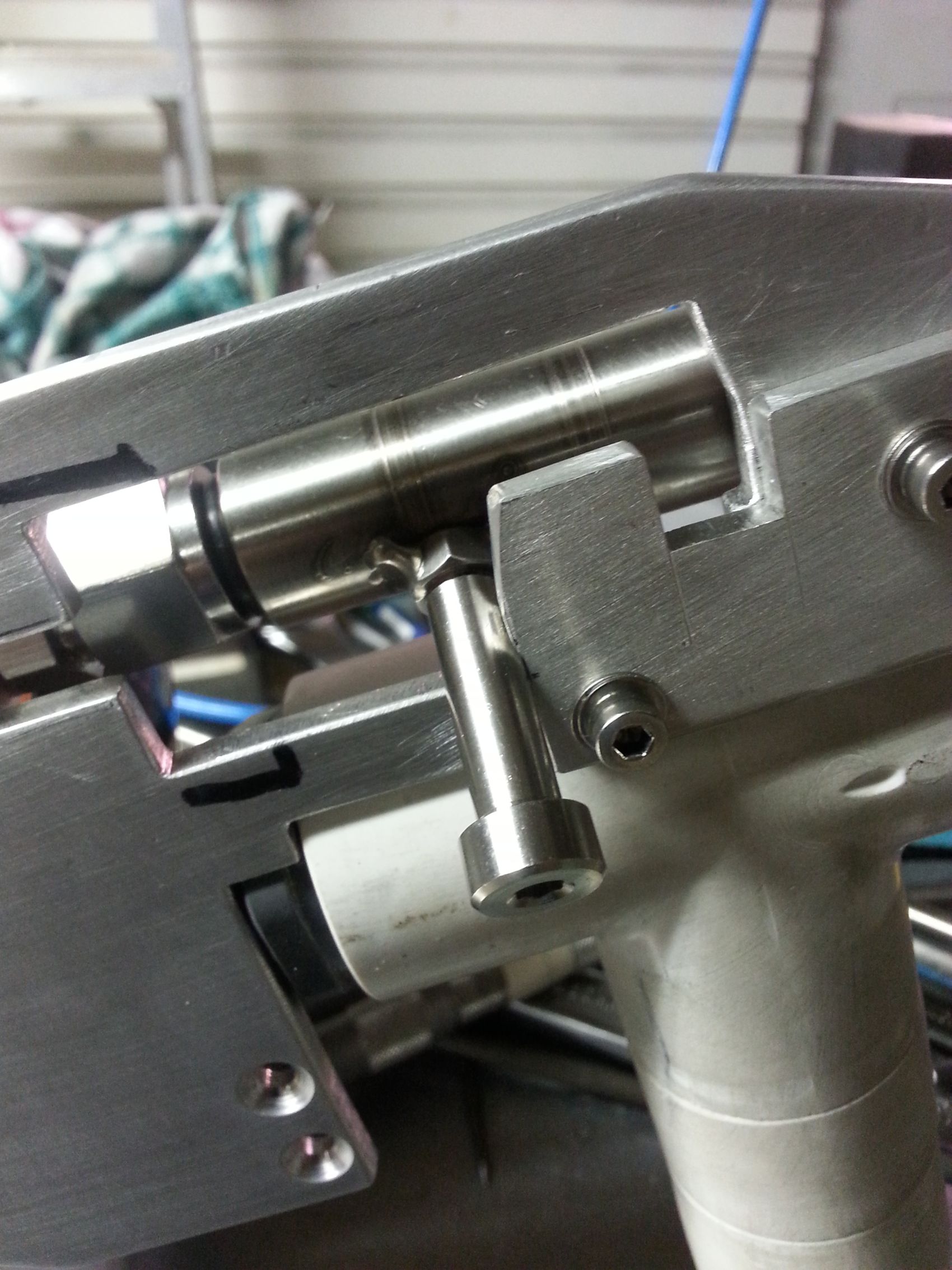

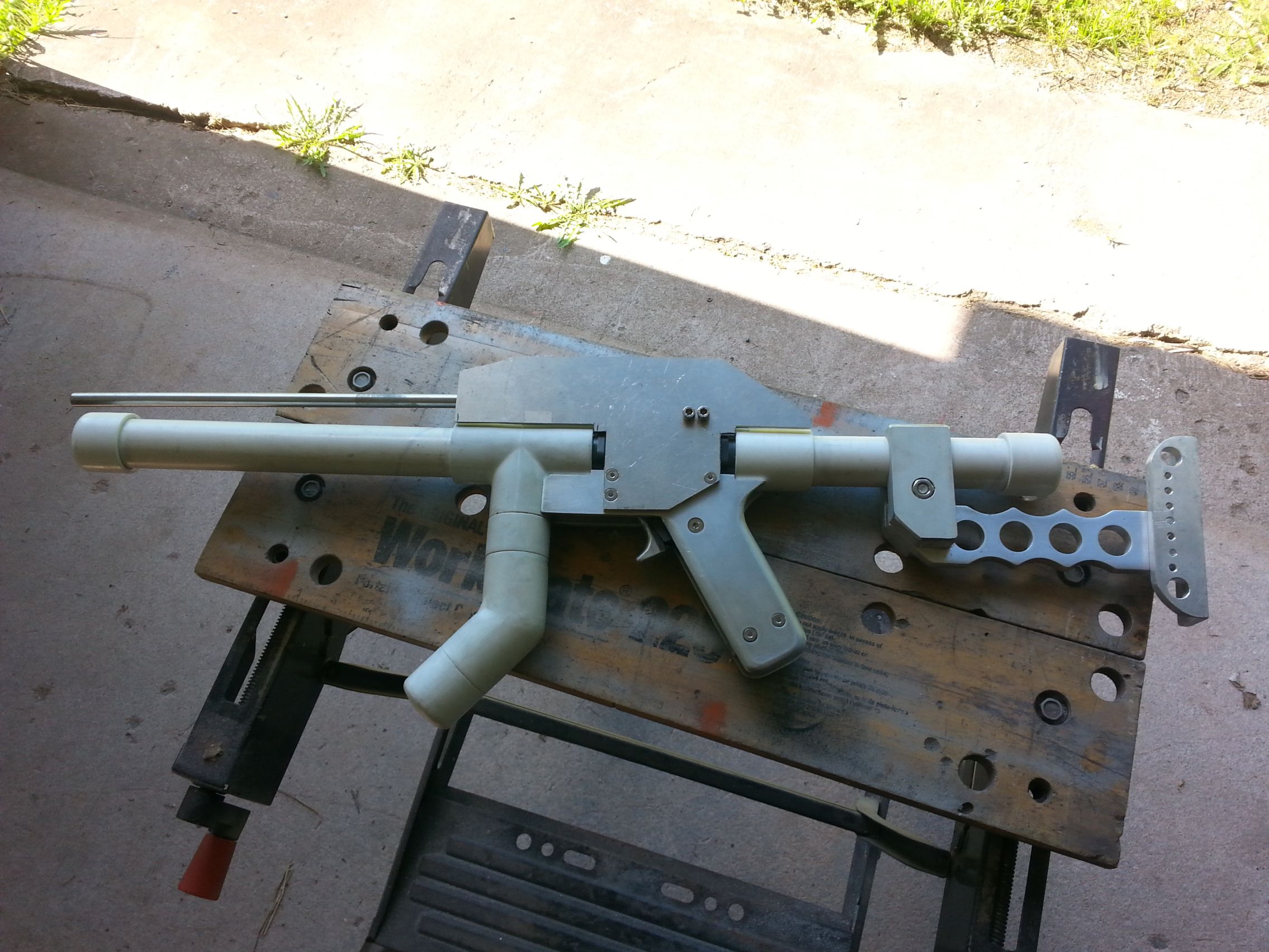

As usual I had a change of plan, ditched the burst fire, going for single shot, as I originally intended. Found a sweet piece of pre-drilled 20mm round bar which I opened up to 10mm ID in the drill press, (oh for a lathe)

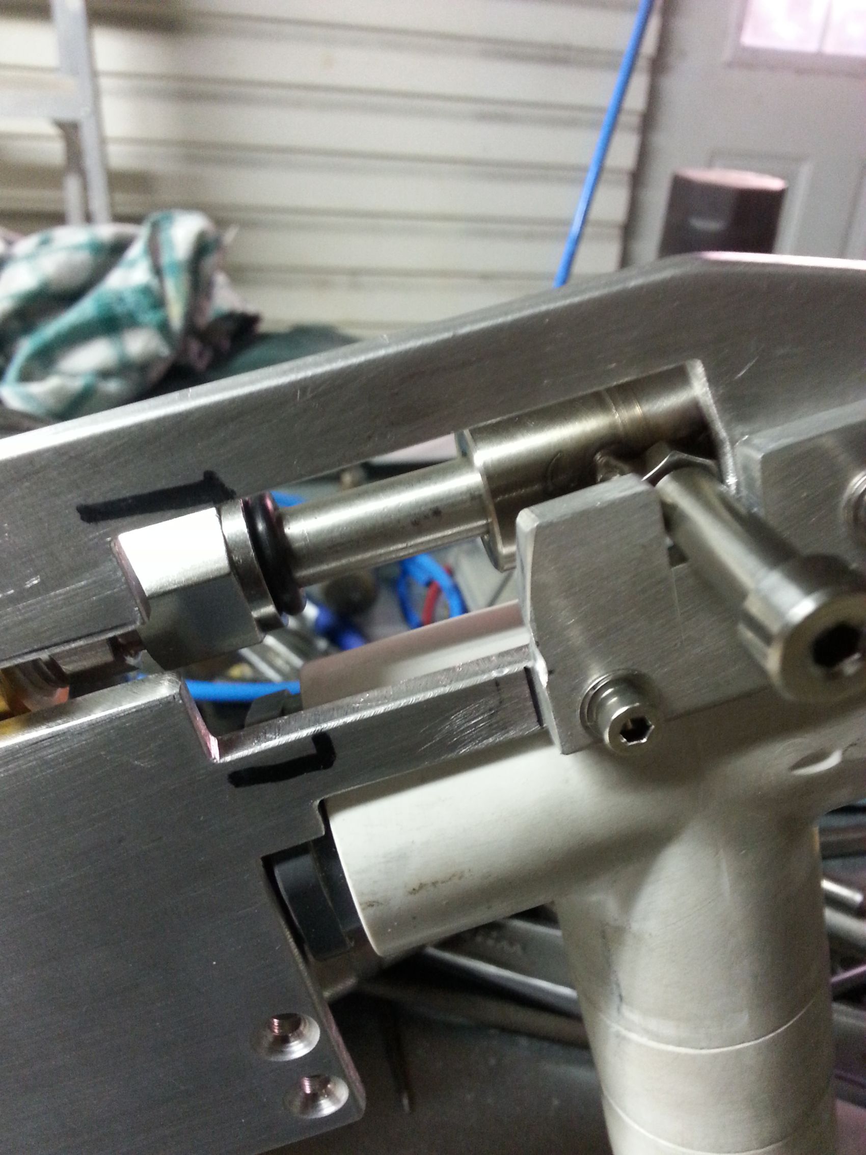

Bolt open (no hole in barrel yet)
Closed, locking ramp puts pressure on O ring as I want the barrel hole close to the end, the plate fixing bolts are in slots so I can adjust the pressure on the Oring

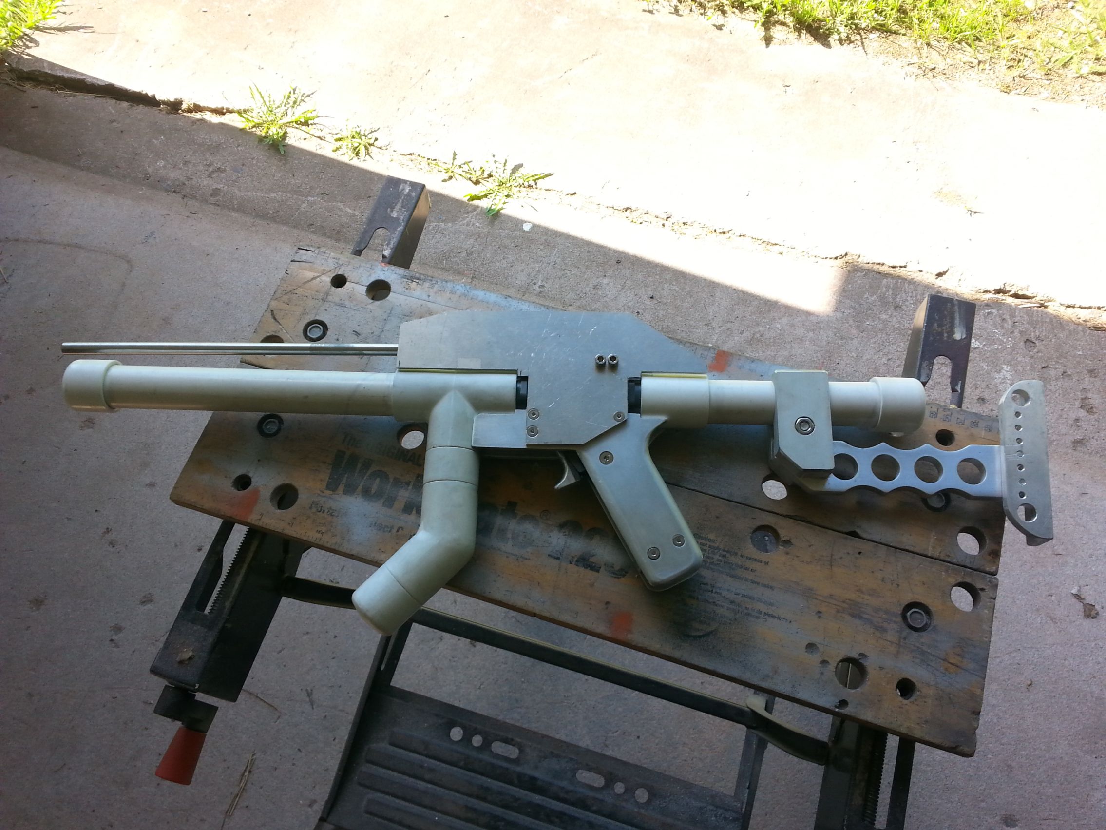

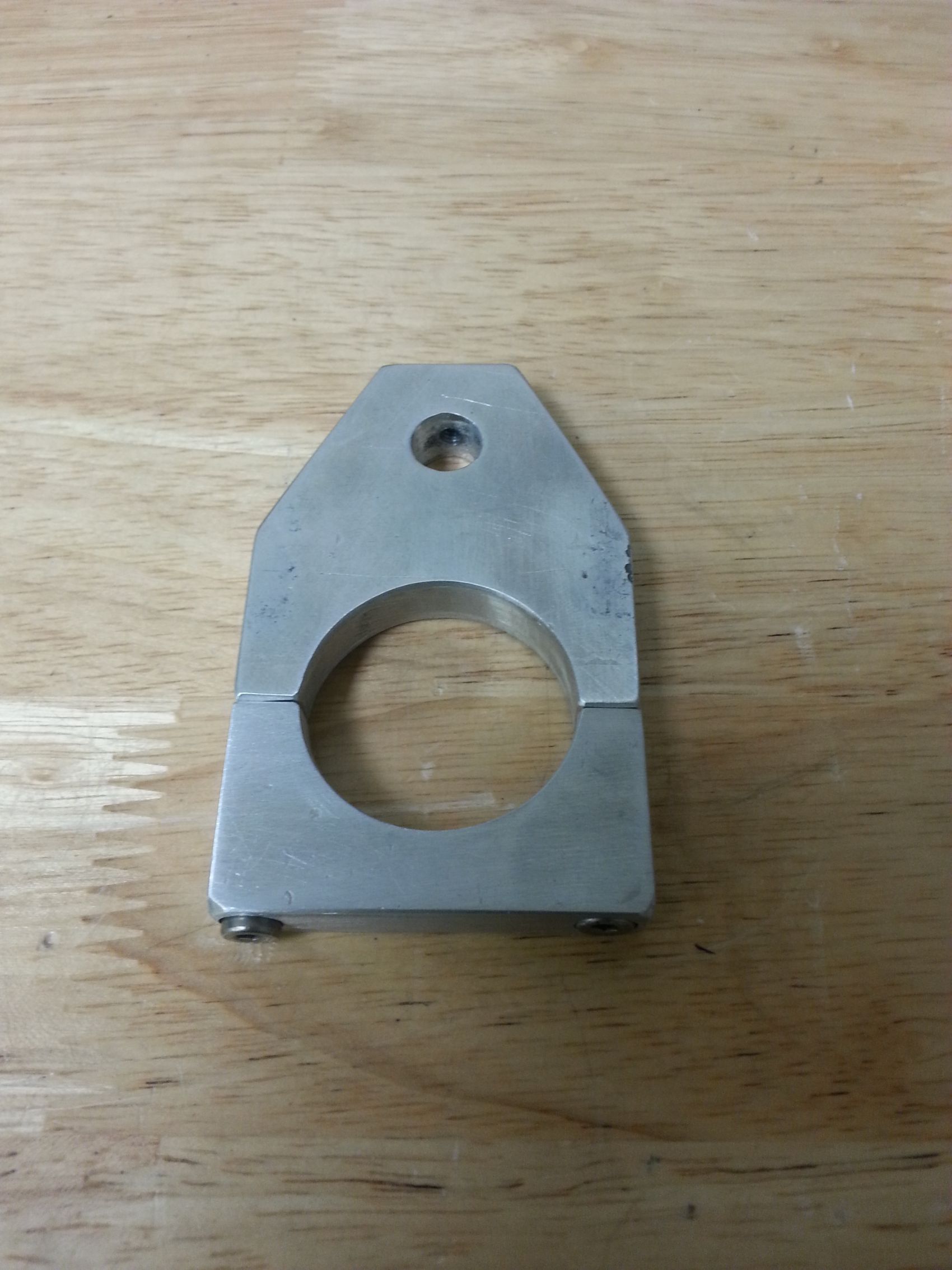

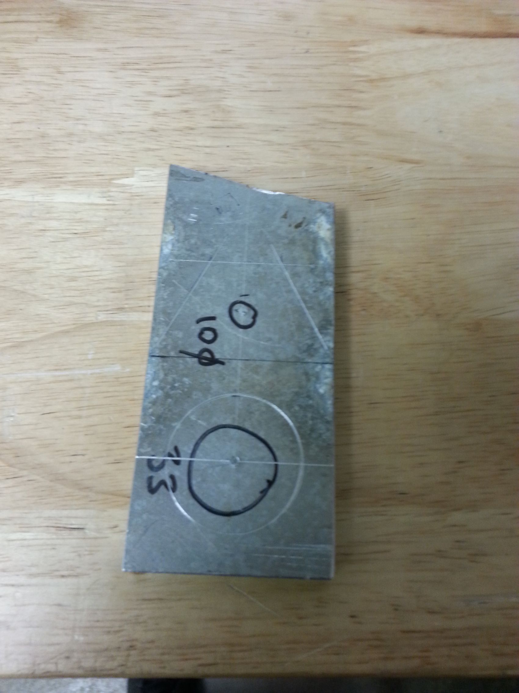

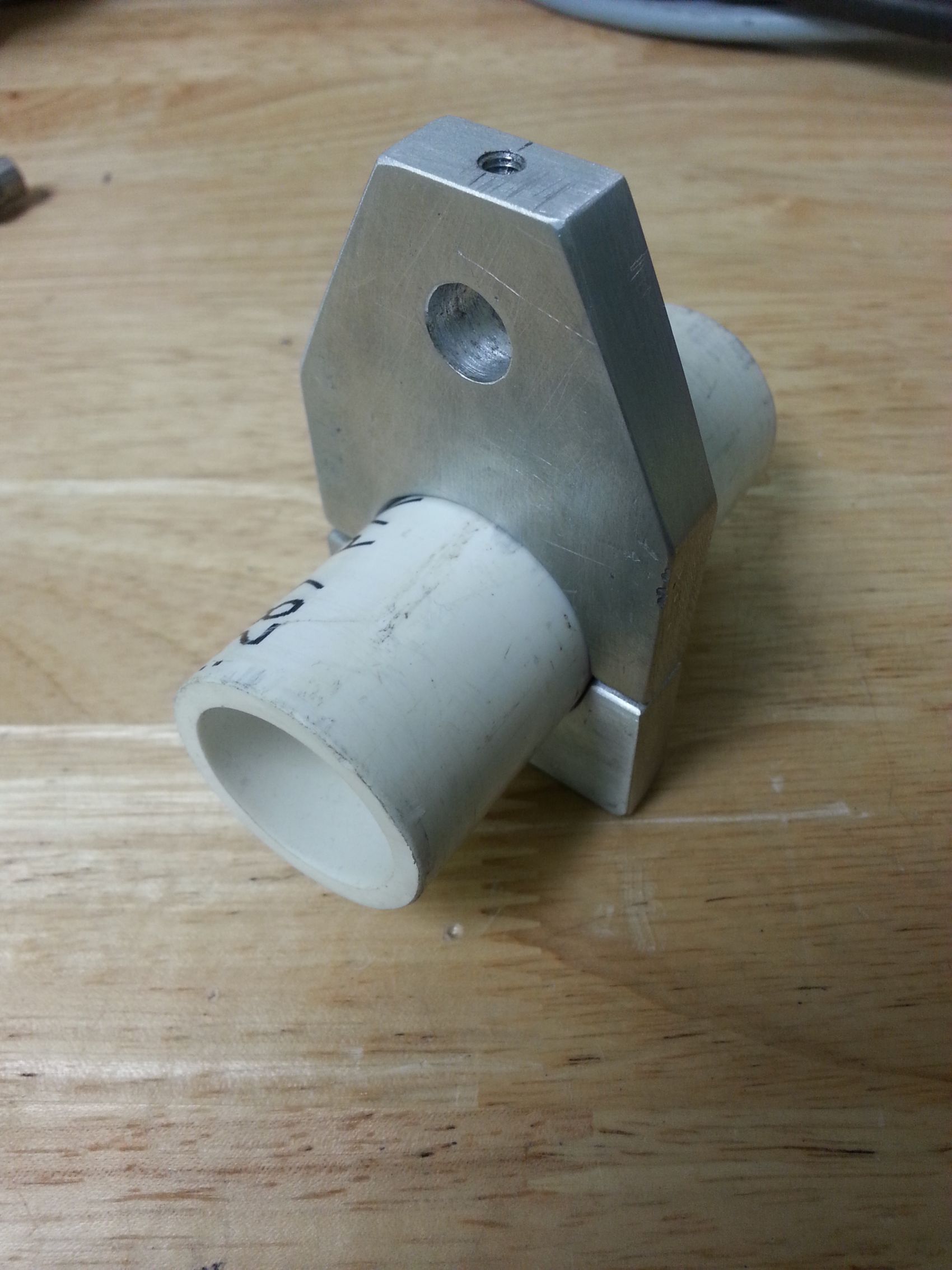

Made a clamp today for the front section of the gun to secure the barrel to the pvc chamber
M4 thread on top for front sightpost

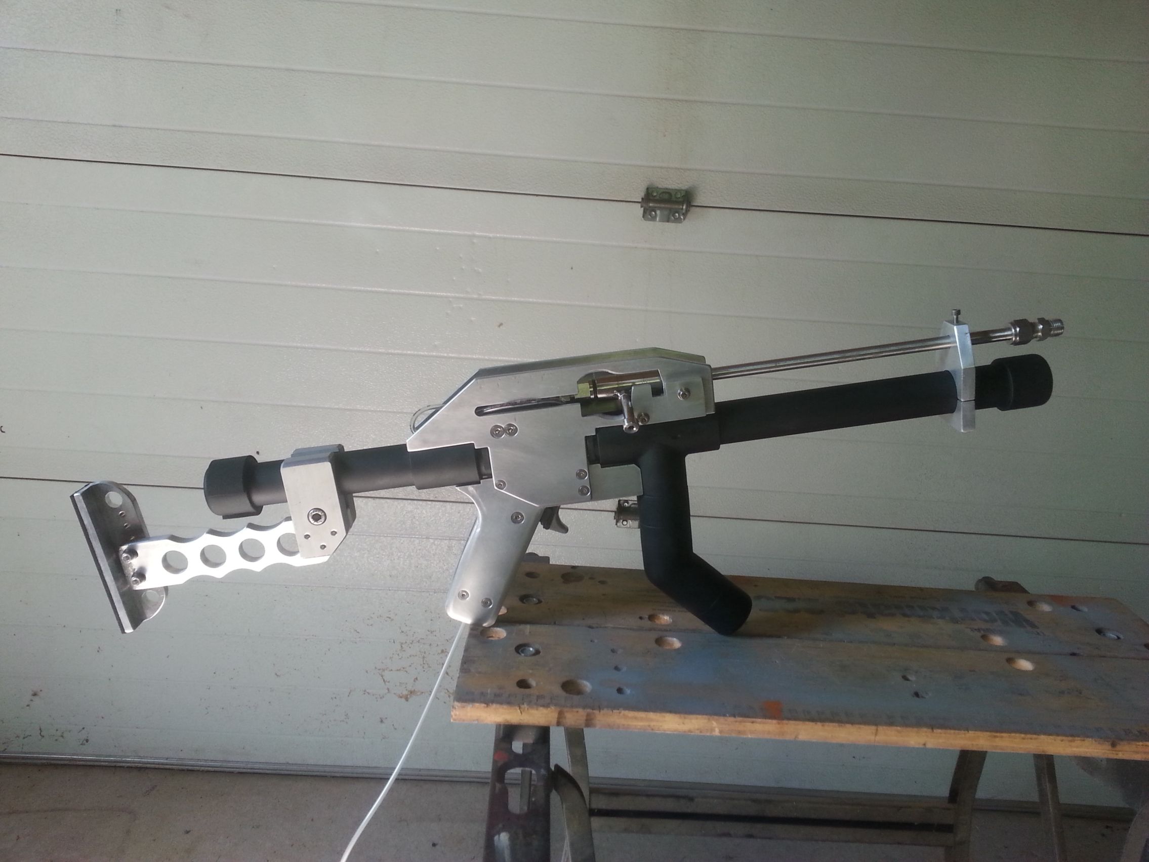

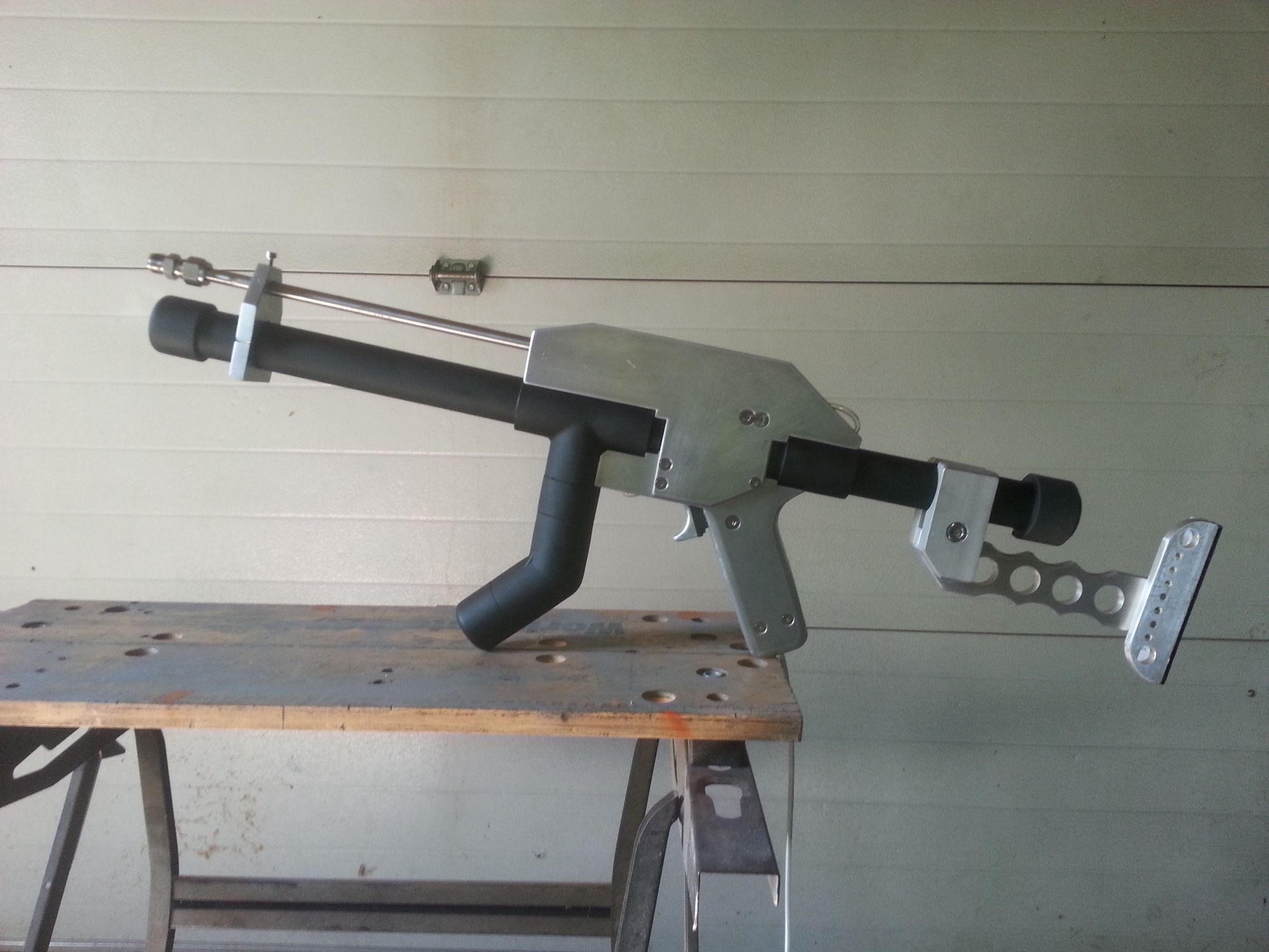

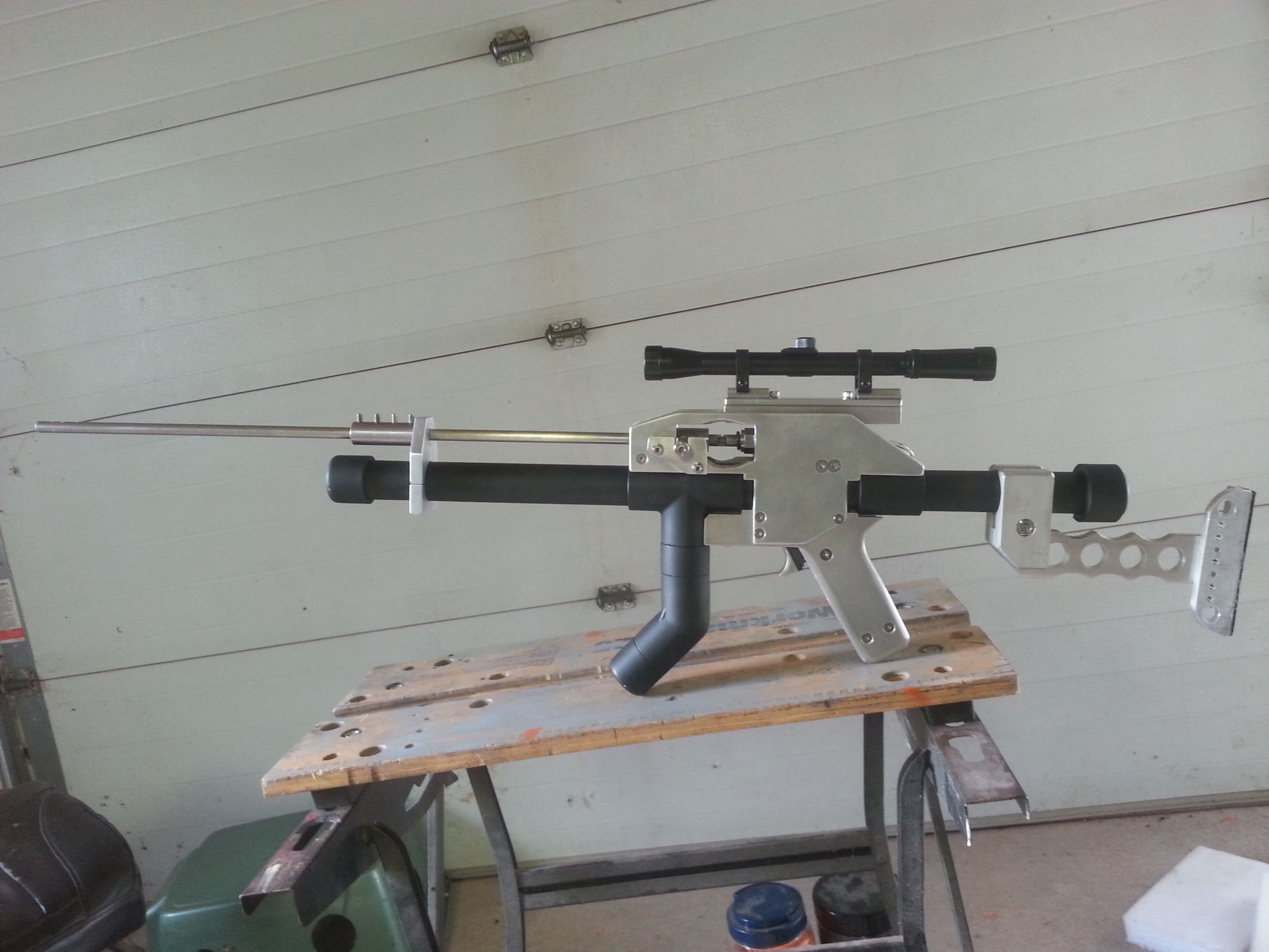

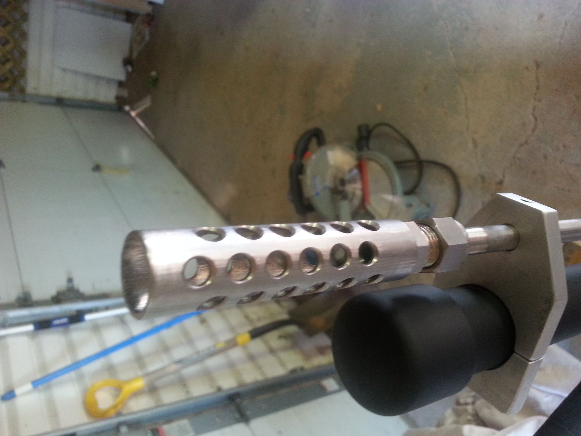

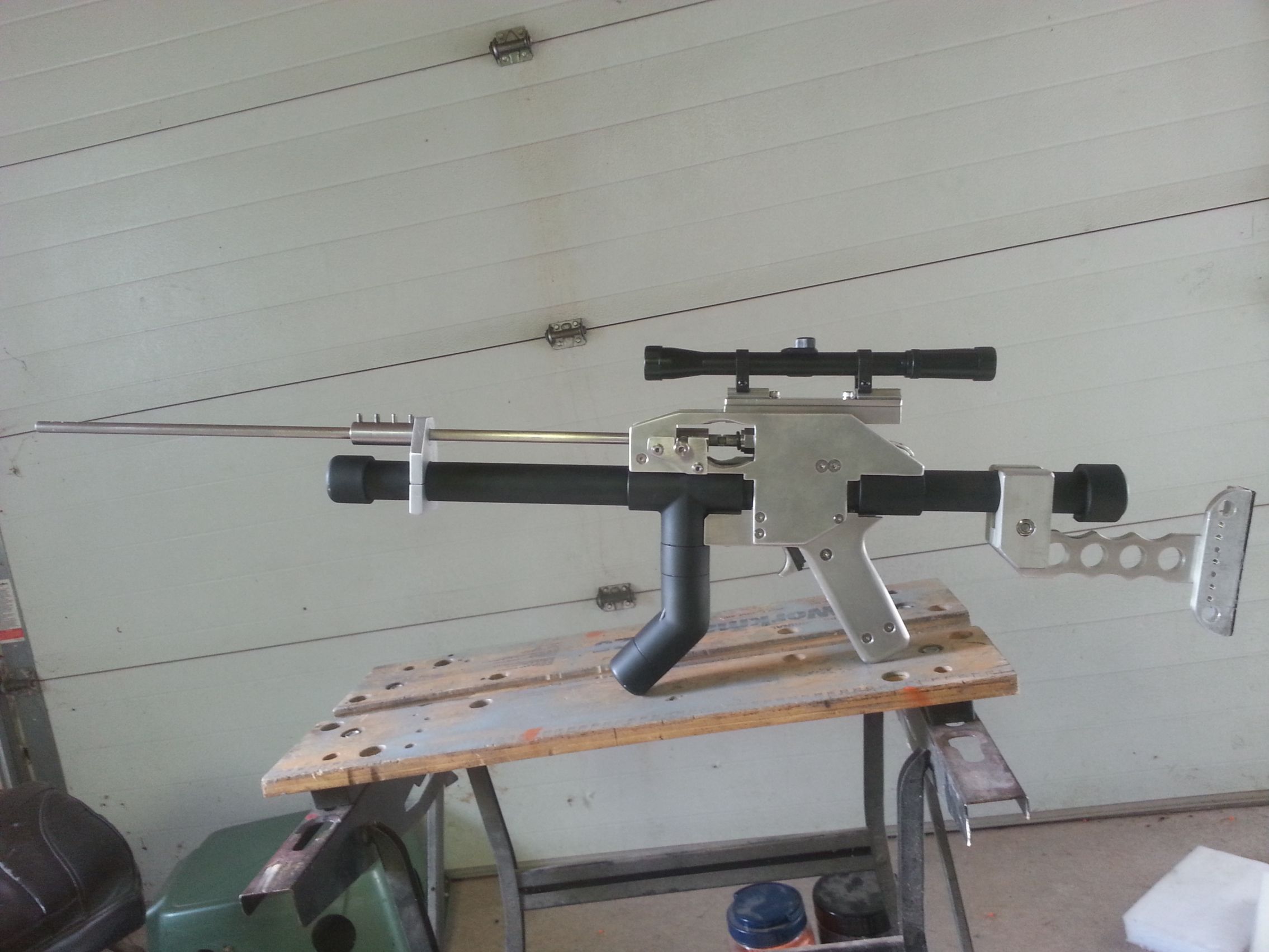

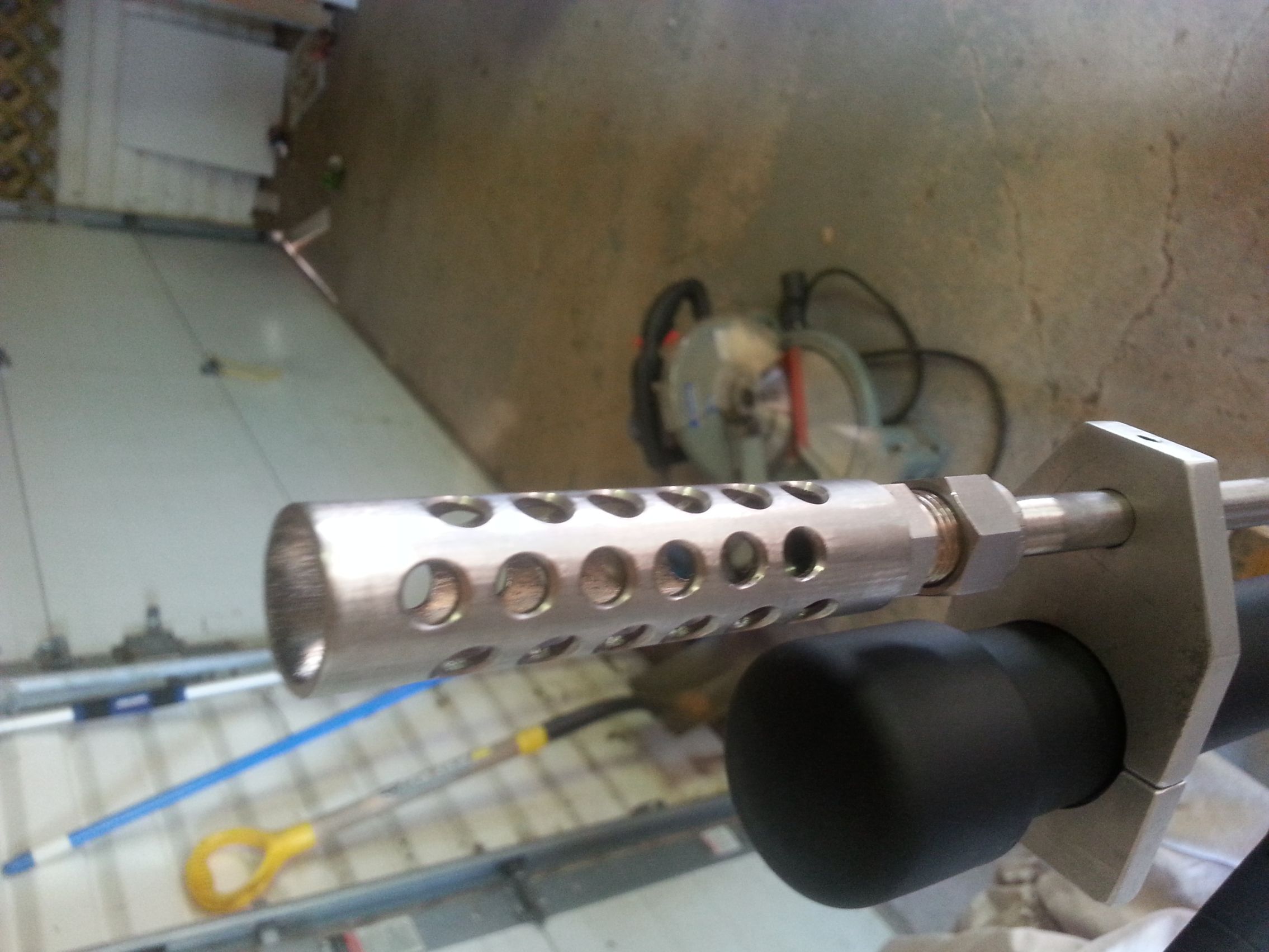

PVC painted flat black, mostly assembled now, going to mount a small 4x scope I have on it. Connector on the end of the barrel is to attach extension/silencer, about 8" long.

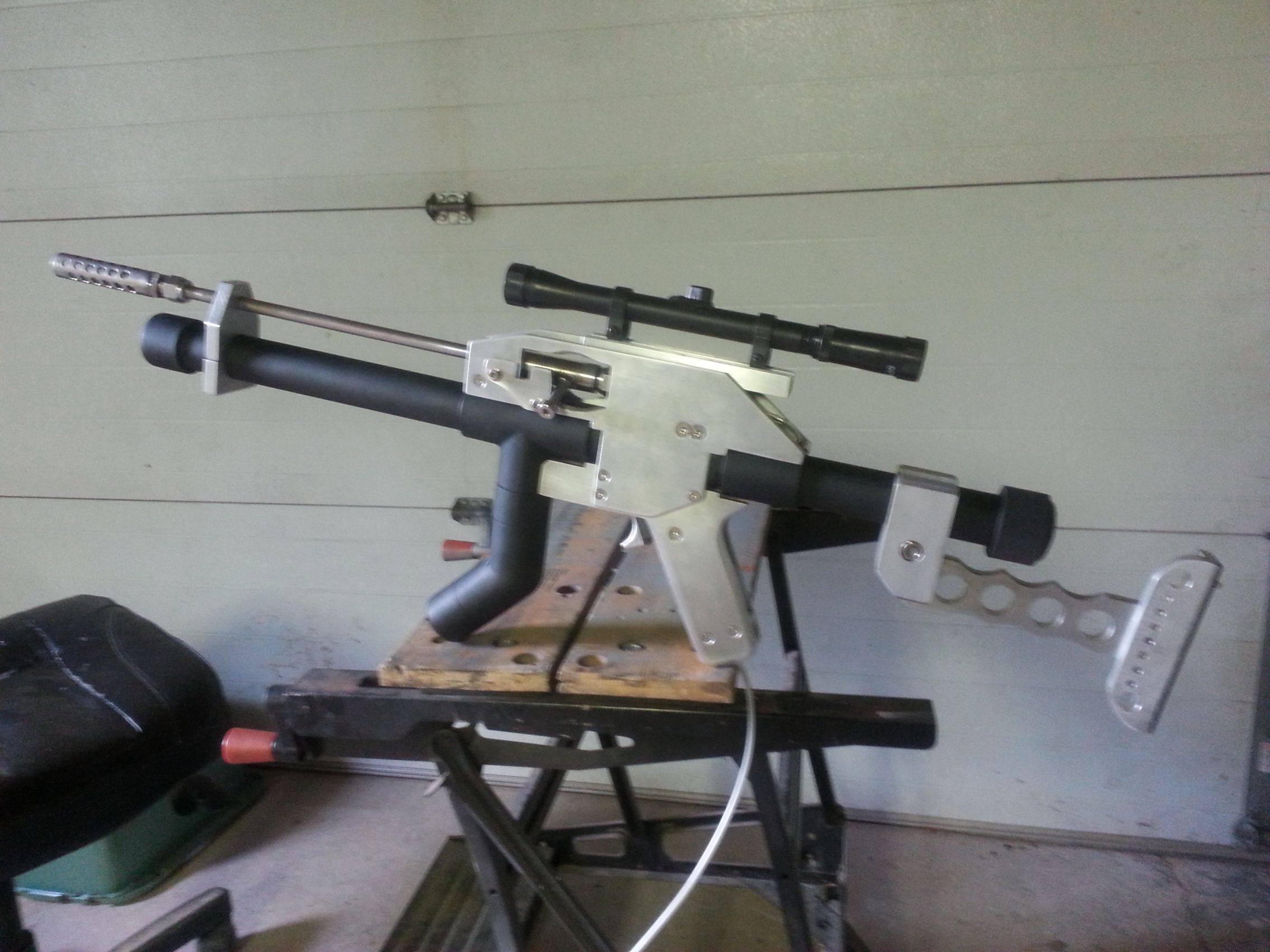

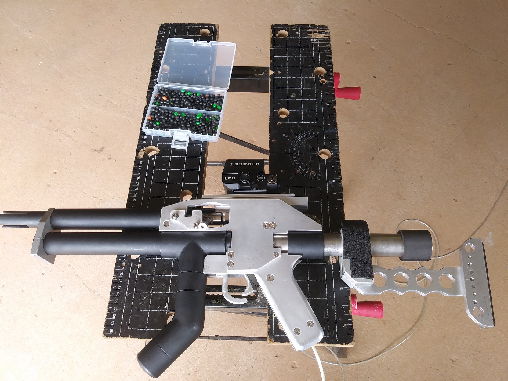

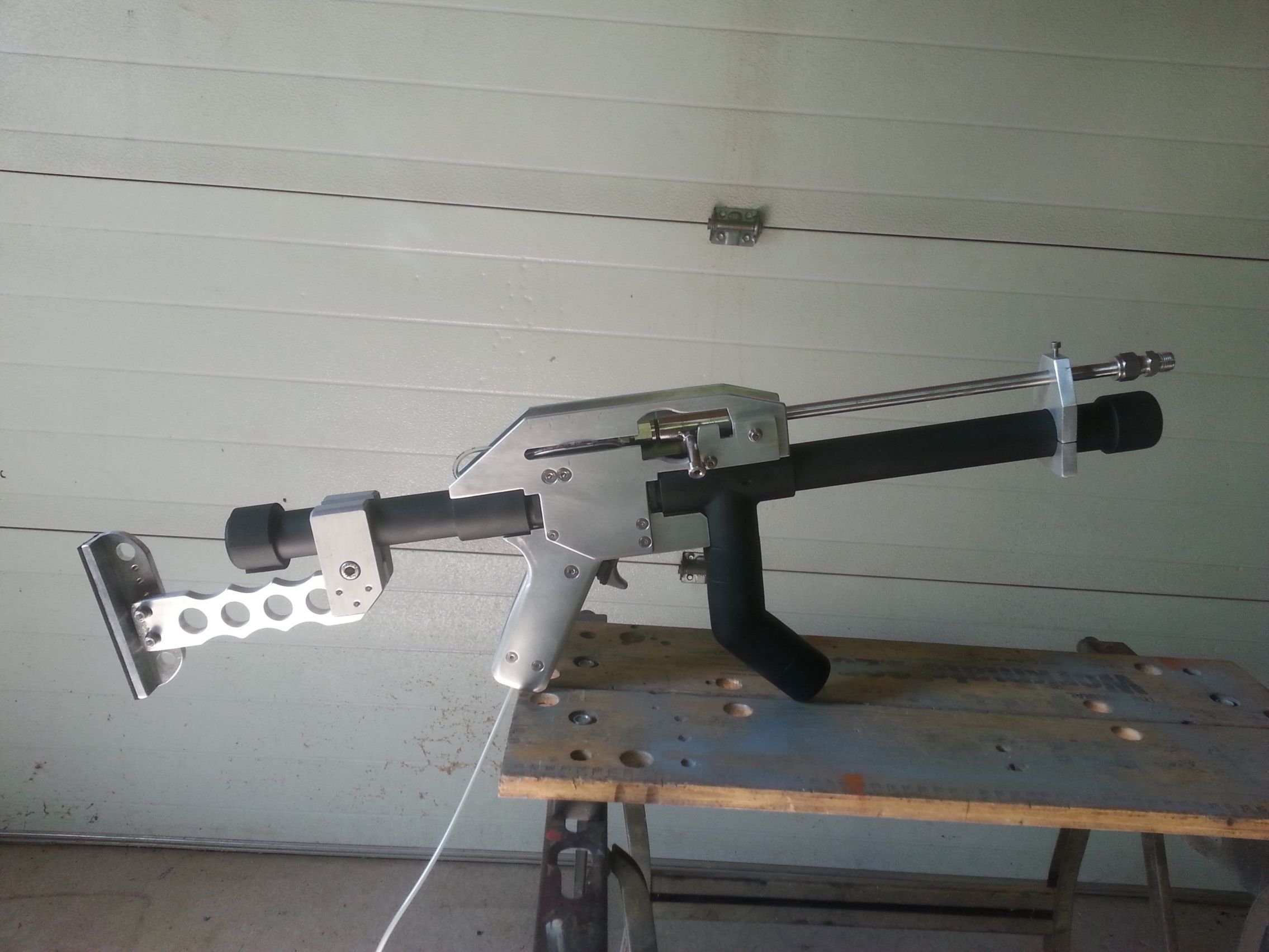

Some mods in progress, changed bolt to left side, I'm right handed but find it easier to load with my left. Mounting scope bracket, making dummy flash hider.
Did some test firing and found a leak, all in pieces now

Back together now, works perfectly, just need to get scope, sights and laser set up.

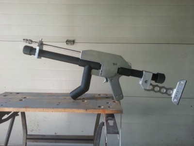

I fired a good 100 shots through it and the accuracy is terrible, just everywhere, even at 10'. I'm hoping it's the compression fitting I put on the end of the barrel has caused a small ridge inside and is messing it up, gonna cut the last 1" off the barrel and see if it fixes it

farcticox1 wrote:I fired a good 100 shots through it and the accuracy is terrible, just everywhere, even at 10'. I'm hoping it's the compression fitting I put on the end of the barrel has caused a small ridge inside and is messing it up, gonna cut the last 1" off the barrel and see if it fixes it
If it doesn't fix it, consider adding a hop up like a real airsoft gun or looking towards a heavier bb. Those are usually the most common issues with accuracy for airsoft guns.

I like the idea of hop up, now how to make one
Would a nylon tipped set screw work, or does it need to softer like rubber ?
played with it a bit more, using 0.2g over 0.12g BB's helps a bit, also extending the barrel helps a lot, seems like there is so much extra air coming out behind the BB that it pushes it off course. quite a loud crack and recoil with the short barrel, quiter and smoother with the longer barrel.
