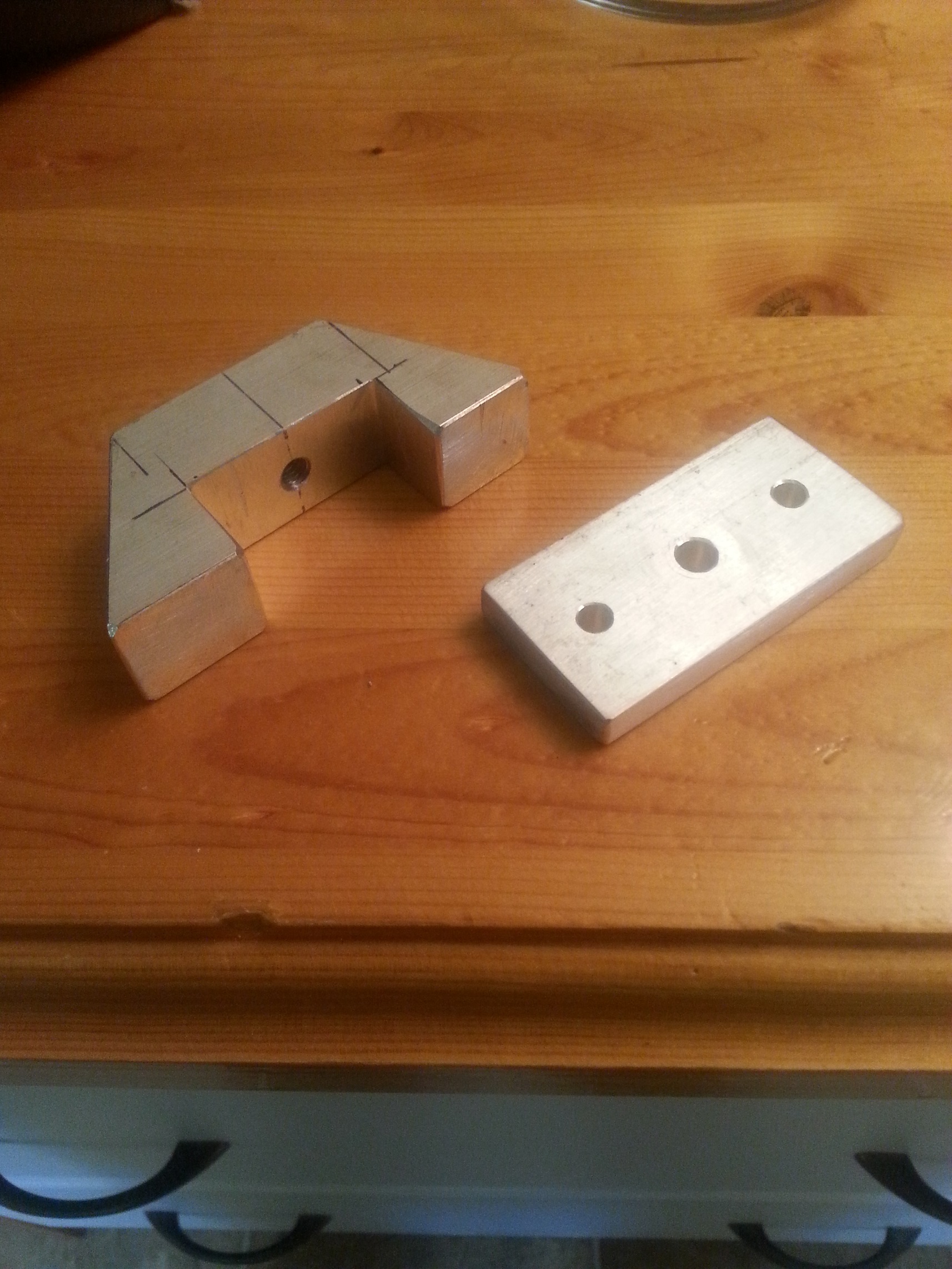

Came across this piece of 2mm thick gold anodized aluminium, and it almost looks like wood grain :shock: :idea: :idea:

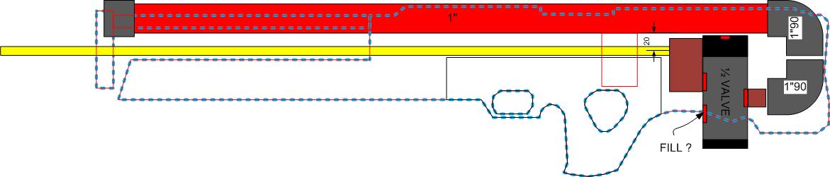

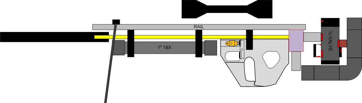

This is how it all began, as with most of the others I have built.
Get some inspiration :idea:
Make a scale plan (I use Microsoft Visio)
FAR2017 main - Copy.jpg (31.61 KiB) Viewed 34402 times

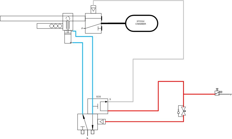

Work out pneumatic circuit
air lines 3.jpg (25.5 KiB) Viewed 34402 times

Hi, i've just been looking at your FAR2017 again, do you have your main and air chambers connected?
Re: FAR2017
Posted: Sat Nov 18, 2017 8:12 am
by farcticox1
Yes, mainly to increase the volume, I use it with the air supply always connected but only through a 4mm airline, so it tops up the chamber between shots.

Ah sorry, I thought that was what you meant before. I just wanted to get as much air onboard as I could. At least 4X barrel volume. The feed line from the compressor is 4mm OD Polyurethane which is so small you hardly know it's there, BUT it has very low flow so it is mainly there to top up the onboard chamber between shots. Originally it was going to look like this
scale bullpup2.jpg (35.79 KiB) Viewed 34055 times
