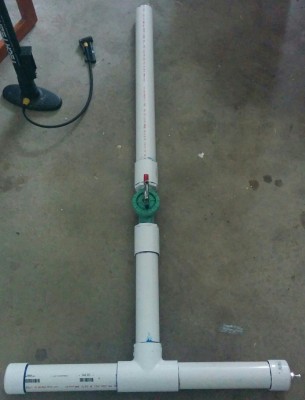

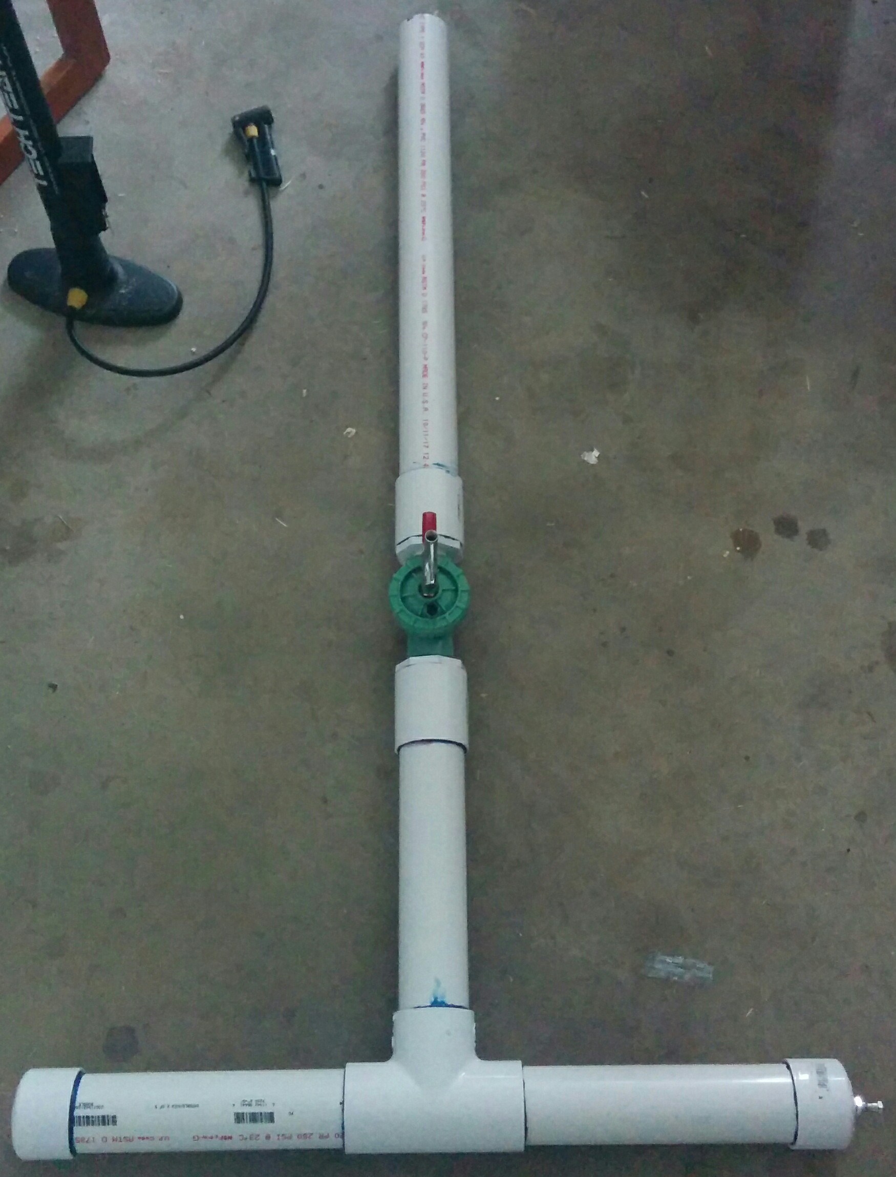

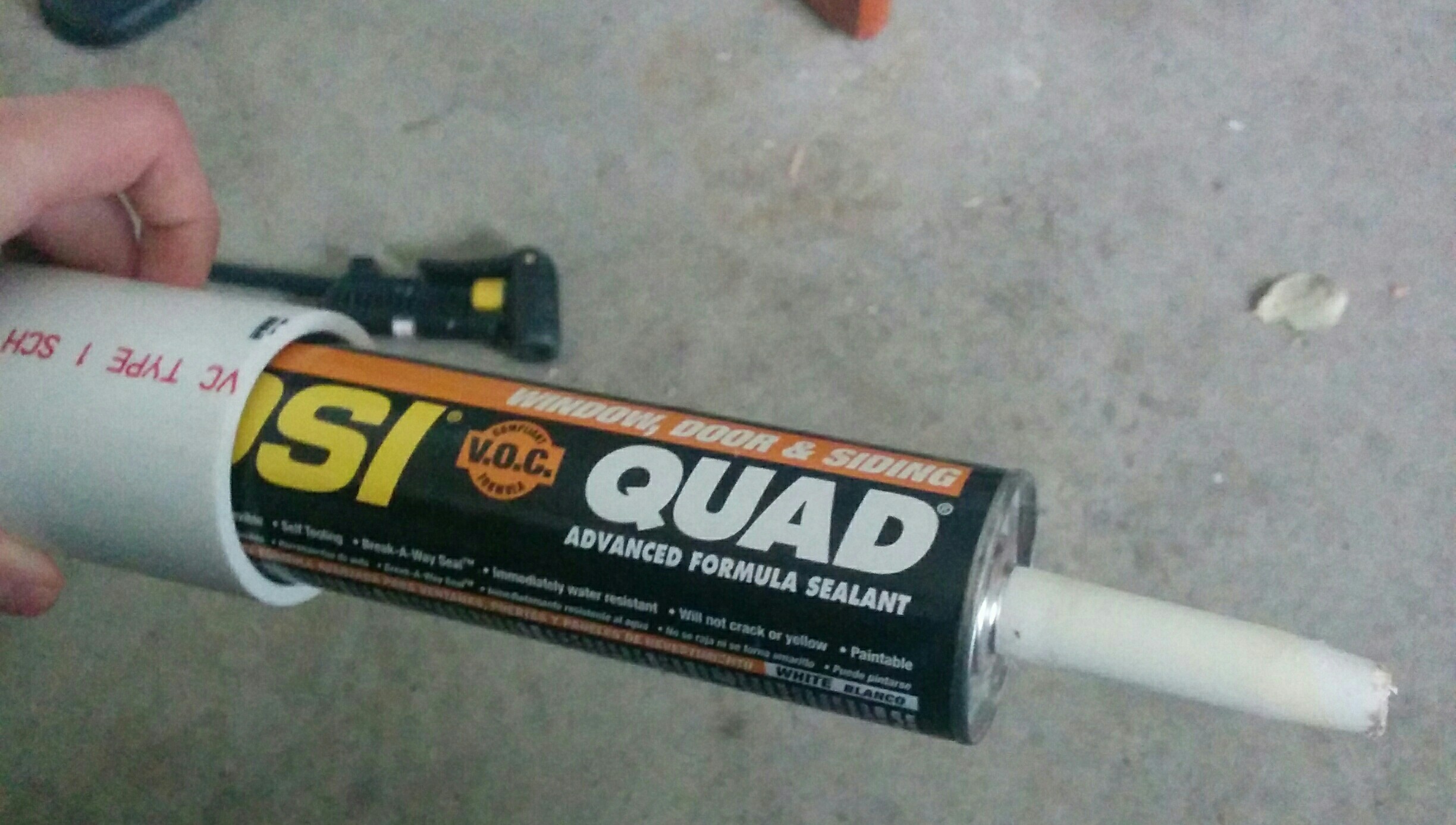

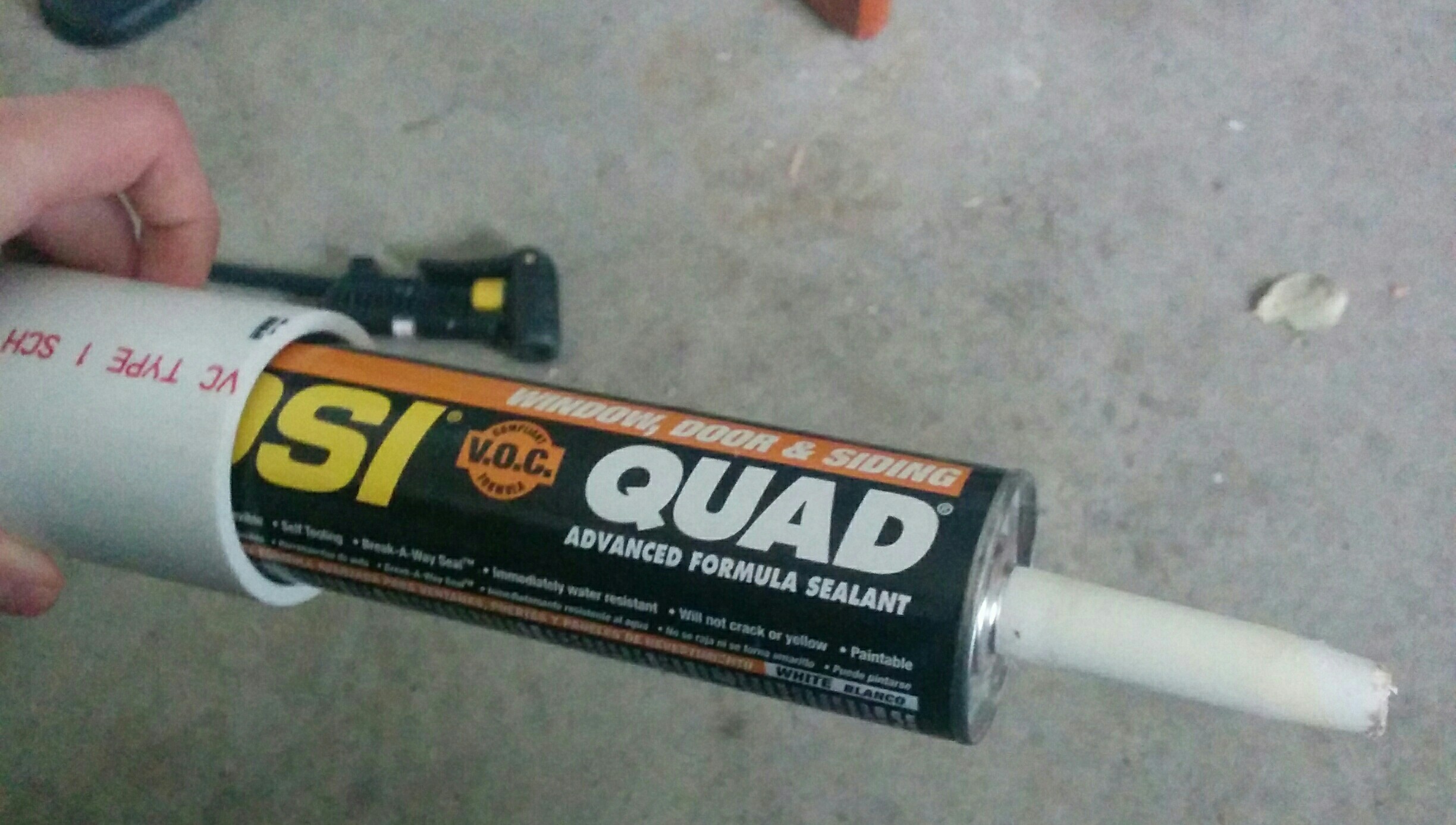

I recently built a cheap-o sprinkler valve mortar with 2" PVC and I was amazed that empty caulk tubes could fly up to 500 feet!

I'm running at only around 40 psi. The reason for the immense range is that since it's a mortar it's fired at 45°. When aimed horizontally it only goes about 45-50 feet.
I'll probably make a separate thread about it later, but I want to build the bipod and baseplate first.

The caulk tubes sadly break after hitting the ground so many times, so I've been trying to replicate their design, but I encountered some problems.
