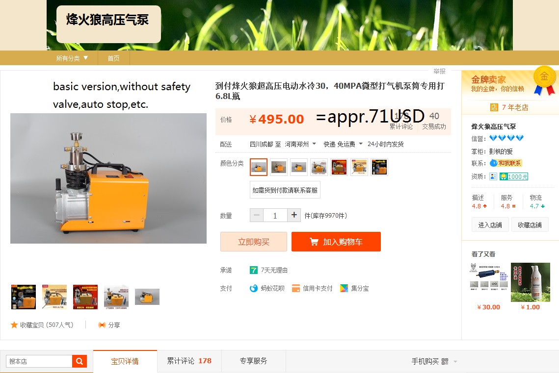

So I've recently got into PCP air rifles which require up to 4500 PSI charge pressure, and initially thought I would have to go to paintball or scubs shops to top up my carbon scuba tank. Untill I found this...
http://www.ebay.com/itm/222702809678
These compressors usually run in the 2-3k$ range, but China has done it again! I can fill my 6.8 liter carbon scuba tank from 0 PSI to 4500 PSI in about an hour (not counting the time between changing out the bucket of cooling water every 15 minutes), which is also faster than those 2-3k$ compressors. For $320 dollars. Sweet!
Just wanted to make sure you guys know about these, for those who enjoy using high pressure (JSR), I've gone the hand pump route and after having this compressor I'll never touch one again lol. I've done quite a bit of research on the durability of them, and from what I hear with proper maintenance these will run for 100+ hours before the internals need a rebuild. It also comes with a full rebuild and seal kit.
Anywho thought you guys should know about these little beauties.

That shipping cost though

Almost pressed buy, but saw the shipping cost.
Guess I'll be sticking with the bicycle pump ;(

Ohh sorry I forgot to mention there are a lot of different vendors that carry it, all with varying prices. I had to sift through a number of different pages on ebay to find mine for $320 shipped. I bought mine from a seller named "premiumautopart" listed at $305.99, ended up being right around $320 all said and done. It is a little pricey but when you take into account the cost to have tanks refilled multiple times it actually starts to make money. And one thing to know is a moisture seperator is also recommended, either a large volume of dessicant on the intake, or a high pressure rated tube with absorbent material inside on the output. Rust inside of steel high pressure vessels is a good way to ruin ones day;)
