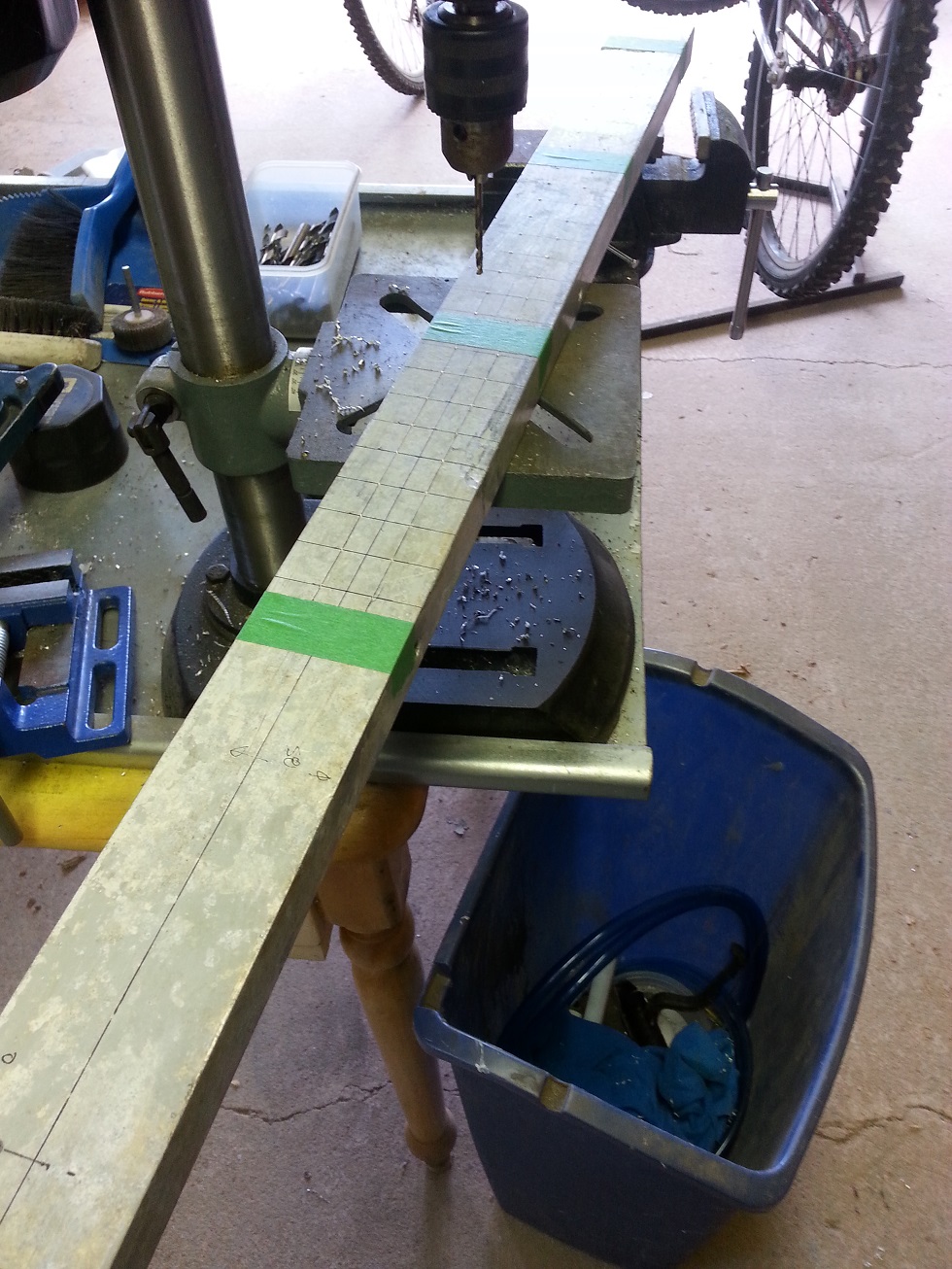

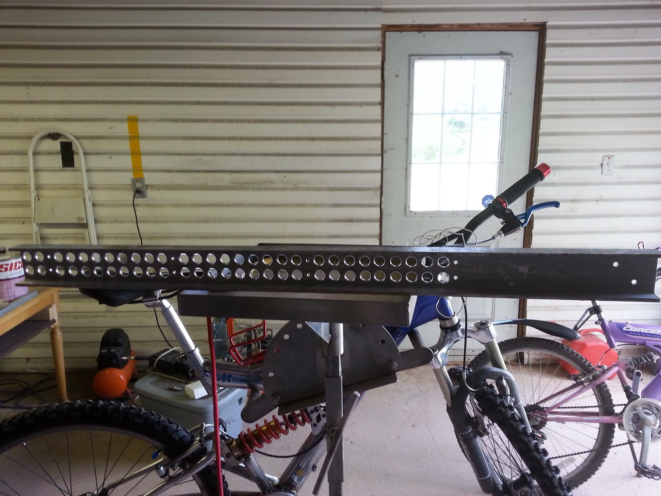

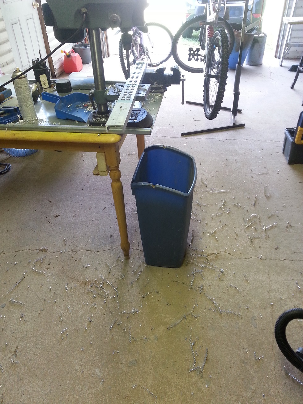

Started to work on the main piece, it's 2 1/4" x 1" aluminium channel, a bit rough in places but should work ok.
Many holes to drill
Was a bit messy
But turned out nice

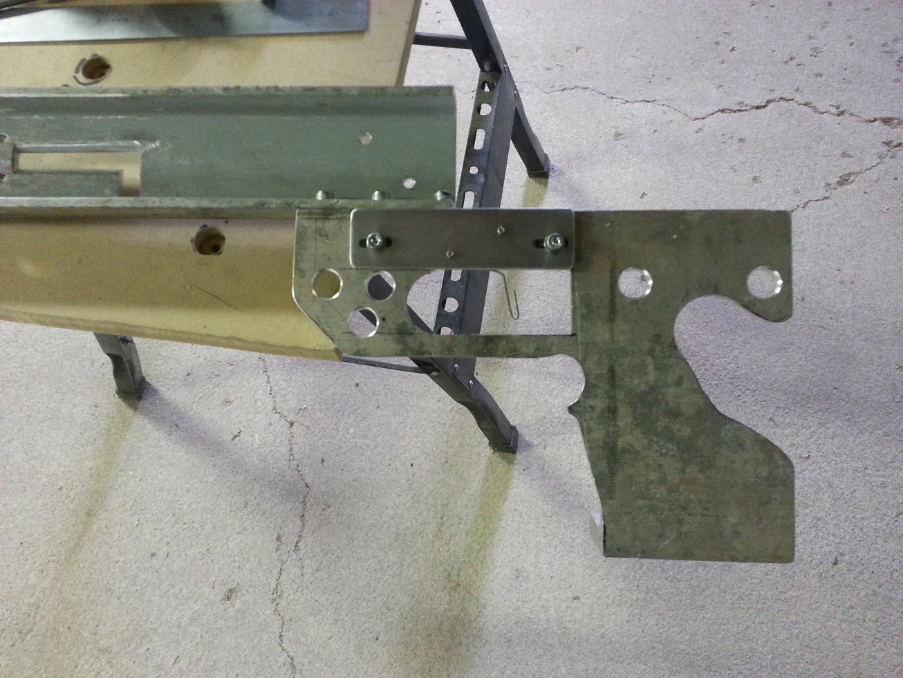

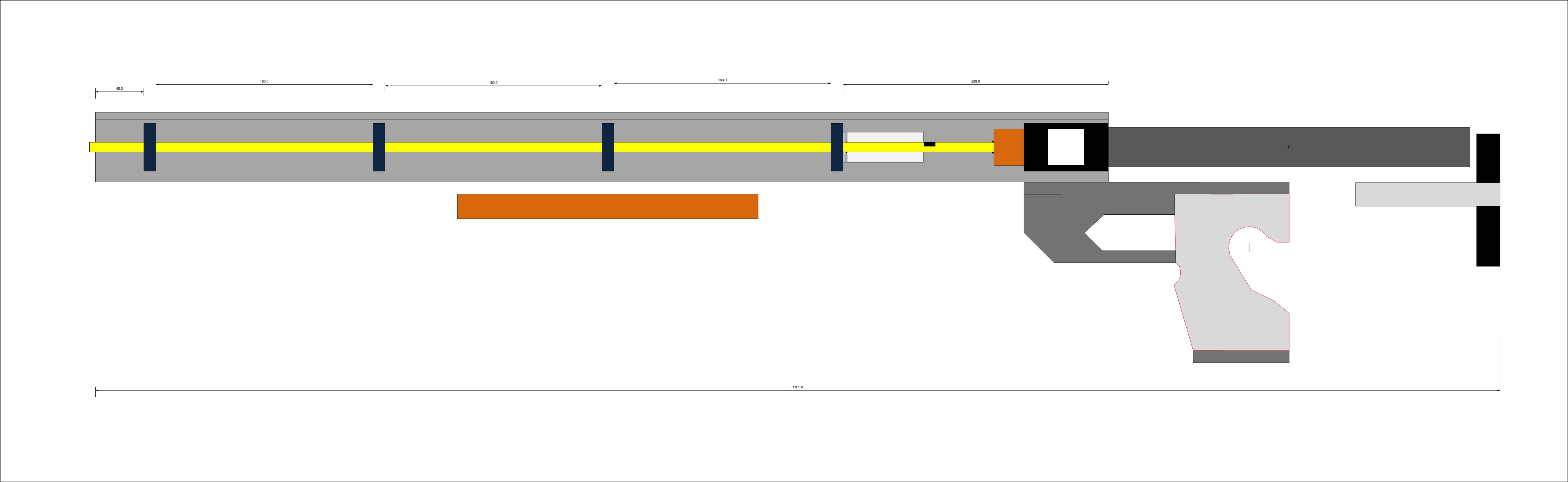

Should look something like this

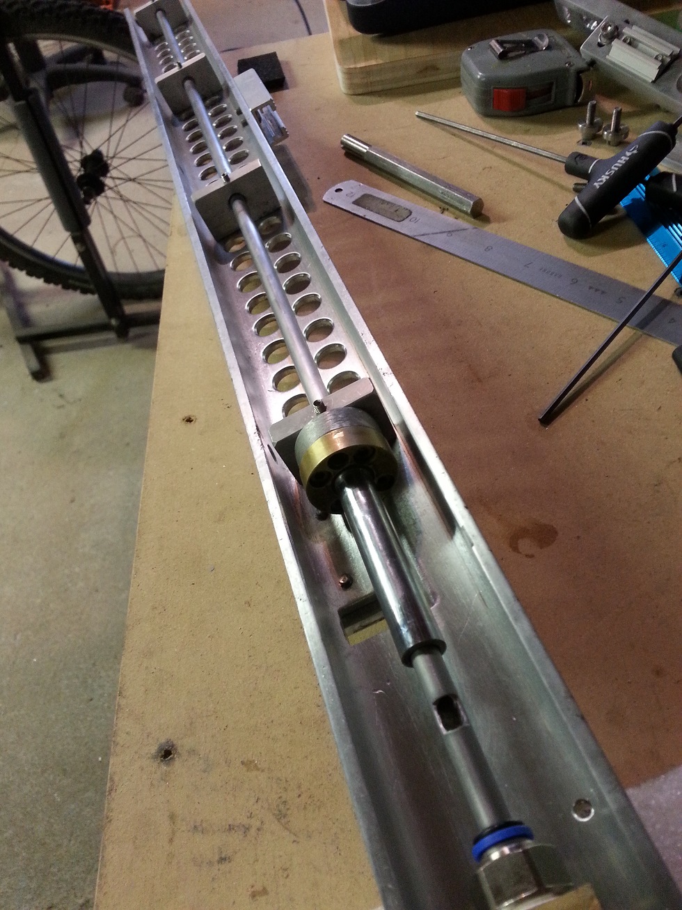

Fitted a few parts together for a preview

Just a single shot, the barrel tube is 900mm long at the moment, that's how it came, I will cut it down to about 750mm.

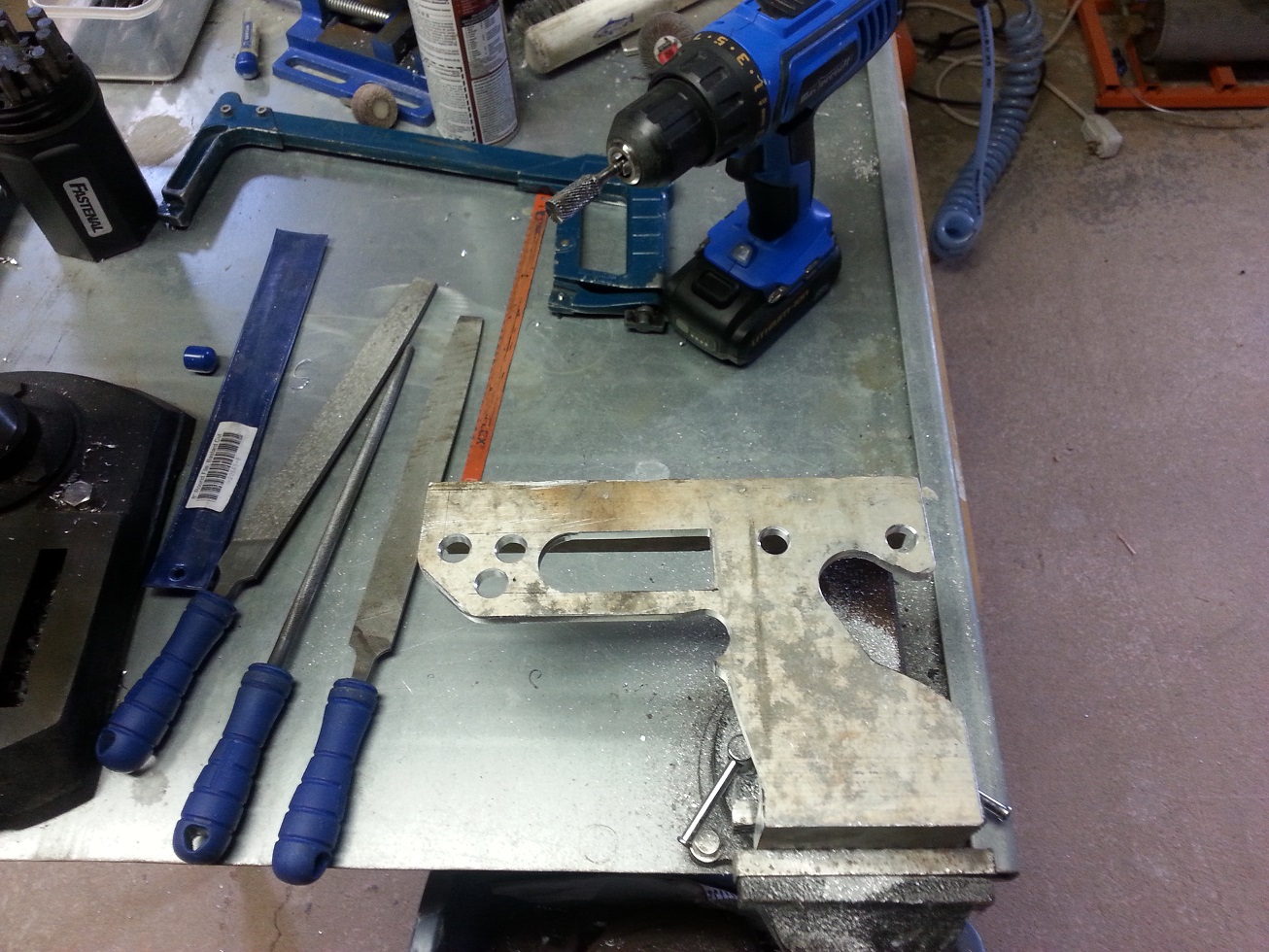

A couple of hours work with the hand tools

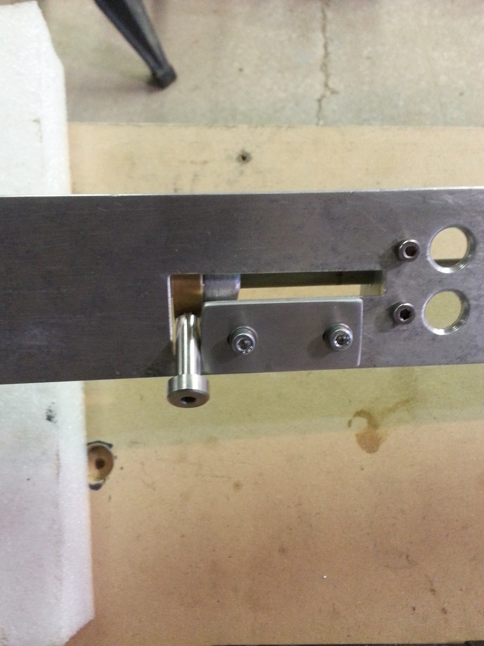

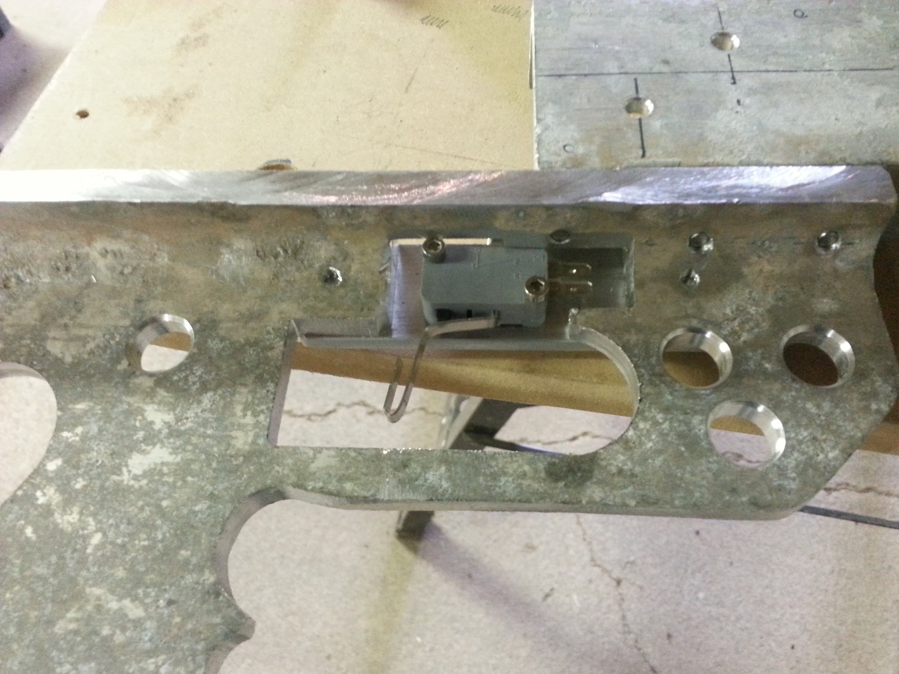

Got the grip mounted to the main body and the micro switch trigger which also has some adjustment for reach

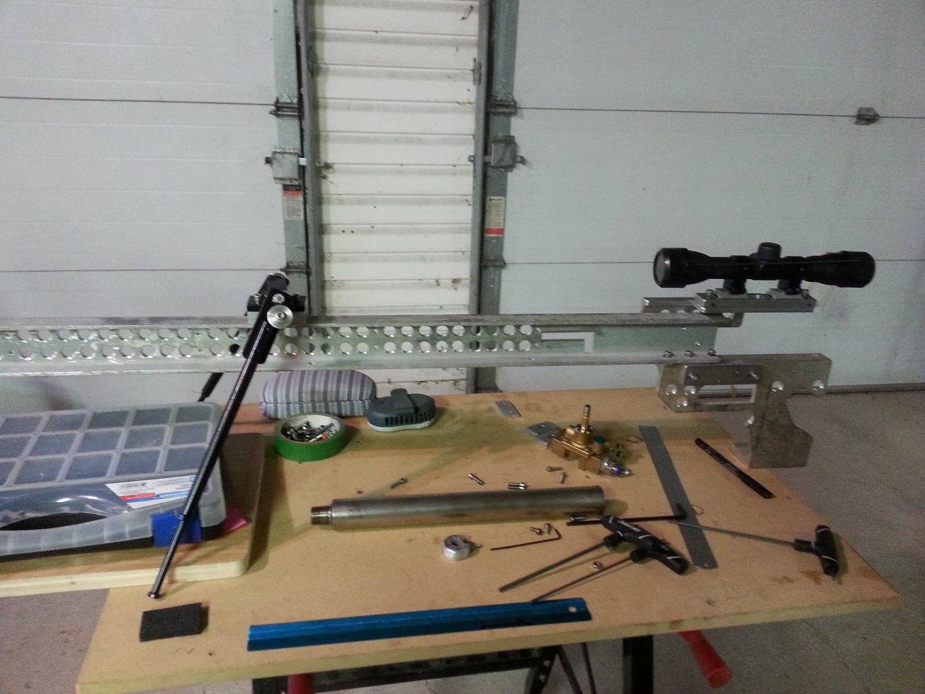

Bipod and scope mount

Noooo, I'm aiming at a target and hope something comes out the end of the barrel when I pull the trigger, everything else is a bonus.

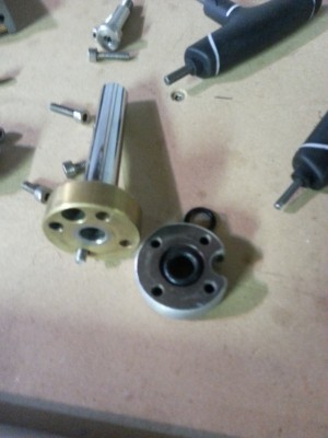

A bit more done.

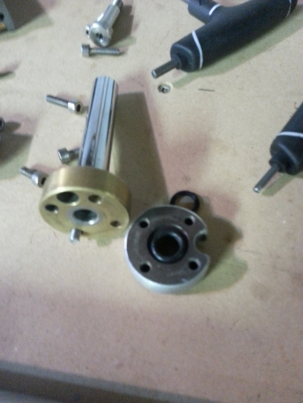

O ring seal on the breech tube. Adjustable stop on the bolt handle to put pressure on the rear O ring. Barrel cut down to 750mm, attached and locked in position, breech hole cut. Got some ammo, some domed pellets and BB's

That's a push to connect fitting at the barrel attachment if I'm not mistaken, which means if you press the blue plastic ring the barrel will come off? Even if the barrel is locked somewhere else that's not a perfect spot for the o-ring to seal against but probably won't leak much.
