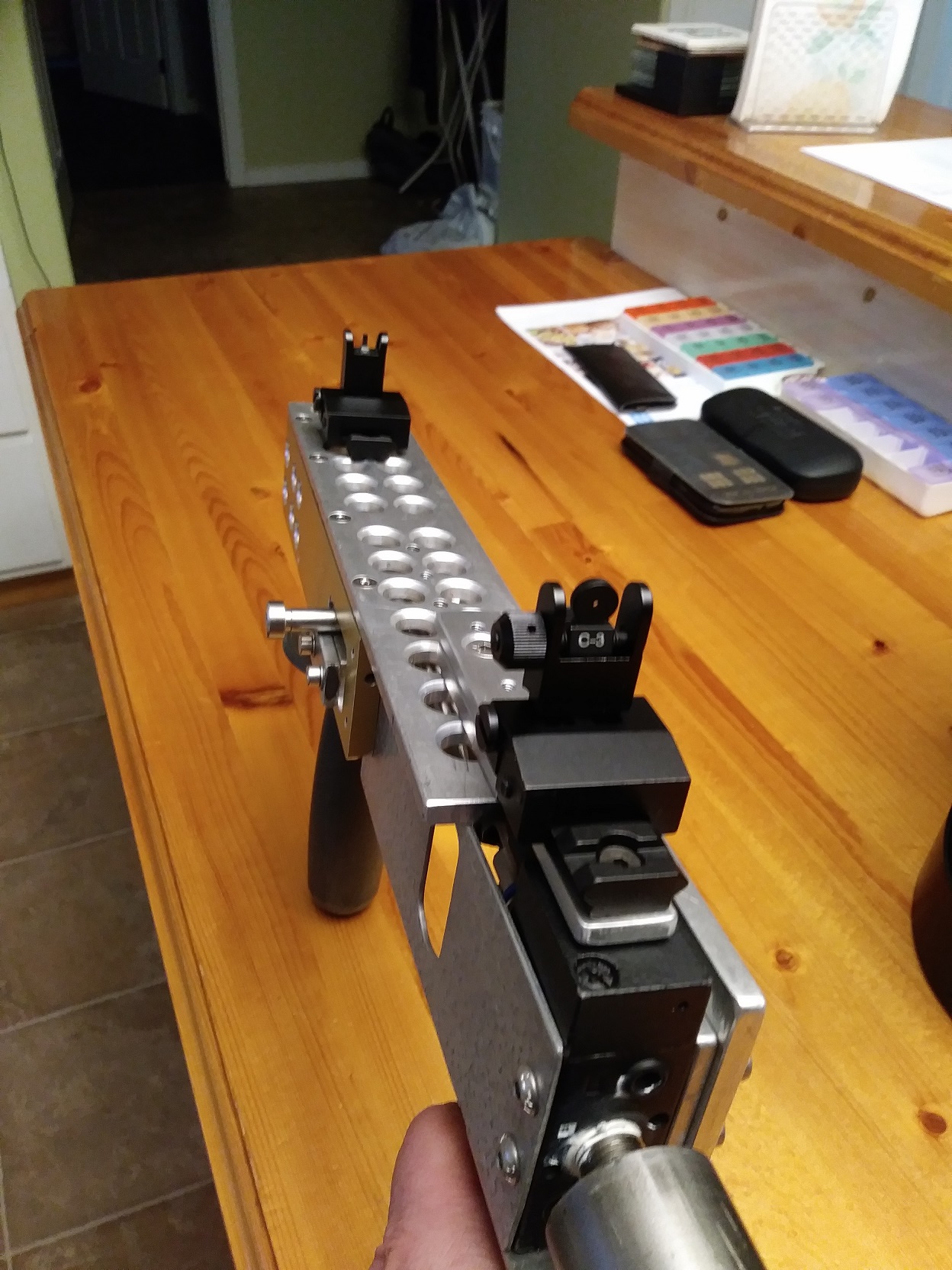

Got some decent ($20) flip up sights off Ebay to try.
Re: Compact .177
Posted: Sun May 05, 2019 10:54 am
by farcticox1
Finally got the flip up sights set up.
Rear sight has duel apature, the small one seems better at close range.
2 x 10 shots at 9m bullseye target.
Re: Compact .177
Posted: Wed May 08, 2019 9:10 am
by jackssmirkingrevenge
For a home-made smoothbore those are excellent groups at 9 meters with open sights, bravo!
