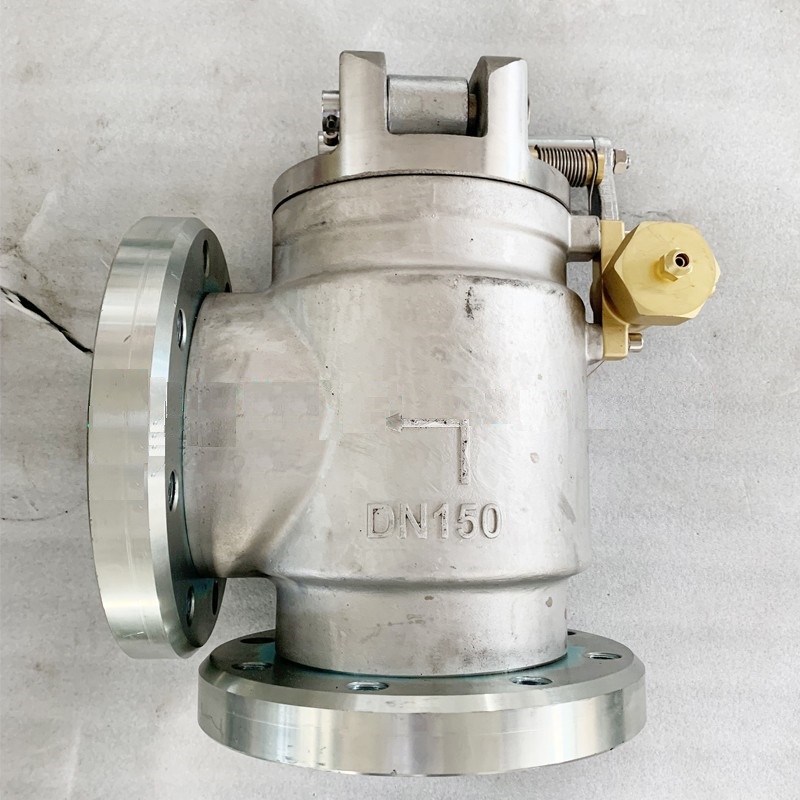

If you need approvals and have tax dollars to spend, you could drop Emerson a line and ask about piloted relief valves. Anderson Greenwood has something that might be made to work...not sure how quick it'll open as supplied, but it's basically a big ass qev.
https://www.emerson.com/en-us/catalog/a ... od-p001062

try using the name pressure relief valve, over exhaust valve
im in the same boat, trying to track down info on an supposedly adjustable pressure relief valve.
between 150 and 800 psi.
boiler or steam pressure relief valves might work too, some even have a triggering device on them too.

Found a "Cla-Val" pressure reducing valve during random Craigslist browsing. Was curious on what it was. Searched the manufacturer and they look almost identical In design to the ubiquitous plastic sprinkler valves. Specs showed up to 36" and 400 psi with higher pressure rating available. All the porting and pilots are external, I'm curious if that sort of valve might be easily converted for air cannon use?
