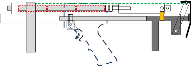

Experimenting with a self contained pump action airsoft using an air cylinder and springs to provide the power. Using a 1 1/16" bore X 2 " stroke cylinder.
Cylinder is on the top and facing forward which means it needs to be pushed forward to compress springs rather than backwards. Will be self loading if I can make it work, FPS is not critical as I want to use it indoors :D

A bit of progress, bracket in the middle is for the grip, sprig guide needs a locking collar for the charge handle to push on, trigger not figured out yet or linkage to rear to load.

More done, linkage from charge handle to rear to be made and trigger needs a return spring, power seems low but that's what I wanted. The springs are about as much as I can push, rearward charging is definitely needed for more spring tension.

A few tweaks and it's ready to go back together again, just the connecting rod to make from the charge handle to the loading arm at the rear.

Trying to make a different/better system for the spring charge/loading handle, this looks much better than the sliding handle I had at the front. The handle would jam very easy because it was trying to twist as it was sliding, the new handle takes much less effort and will be more compact. Still a work in progress :idea:
