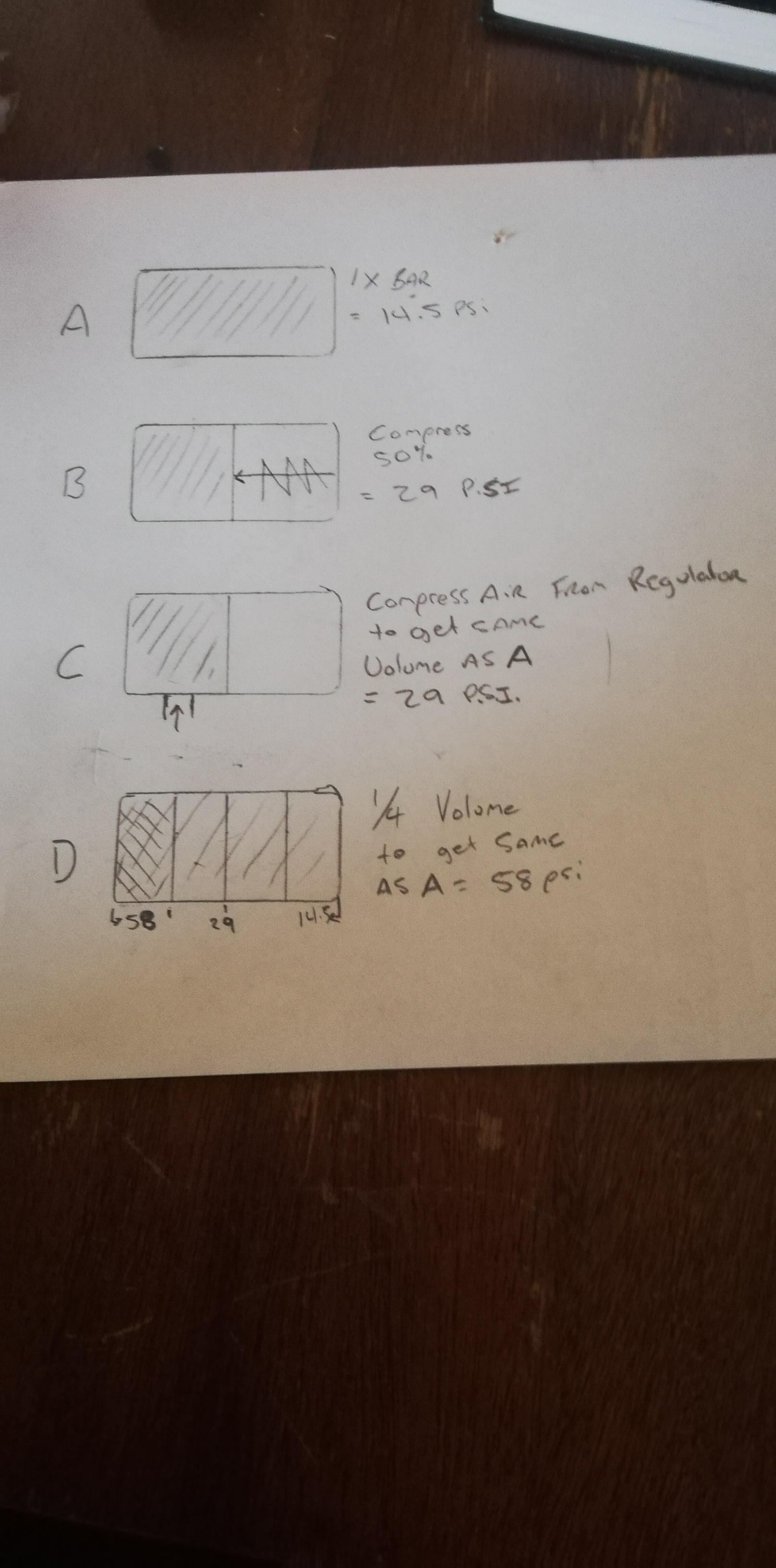

Moonbogg wrote: Wed Jul 01, 2020 1:49 pm Talking about both volume and pressure.
For a determined Barrel to cylinder / chamber ratio. Without changing barrel volume.
Just working on cylinder and pressures to volume.
I could be wrong too, seen somewhere take 1 bar off regulated pressure gives actual reg pressure.
In that case suppose adjust for that.
- Moonbogg
- Staff Sergeant 3
- Posts: 1742
- Location: SoCal
- Has thanked: 169 times
- Been thanked: 102 times
Doc j wrote: Wed Jul 01, 2020 6:48 pmI see what you're saying. For example "D", I think the psi would be as you show, 58.8psi. However, the psig would be 44.1 because that 1/4 section already has an atmosphere in it. So the regulator would be set to 44.1psi. That's my understanding of it. Are you working on something that you had a question about? I lost sight of what you were trying to do.Moonbogg wrote: Wed Jul 01, 2020 1:49 pm Talking about both volume and pressure.
Doc j
- Private 3
- Posts: 56
- Joined: Tue May 19, 2020 5:59 am
- Has thanked: 15 times
- Been thanked: 13 times

Interesting to note.Moonbogg wrote: Tue Jun 30, 2020 6:17 pm If you have the same air volume and the chamber is 1/3 the volume, the pressure will increase by 3x.
https://www.omnicalculator.com/physics/boyles-law
Apllying my reasoning, punch into calculator.
As cylinder reduces in volume.
increases the pressure to compensate for
The loss of volume. (more like expanded volume)
Using the above, the barrel pressure is the same.
Then my question is.
Regardless of barrel pressure.
Projectile receives higher pressure.
Is a better outcome.
OR achieve same result if used lower pressure
And bigger cylinder/ chamber volume.
- farcticox1
- Sergeant
- Posts: 1088
- Has thanked: 69 times
- Been thanked: 103 times
Higher pressure will always give better performance, you can use smaller chamber to get the same volume, and probably smaller valve, just that everything has to be rated for that pressure, that's why I stick to 150psi, materials are easy to get hold of.

Ended up getting Ggdt.
To work On desktop pc.
First time having a play around.
Working off the above,
Punched in details.
On paper,
Went to 1/8 th of cylinder start volume went x8 pressure 116psi.
Gave only 18% better fps. (+33fps)
Than the 14.5 psi on full cylinder volume.
Helped can that direction of thinking.
Better model working off 116psi.
Was 30 to 50 % cylinder volume of the barrel volume.
Was flip orig ratio on its head. (orig was 1.5)
Working Off 116 psi.
Best was create a Frankin barrel /Tripple orig length. Because 1/2 cylinder to the orig barrel length did increase performance by bit under double.
But triple it then 1/2 cylinder Volume to that, gav it bit under doubled that again.
Then x8 of pressure in that orig cylinder volume.
Triple the length barrel.
Gave 307. 4 % better. /on top + 518 fps.
