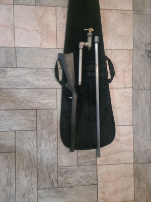

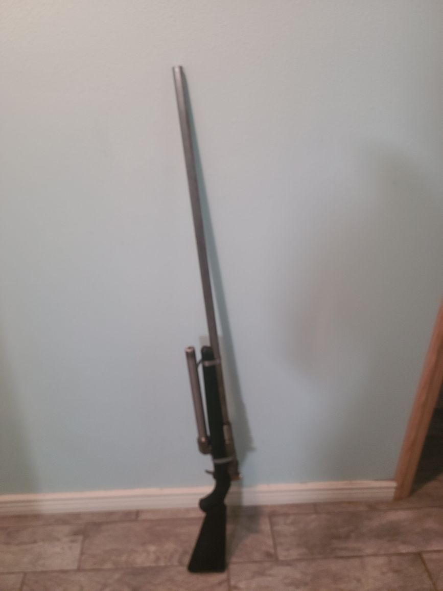

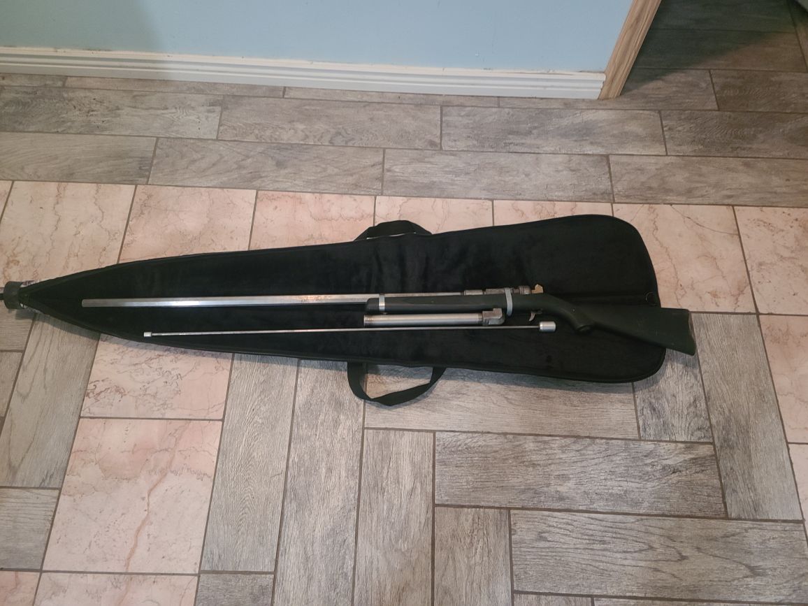

Hey guys, its been a very long time. I previously used the name "*###*" I lost access to my account and it seems I'm sol as far as recovery is concerned.

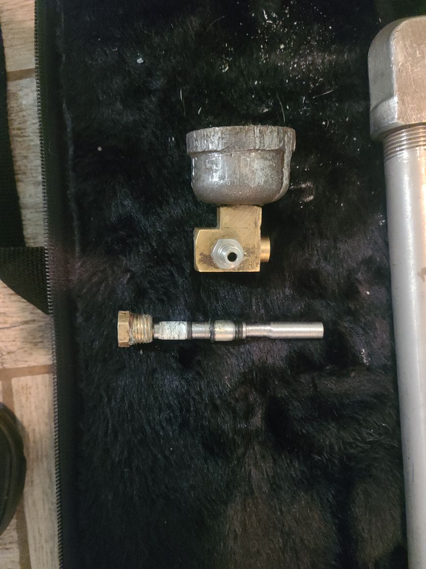

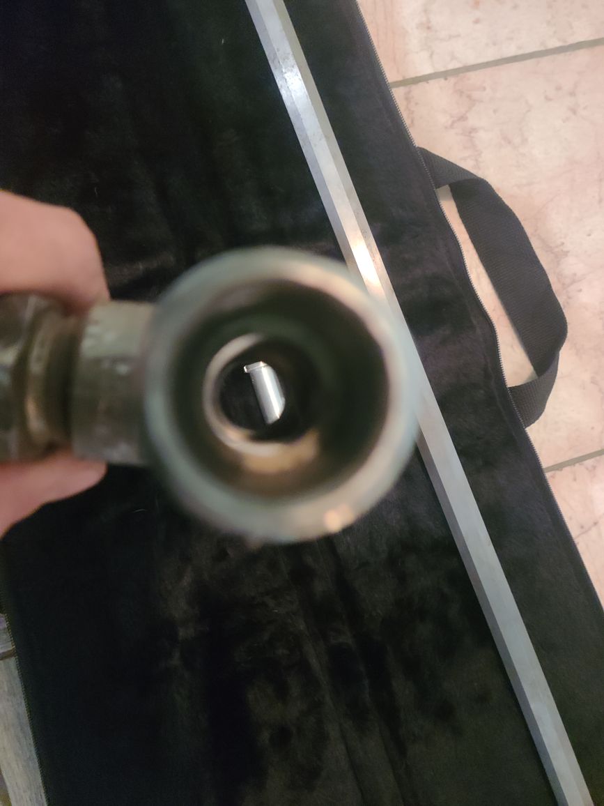

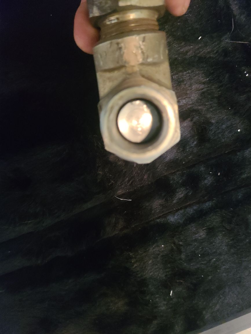

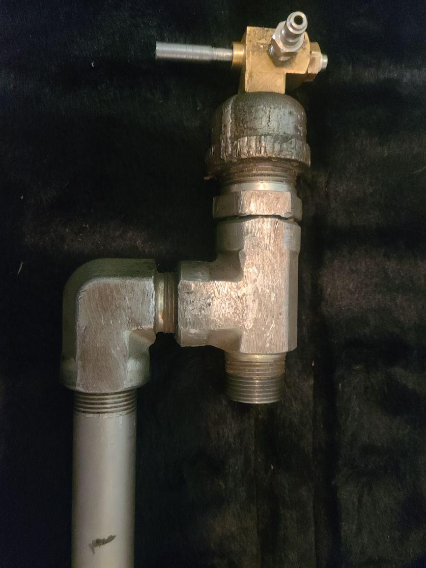

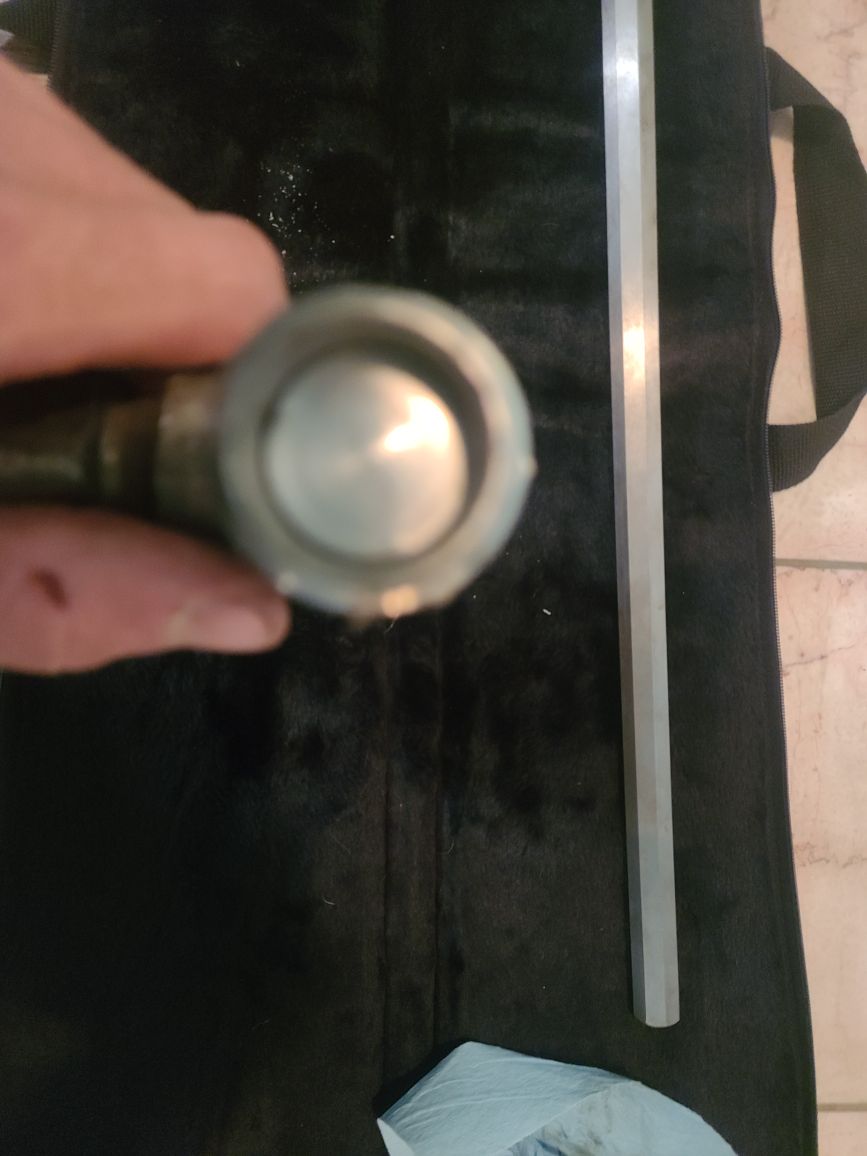

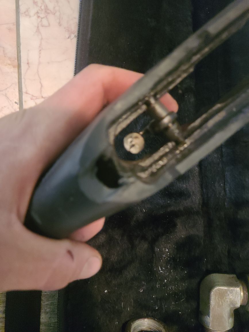

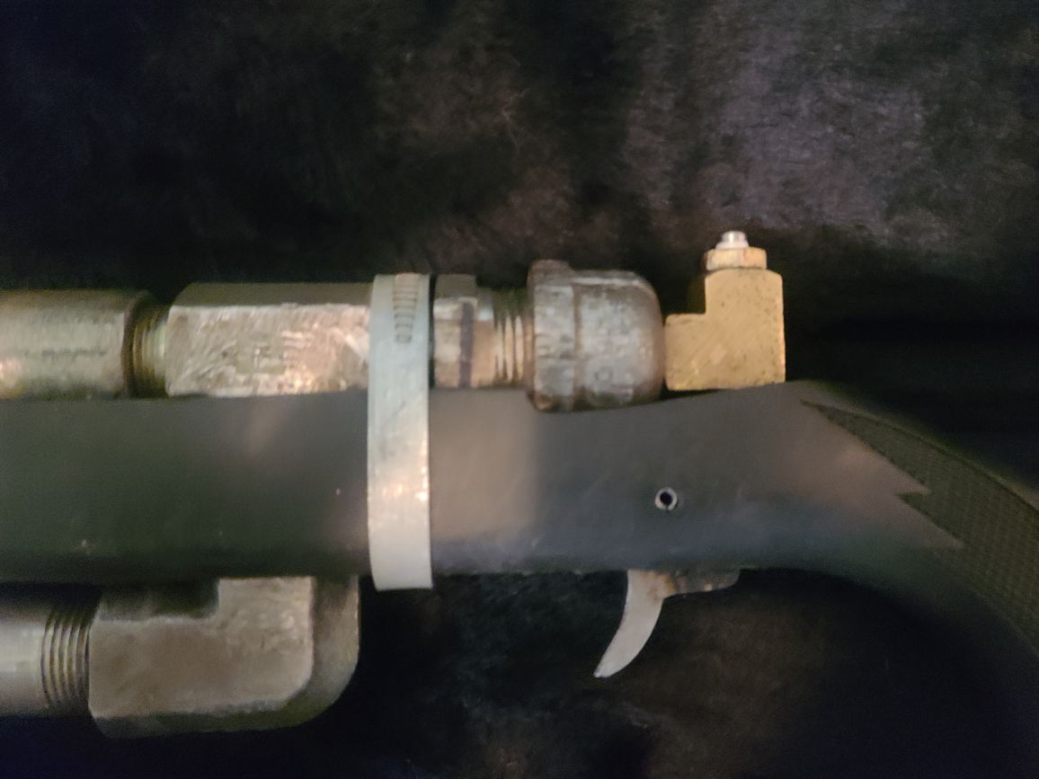

I have built many more great toys over the years and I felt like getting back into the community to share my knowledge as well as to learn and become better my self.
This is my greats feat so far.

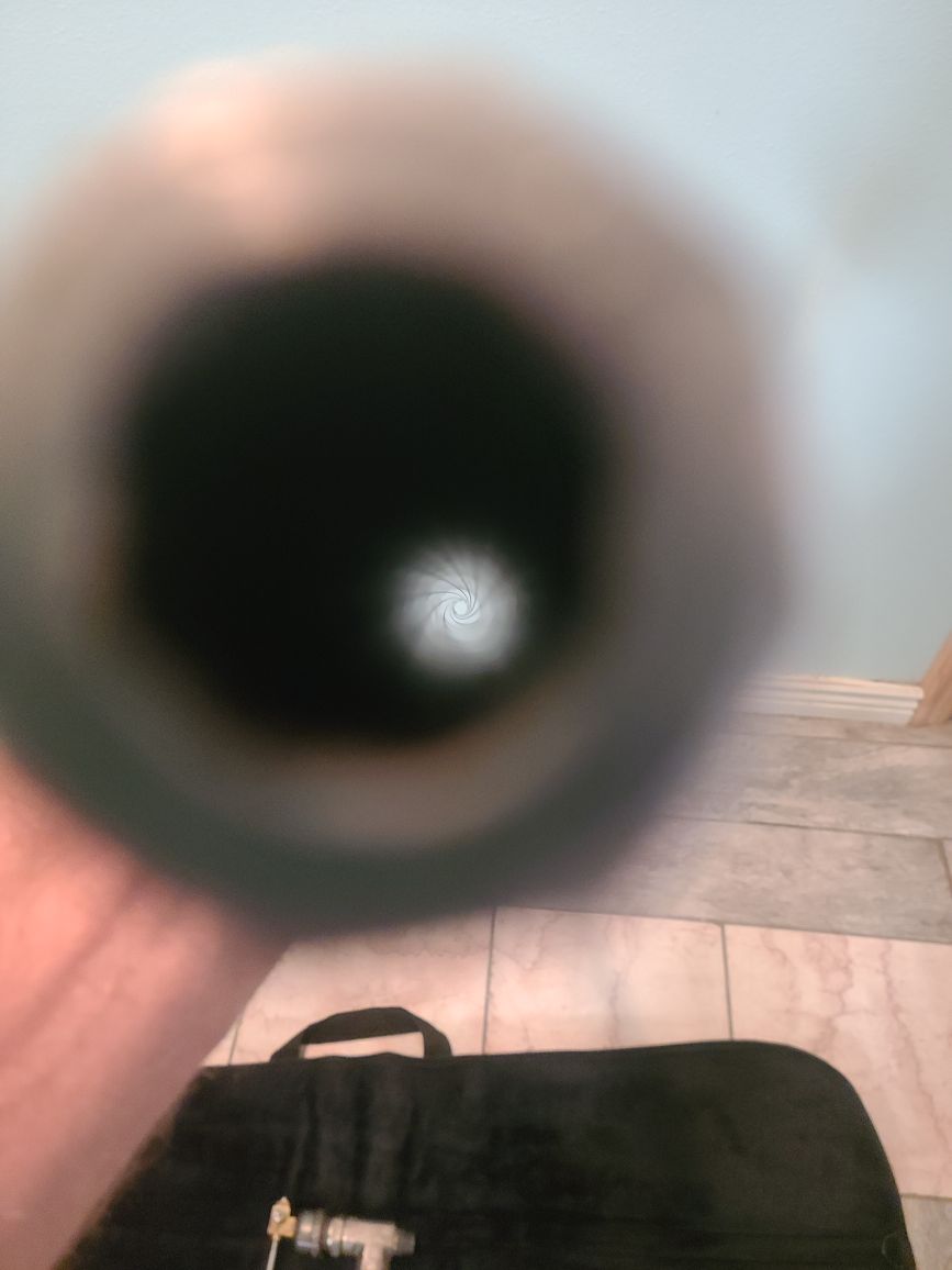

It has 50cal muzzle loader barrel rifled 1:70 from green mountain rifle barrels.

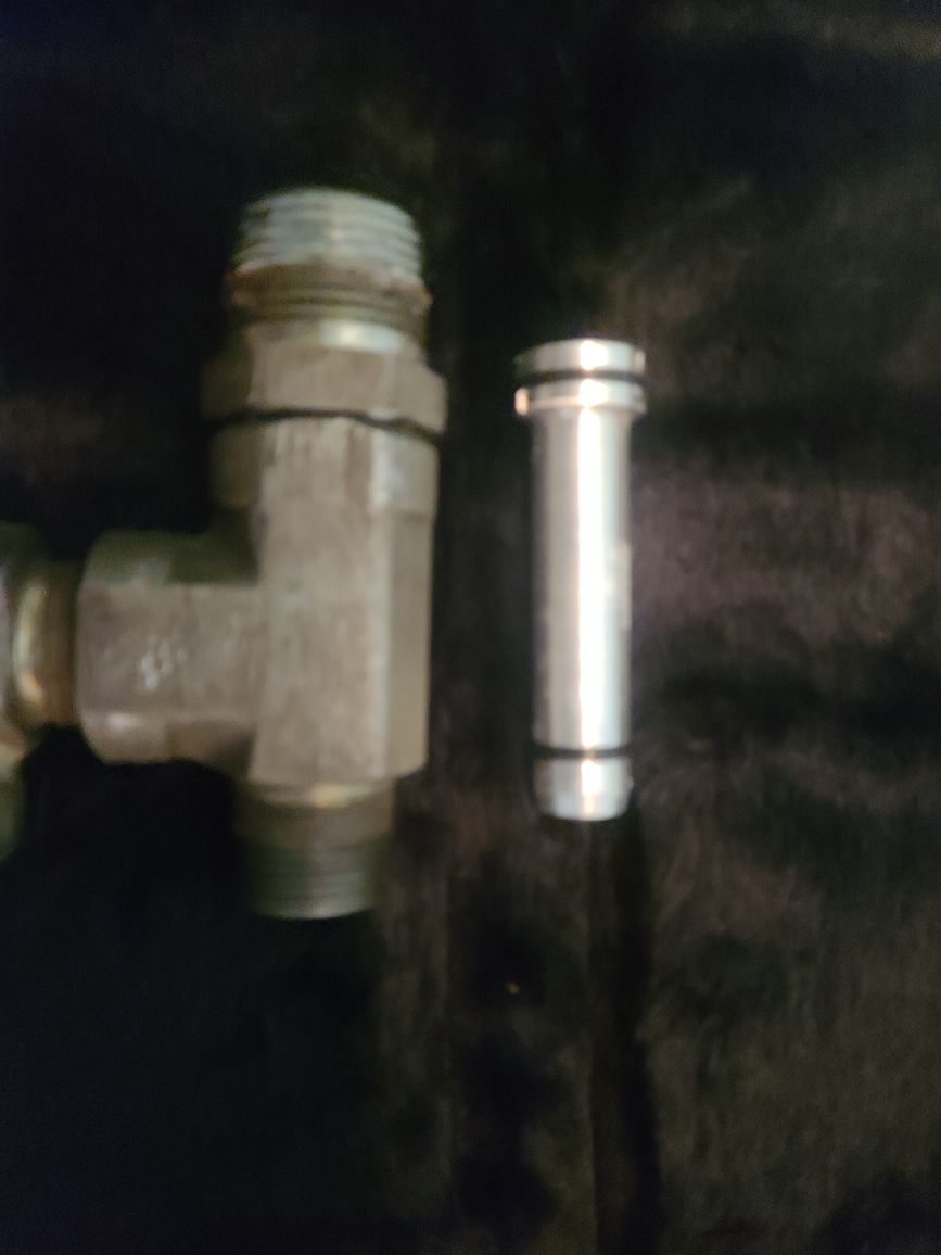

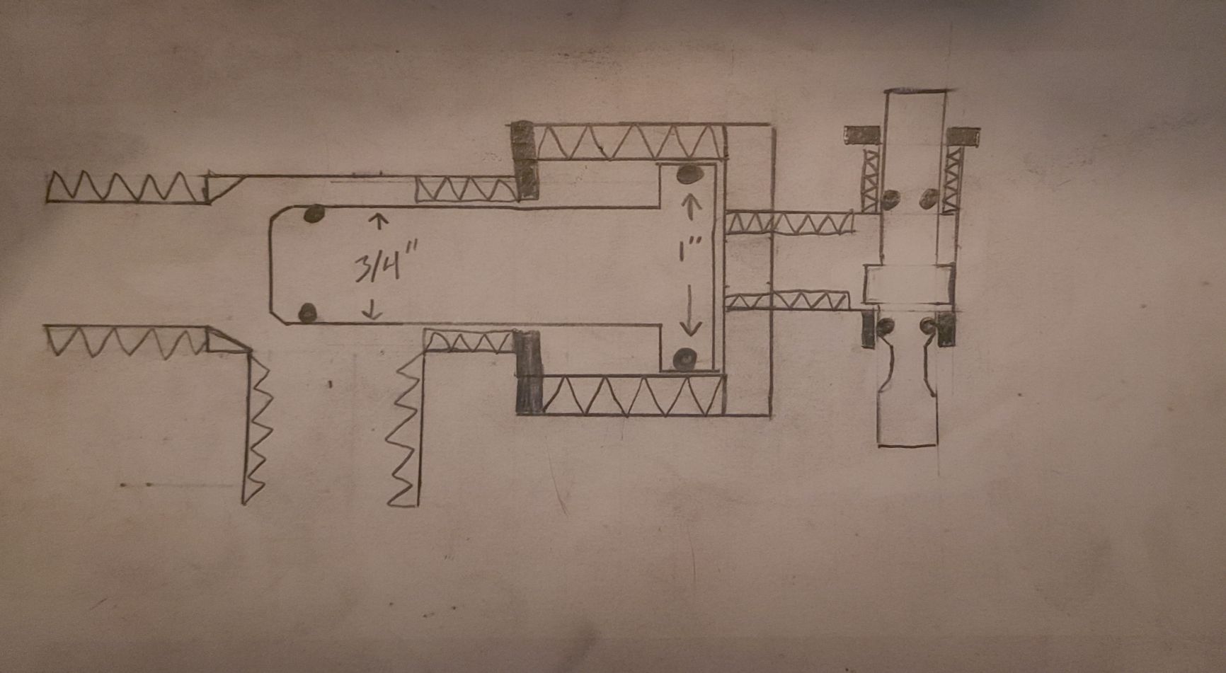

The main components of the rifle are 3/4" 3000 psi hydraulic plumbing. The 3/4" street tee has a 1-3/4 male male adaptert. A 1" cap drilled and tapped to fit a 1/4 nipple and reinforced with jb weld(the only component not rated to 3000psi at the time of writing).

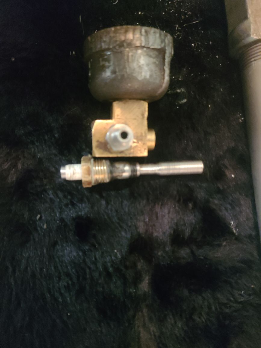

It is operated by a custom spool valve made from a brass street t and a 1/4 cap. (At 3000 psi even a shreader valve take 250 pounds of force to actuate)
The operation is what I'm calling a spool valve opposed to a piston due to the fact I am using oring seals instead of a sealing face.
The piston is machined from aluminum round stock.
The rifle stock is from a ruger 10/22. I had it laying around and it fit, so why not?
I dont know of i covered everything. If you have any questions let me know.
I'll let the pictures day the rest!
Sorry for the random order of stuff.

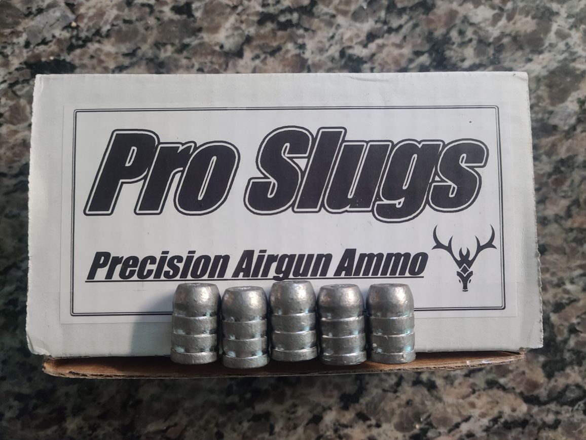

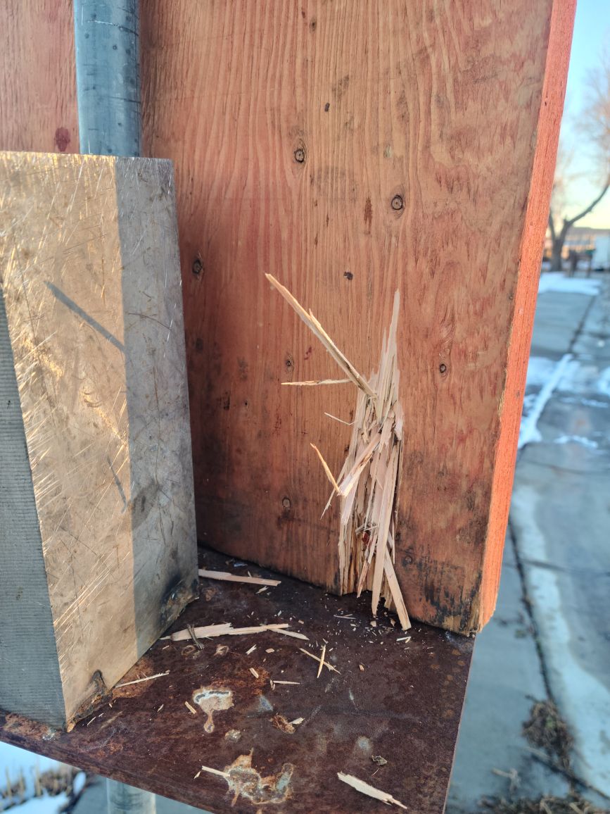

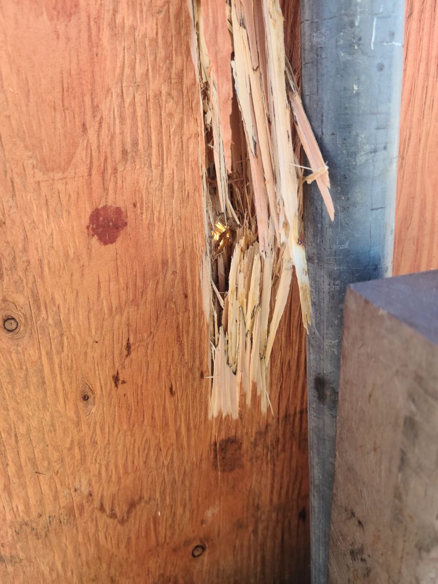

I'm shooting 360 grain slugs at the moment. At 1800 psi it shoots clean through 2" plywood. No hesitation at all. At 3000 I feel like it could drop a grizzly bear. A chronograph is pretty high up on my list but currently I dont have any actual number for performance.

Here's what I'm shooting.

PracticallySane wrote: Wed Nov 25, 2020 6:20 pmI'm shooting 360 grain slugs at the moment. At 1800 psi it shoots clean through 2" plywood. No hesitation at all. At 3000 I feel like it could drop a grizzly bear.
It probably could... 360 grains at say 1000 fps is 800 ft lbs of energy, and people have been dropping buffalo with that sort of performance.

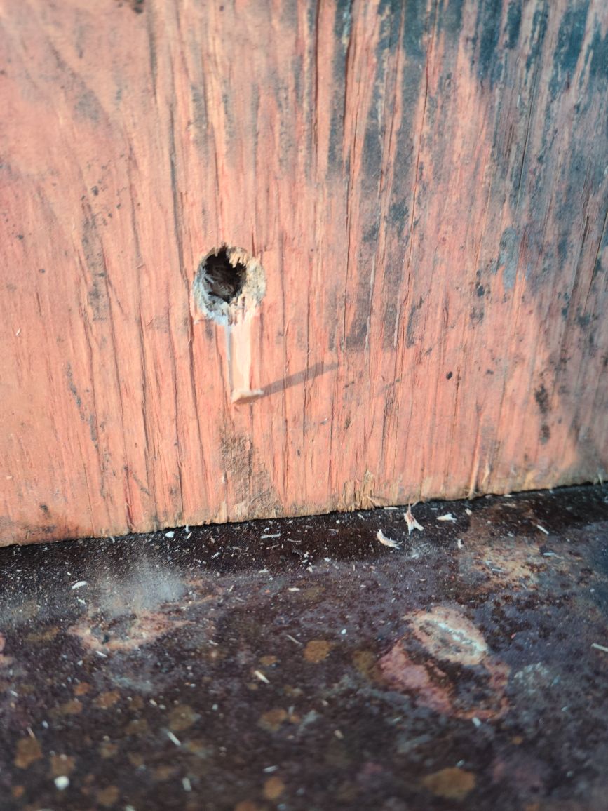

I launched a few arrows out of this thing. I got about 8" penatration on a old telephone pole at 2000#.

Did some more shooting. Decided to put the slug in backwards as a hollow point. 2200#. This is a piece of 2" plywood. Can I upload videos here?
I’m a scientist; because I invent, transform, create, and destroy for a living, and when I don’t like something about the world, I change it. ~Rick Sanchez.
PracticallySane wrote: Thu Nov 26, 2020 1:24 pmDid some more shooting. Decided to put the slug in backwards as a hollow point. 2200#. This is a piece of 2" plywood. Can I upload videos here?
Impressive!
There is no direct video upload but video links like say youtube will be automatically embedded.
