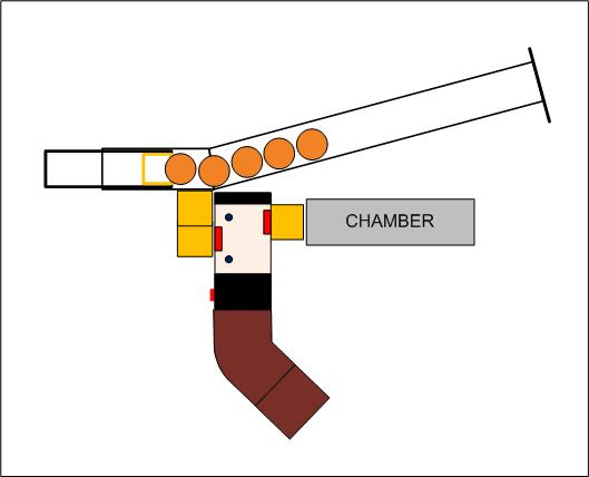

Testing an idea I had for a semiauto tube fed gravity feed and it seems to work, air goes up into the magazine and pushes the balls back up the tube because of a small amount of air bleeding out of the top of the tube, when the pressure builds up enough the front ball pops out like a cork as there is a narrow piece at the start of the barrel, (3/4" copper)

Nice work. I like it for its simplicity. I assume that the tube that houses the large balls is plugged at the free end?
What pressure do you use to shoot? I would like to build one to launch projectiles in the shape of grenades, but with the same shape ...

There is a loading gate which is not a tight fit so it lets out enough air to keep the balls pushed up, it fires really good at 100psi.

ok I understand. I plan to use around that pressure that you use, 7 or 8 bar, because much more is more complicated for me. In the future I will build it. Good idea of yours to arrange the tube that houses the balls at an angle, because it is comfortable and aesthetically good. Placing it at 90ยบ with the firing barrel would be an aesthetic aberration and much more uncomfortable. As seen in the photos he is beautiful, and compact.
