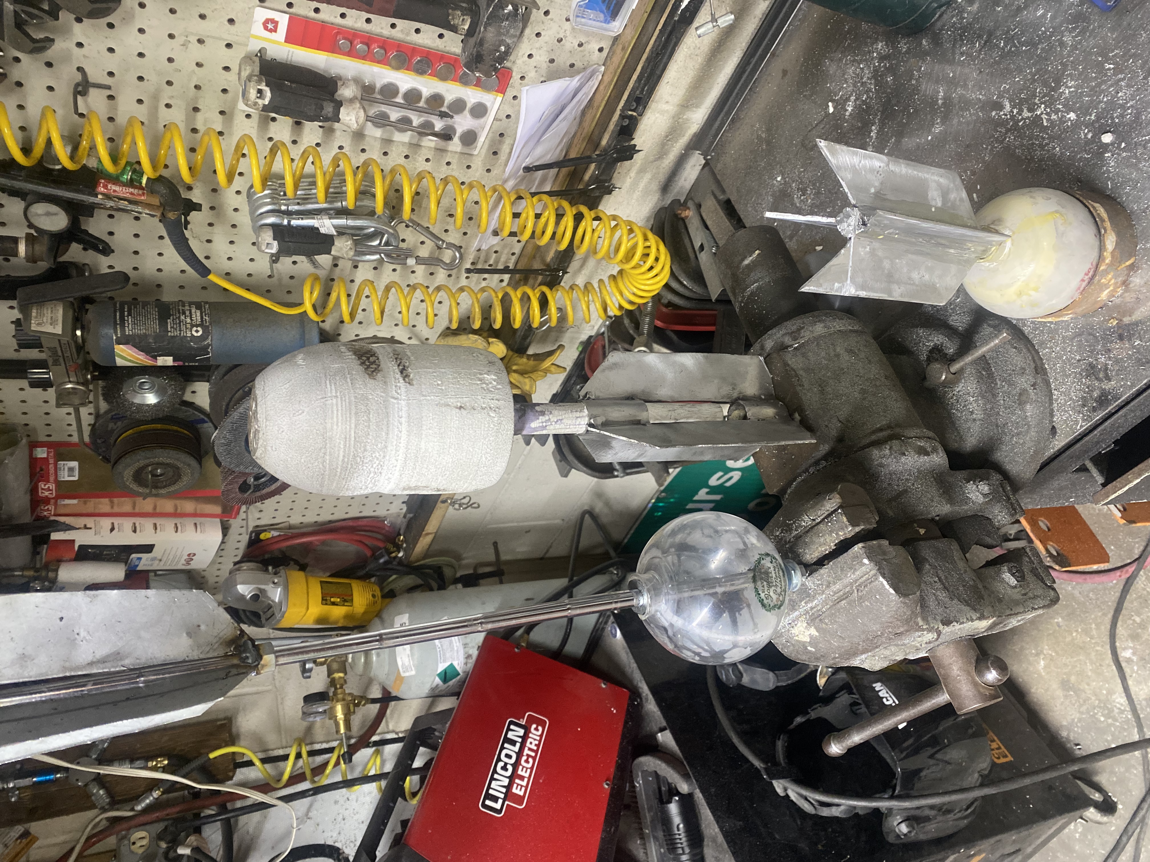

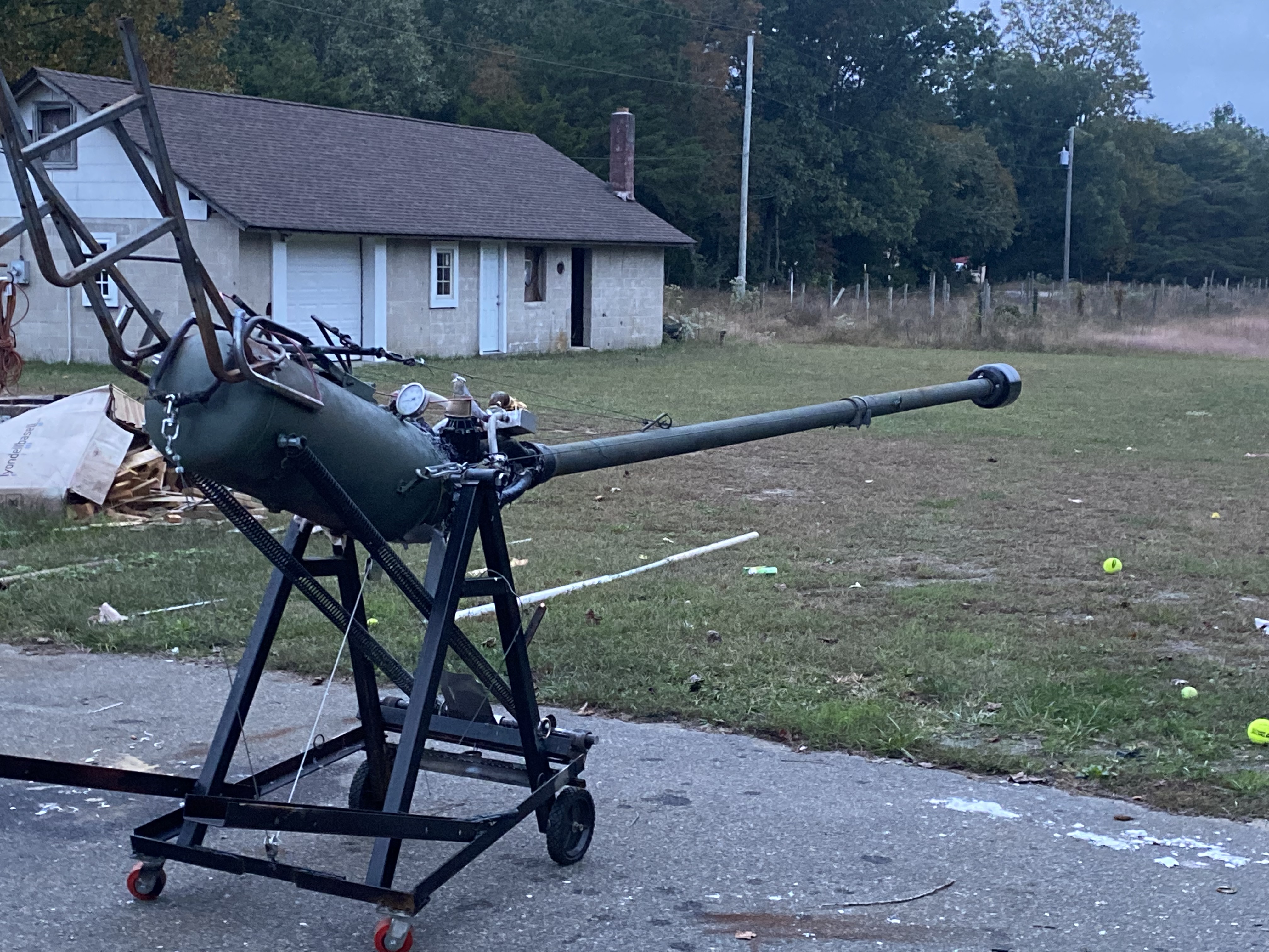

What I have is a 26 gallon compressor body shooting at 100 psi is a 1 inch electric solenoid, 4- 2inch modified irrigation valves with 1 inch tubing to a manifold and for 2 inch exhaust pipe going from each valve to the barrel that a 16 foot long and 4 inch diameter. The projectile is 1.4 pounds and had a flight type of 16 seconds at a 45° angle Can anybody suggest a better round for the further flight I have PVC I turned down on a lath With an aluminum Dow was for fins welded.

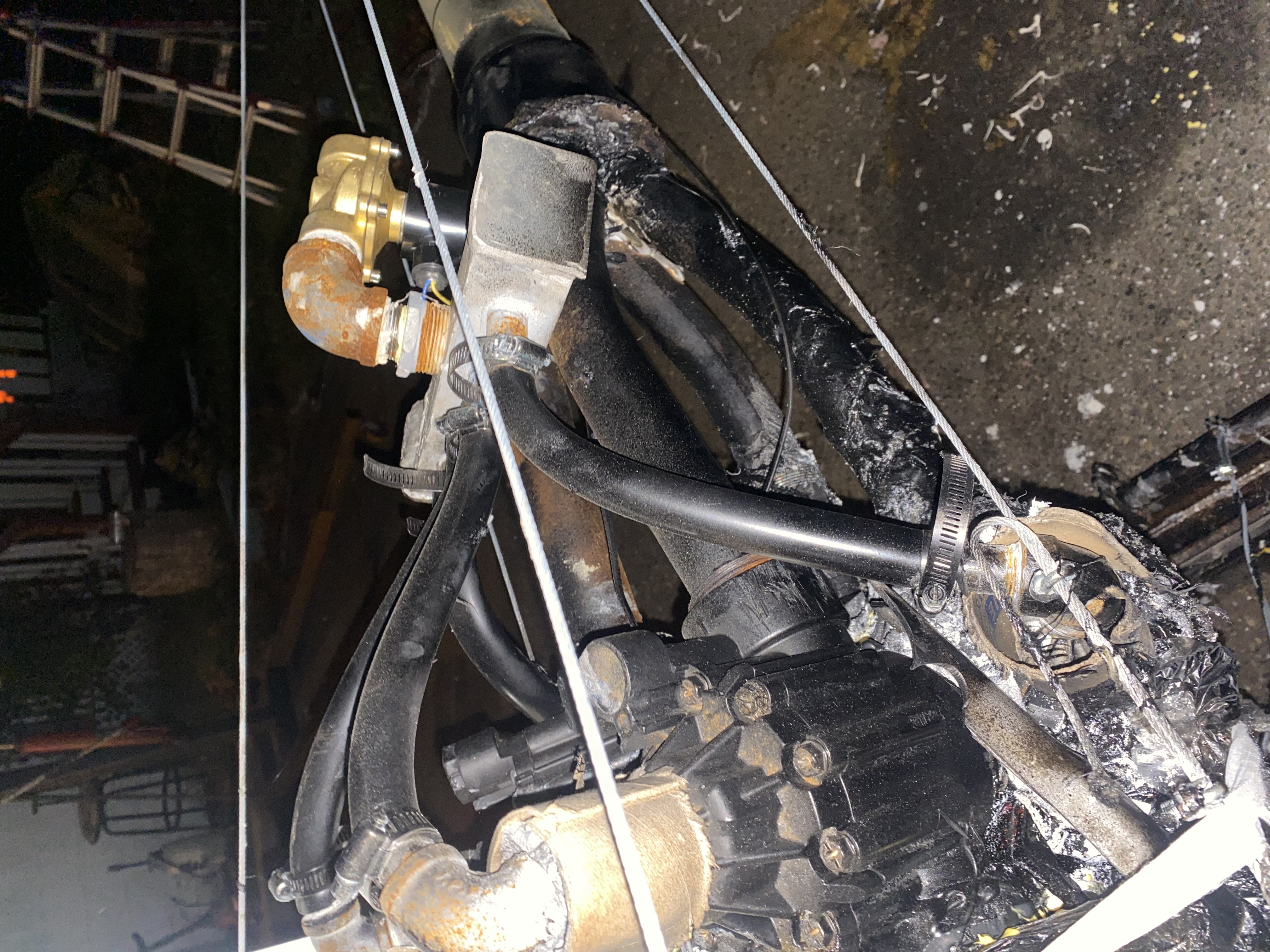

With four valve in parallel, I wonder if the opening of one inhibits the opening of the others? Do all four valves actually open together or do they inhibit each other?

All open at once same size hoses,

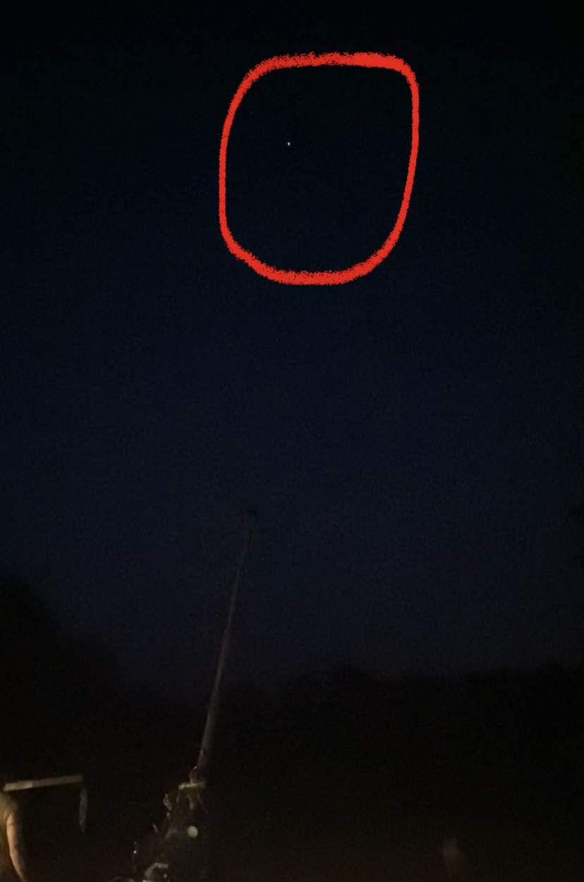

good news while it was fun to refresh my trigonometry and kinematic equations I found a projectile calculator online
as soon as you enter an initial height time in flight and angle you should get a result https://www.omnicalculator.com/physics/ ... ile-motion
based on your 16seconds at 45 degrees I got an estimate 364fps speed and a distance of 4118feet

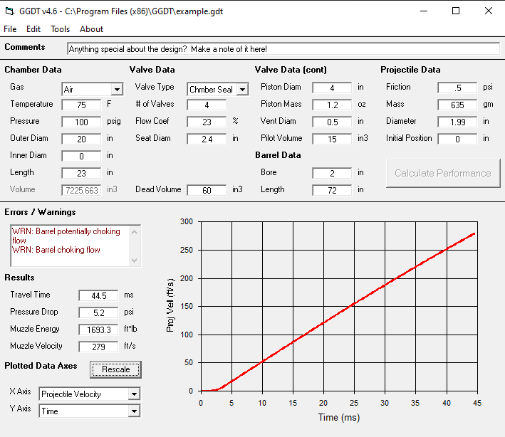

so I ran some of the dimensions you gave through GGDT I approximated some numbers line the internal dimensions and weight of diaphragm on the sprinkler valves the program really lowballs your estimate velocity at around 279fps and tweaking numbers around didn't really help,
going back to projectile flight calculation I'm inclined to believe it's closer to the higher numbers if you tweak the projectile motion calculator it says you'd have to have a flight time closer to 12 seconds for the velocity to be that low
- ggdt americannon1.png (24.72 KiB) Viewed 18506 times
