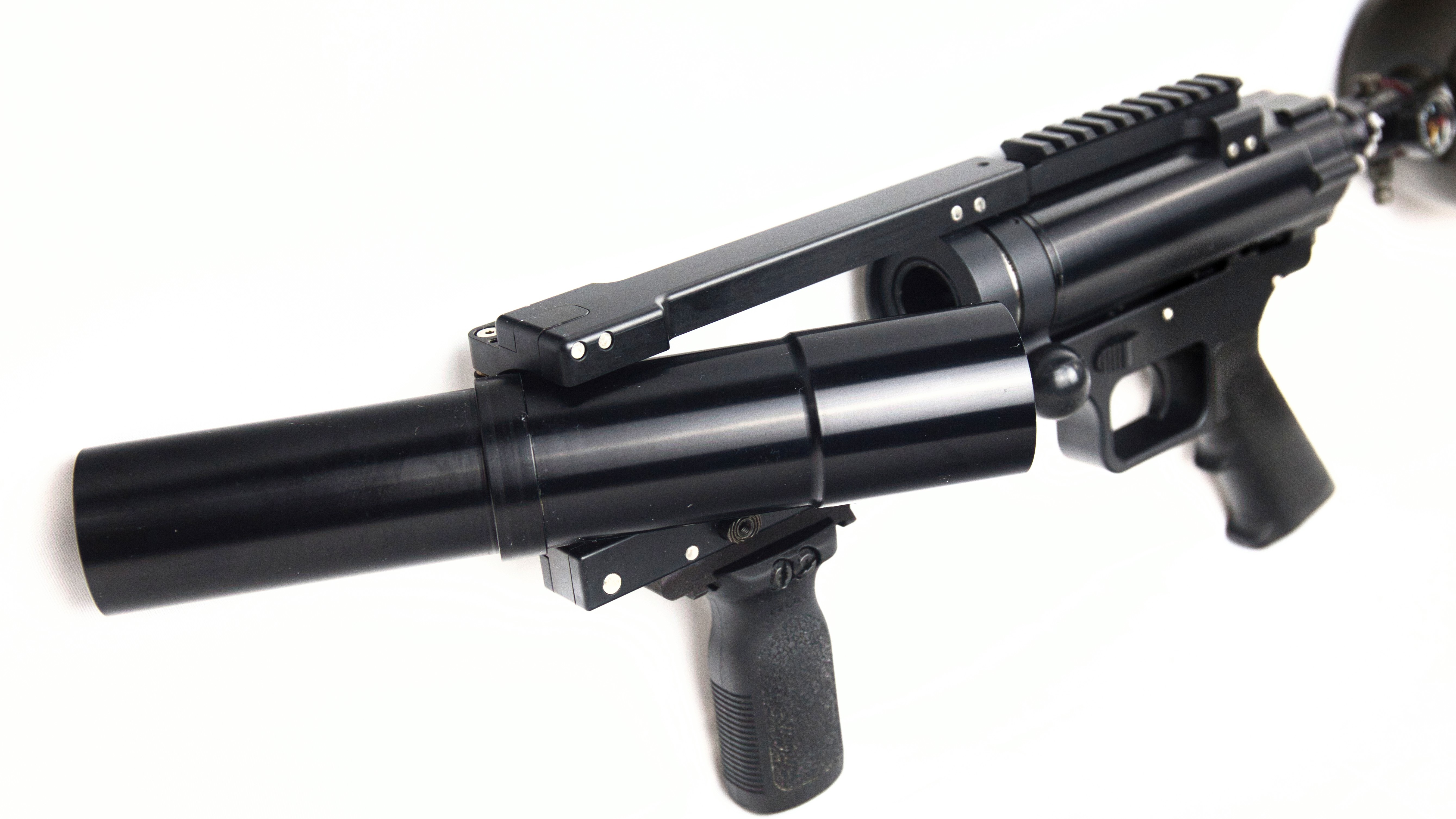

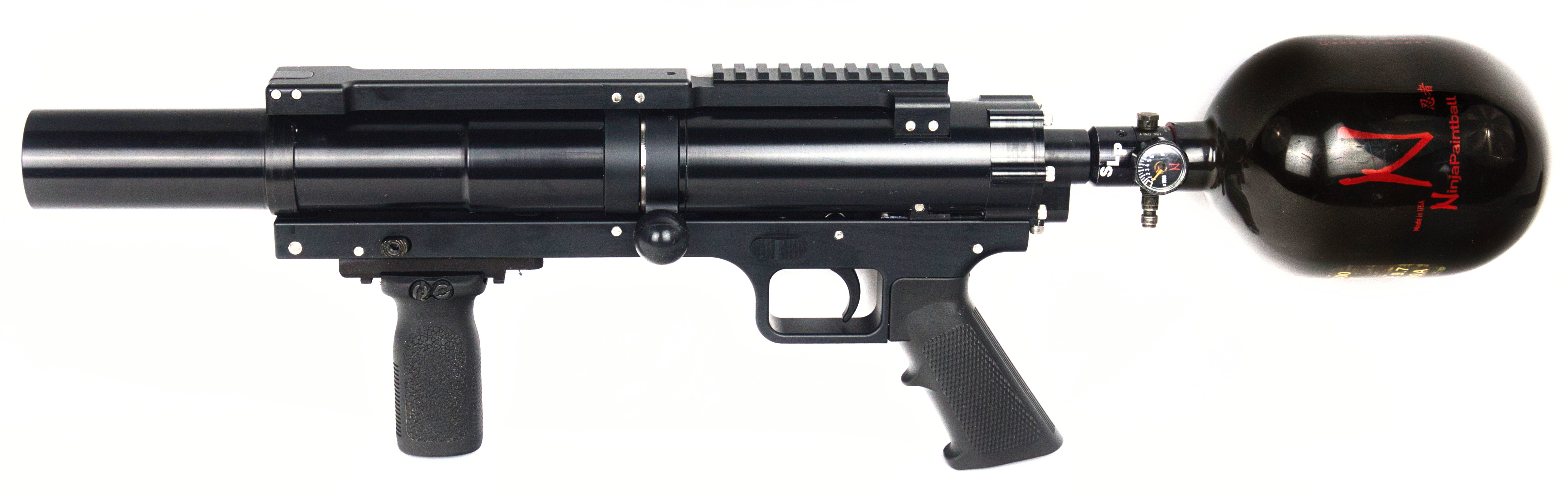

Eclipse 37mm rifled or smooth bore straight pneumatic with variable velocity control. Positive firing pressure piston valve with 1200psi max rating.
Side-loading breech with release activated by fore-grip. Can be configured case-less or to chamber glass filled nylon telescoping ammunition casings. Next update will have full length picatinny top rail, extended picatinny fore-grip mount and option for 15 degree ASA tank mount. Typical operating pressure of 380psi will propel 23 gram projectile at 400fps or 73 gram projectile at 225fps.
