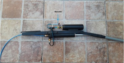

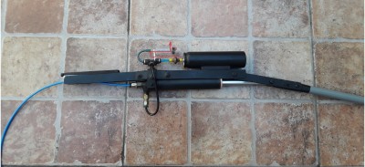

This is the simple system. You only press the valve of the commercial aerosol for one second, which is enough for the butane that enters to sweep all the air and the syringe that fills only with butane, (red line) and then you only use the pump to introduce the mixture into the weapon. The suction of the pump when it draws air introduces the gas inside the pump cylinder and then sends it mixed with the air inside the combustion chamber, it is infallible. The internal volume of the syringe is the dose, in this case 5.5 ml of butane. When the air is sucked in by the piston of the pump, it drags all the butane that was already in the syringe. Very practical.
If you use a piece of hose used in pneumatics, for example with an internal diameter of 2.5 mm, you have 21 cm to be a cm3. You can calibrate with much more precision the volume of butane, increasing or decreasing the length, with infinite more precision than with a syringe. For someone to try to measure 0.01 cm3 less with a common syringe, it is impossible! With the hose I describe, you only cut 2.1mm and you're good to go. In addition, the air in the hose is displaced by the butane with much less butane waste, and you eliminate some randomness caused by turbulence in a dispenser with a syringe geometry.
It is clear that the procedure that I expose here is to pressurize hybrid weapons but the point is that wasting a little gas and / or air, in any case, is a cheap price to achieve something practical, that can be fired without having to carry out a paraphernalia of connections and disconnections and measurements etc...that's my point.
