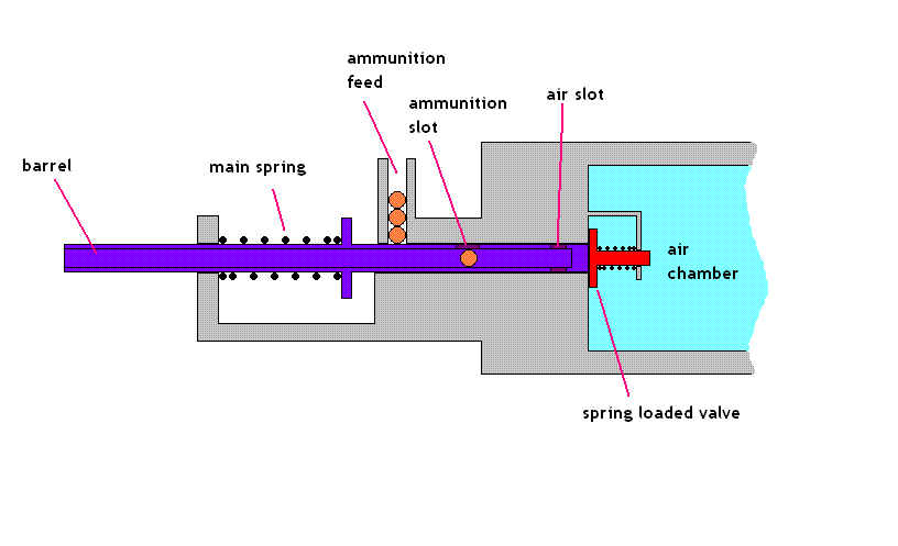

Herewith my addition to the unusual vintage airgun stable, the Benjamin 30/30. This particular example was purchased as "unrepairable" but is in quite fine condition and appears to be complete:
Internal diagram showing the unconventional mechanism. The barrel assembly is pushed forward against a spring and held by the trigger. A BB from the ammunition tube can fall into the breech and is held in place by a magnet. When the trigger is pulled, the barrel assembly moves towards the rear, picks up a BB and then knocks the valve open, firing the BB.

The plan for this one is to turn it up to eleven, basically make an HPA chamber with a greater volume and that can take higher pressure, and a balanced valve in order to be able to use the original hammer mechanism at greater pressure. Here is a tentative diagram of what it might look like, although I'm not entirely happy with it:

The system of this rifle is very creative. I like the idea because it comes out of the conceptual "box" and is repeated all the time. There is always a different way to do the same with its pros and cons for sure. Nice acquisition! :)
Adapting it to pcp would improve it substantially, and it will increase the power. The balanced valve thing is a good idea to keep the force of the "hammer - cannon"'? :o
I definitely have a weakness for old and unusual airguns :)
I was unaware of this design when I posted almost the same idea 15 years ago!
It's amazing how many ideas and designs we think are original that have already been thought up and, in this case, actually made and commercialized.
By greatly reducing the force keeping the valve closed, you can use much higher pressures without the need to "hammer" more violently. Normally this is most useful for a bigger bore airgun, but in this case as the mechanism is a little fragile at the point of impact I don't wish to install a stronger spring.
