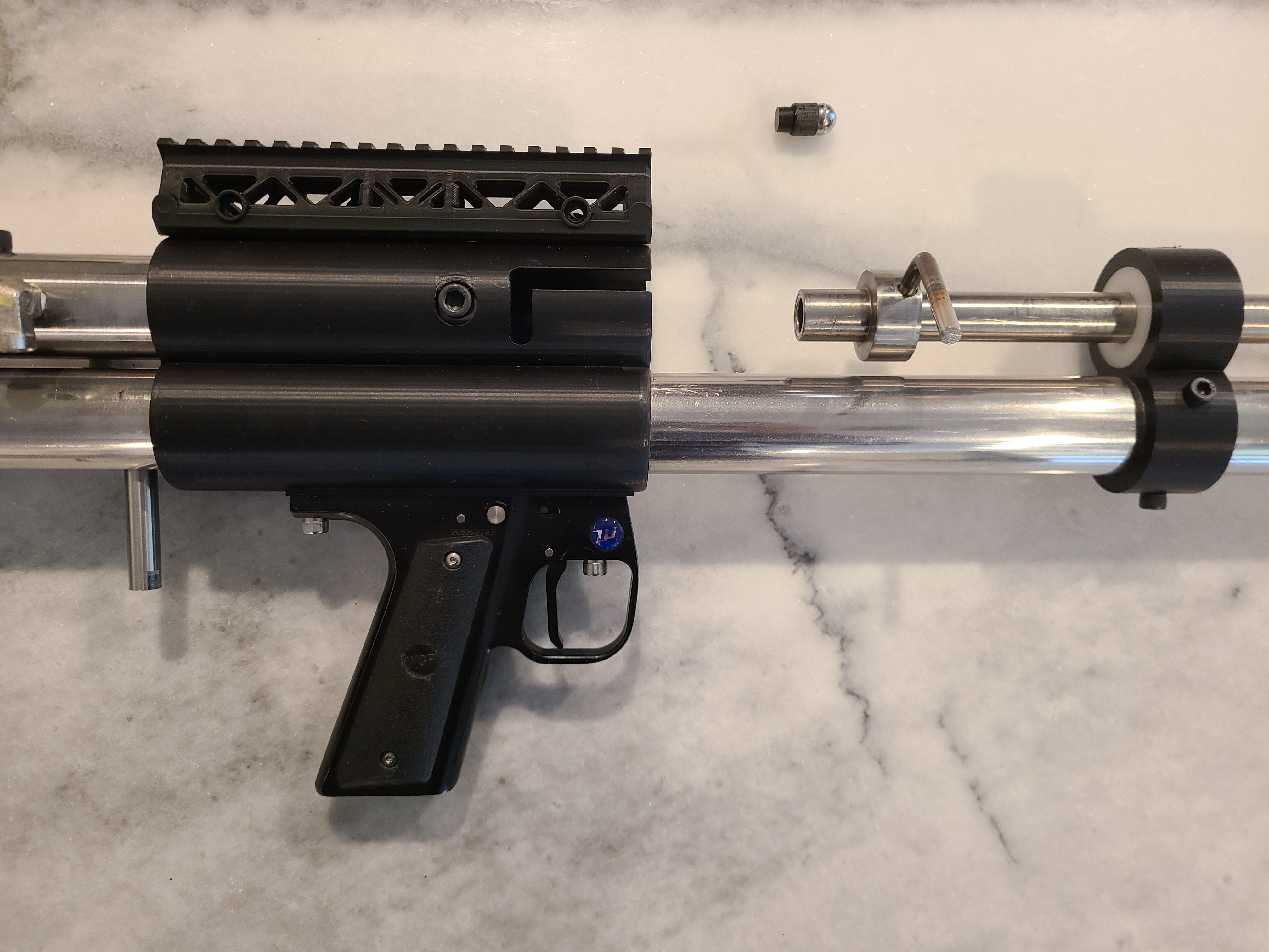

Here is the gun as it currently sits. All black portions (aside from handle) are 3d printed with Pla Tough. The handle is from an old paintball gun I had, with the sear extended to reach my hammer and re-hardened. The barrel bushings are turned out of Delrin.
Below shows the Barrel in the locked position, and in the Loading position

Below shows the hammer which is mounted in the lower tube of the rifle. I wanted to have as long of a barrel as possible, and didn't want the air to have to work its' way around corners, so this configuration seemed the best. The top piece of steel is what actually makes contact with the pin on the hammer-valve. This was measured to just barely open the valve to its' maximum depth without smashing it into the Piston on the other side. The lower portion of these pictures show the hammers larger mass, as well as the face that presses against the sear.

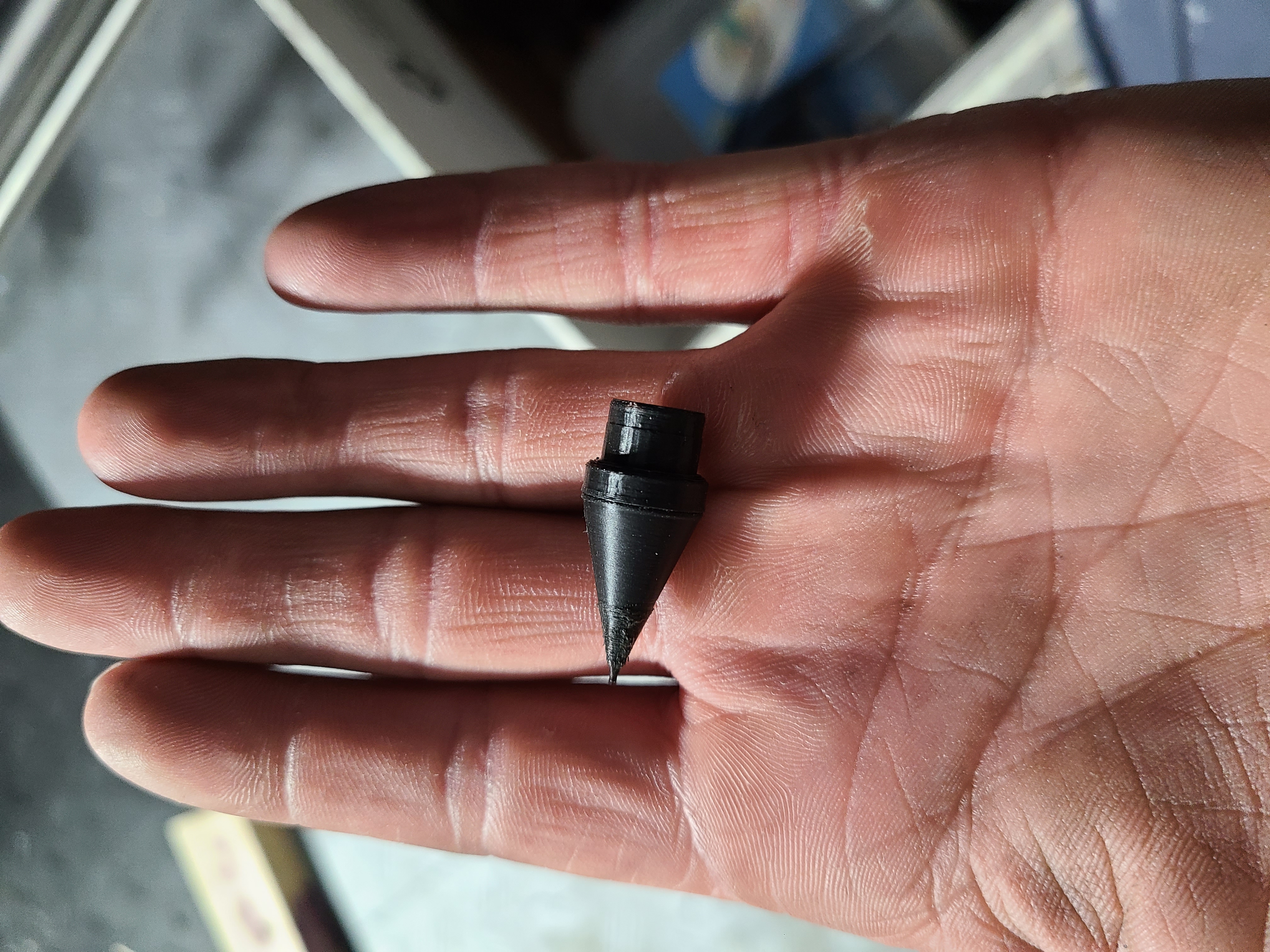

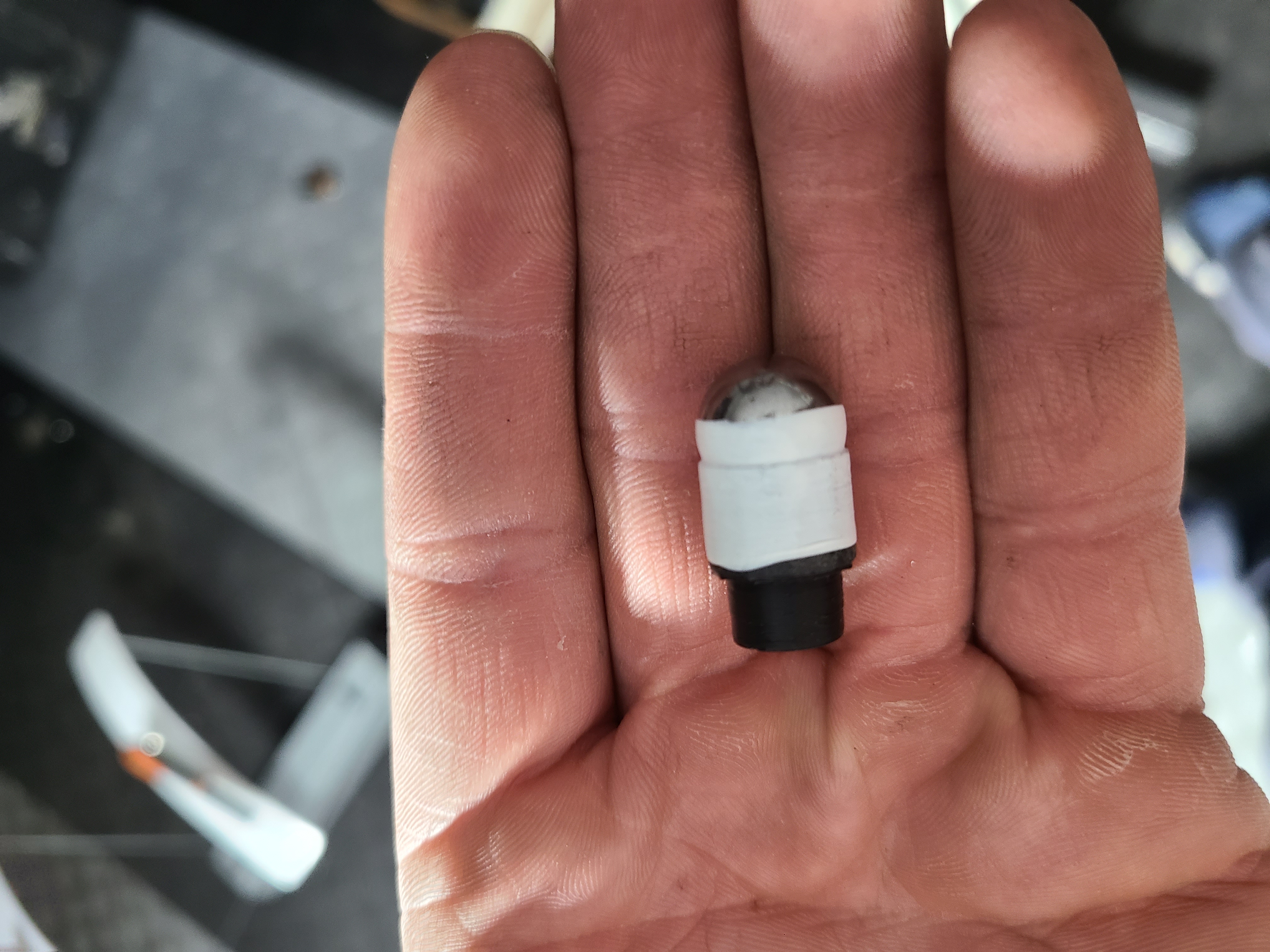

Here is the primary ammunition I shoot. 3d printed Sabot, with a spherical opening in the top for a 1/2" ball bearing to be glued in. Extremely cheap for what it is. Note the rear end has a small protrusion. This protrusion fits as closely to the valve face as possible, to avoid dead space.
Obviously this rifle is not finished yet, but here's where it's at so far. I have yet to hydro-test this valve, so I haven't pushed the system past 1700PSI. Burst calculations show that the materials should be able to handle up to 12000psi, so my eventual use of 4500psi should be safe (once again, pending hydrotesting to a higher level).
At 1700Psi, a very lightweight 3d printed projectile will break the sound barrier (I'm still not completely clear on how an expanding wave of pressure can propel an object faster than that mediums' speed of sound, but it does), and the steel-bearing round will run at something just shy of 800fps.
