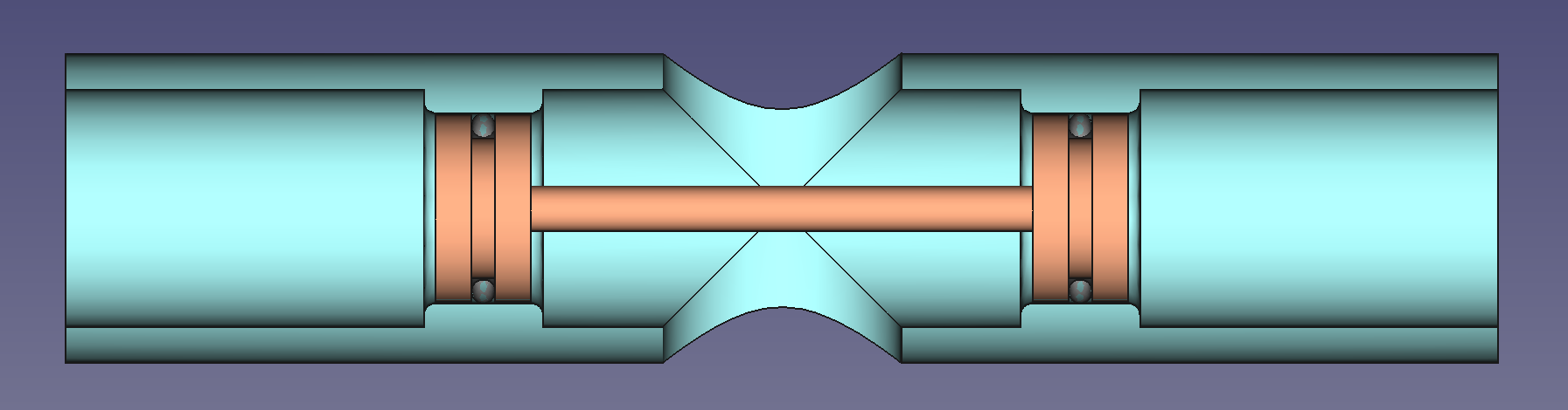

Theoretically, a spool valve like you built with one moving part should be very reliable. However, you probably need to look into how the seals on DCV's are done, O rings rarely like to move past porting, having the o-rings seal in a section of the carriage slightly smaller in ID than the portion that's ported with a chamfer would be better, here's a quick picture:

Im thinking the floating nature of my orings (they were a slight compression fit in the cylinder) could be the main culprit to the leaking, as the spool might have been free to 'wobble' an imperceivable amount causing the cylinder to wear slightly as well as the orings. Makes sense when you stop and think about it i think.
I had noticed both orings were leaking too, and one never crosses the ports.
One day soon I will get this finished and into something that actually launches things. For now, this roughly shows the state it is at before trying your suggestions:
Overly complex maybe, but i wanted the feel of a mechanical action that sets and then arms the valve, and a button to trigger it. This was also intended to make its performance consistent.
The idea was that the spring would make the valve start to open at the same speed every time, but i have noticed that with a spool valve, the backpressure from the projectile is the stronger driver of opening speed.
Also, to help it open, i had hollowed out the spool so the collar on the sprung rod impacts it to get it moving. Before that, the o-ring sticking friction at higher pressures was too high for the spring to move it.

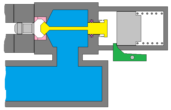

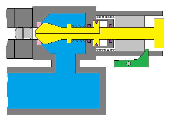

I'm reminded of some designs I had proposed elsewhere in an effort to improve flow in a pneumatic gun compared to a conventional hammer valve.
This was one idea:

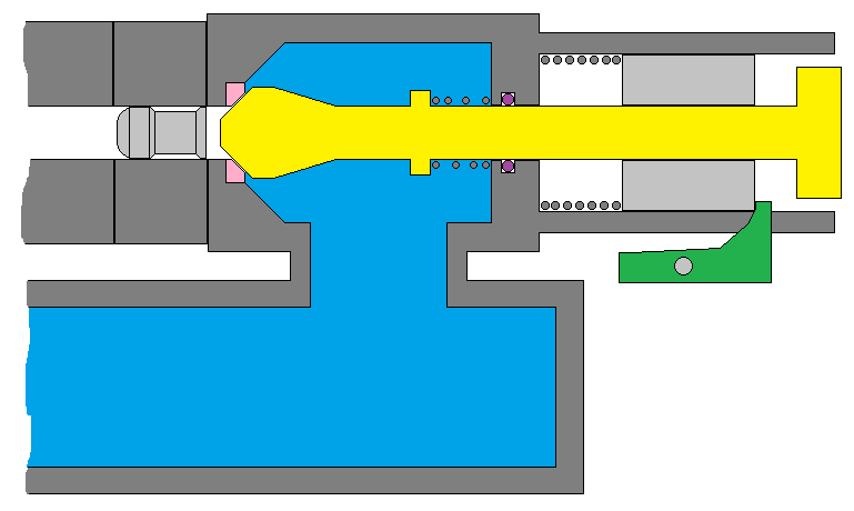

However with the valve configured to retract the poppet rather than push it into the flow, dead volume is reduced and flow looks like it would be better:
The fear however was that the differential pressure once the valve was open would lock it in place and dump the chamber, so a balancing element would probably be necessary
Click for animation:

I like the last animation .
With the Grub screw restrictor to adjust the air port so then adjust closing time of valve .
