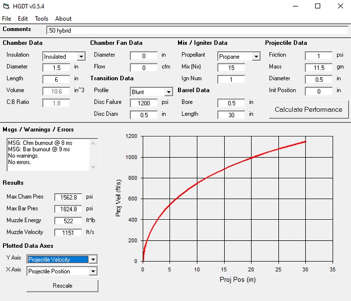

With say a 30 inch long barrel and 15x mix one can envisage sending a half inch round ball downrange at just over the speed of sound :D

My chamber walls are around .23" thick, so I should be able to run mixes considerably higher than 15 and remain in a safety margin. (Mathwise anyway)
Another thought: have you experimented with an *inner* chamber liner with a lower thermal conductivity than the chamber material? If the largest portion of forces come from the expansion due to temperature differential, it would stand to reason that a material less effective at sapping heat would aid in keeping temperature longer and thus keep pressure up
It would indeed make a difference and for example HGDT is supposed to compensate for it, and I can confirm that the chamber and barrel do tend to heat up after firing so there is definitely thermal transfer.
I have not experimented with insulation but I would think that this would not be too significant a difference.
