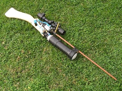

Cannon Name- TVBA-BBS (Triple valve, Bolt Action BB Sniper)
Type of Cannon- Pneumatic
Chamber Size- 50mm X 25cm ~700cc
Barrel Size- 7.5mm bore, 600mm long (7mm bb's)
Gas Source- Air Compressor @ 80psi
Valve- Machined aluminuim Piston valve with silicone seal. Actuated by a pneumatic solenoid valve - Permanently connected to air source, no need to 'recharge'!
Other Special Details:
Barrel is a 7.5mm aluminium tube sleeved in 1/2" copper pipe. I chose this design to create a bolt type mechanisim for loading bb's.
Magazine is contructed of 1/2" brass tube and holds 16+1 bb's
Rare earth magnets on either side of the barrel hold the bb in place until fired and also help with pulling bb's from the magazine
Scope is a Tasco 3-9X40 with laser assitance and backlight sight
MEASURED muzzle velocity of 152.6m/s @ 100psi (500FPS!) using home made chrono (IR led/reciever pair from mouse hooked to sound card)
Can generally group 10+ bb's within about a 3cm circle @ 15m
Currently working on:
Silencer... To be completed in the next day or two!

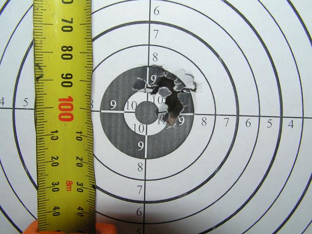

Closeup of target that i was shooting at.  i think this was about 6 shots.  Scope still needs some fine tuning (@15m again) - Video of this coming!!!

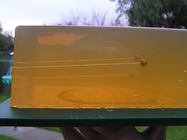

Oh what fun there is to have with ballistics gel.... 9 parts water to 1 part gelatine by WEIGHT! (this was @ 15m, ~18cm penetration)

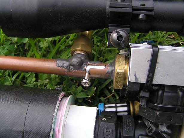

Bolt closed.  bb is held in place by magnets even when it is 'pushed' by the bolt.<br /><br />The two mating parts are angled to make sure they mate well.  There is also some teflon tape around the moving part to help seal and let the bolt slide easily.
Bolt closed.PNG (1.42 KiB) Viewed 11607 times
How the bolt works. <br />Bolt open.... BB drops into barrlel.
How the bolt works.
Bolt open.png (1.44 KiB) Viewed 11607 times
The bolt mech - The grey goopy stuff is devcon 'plastic steel'.  It holds the magnets in place.  VERY strong stuff!

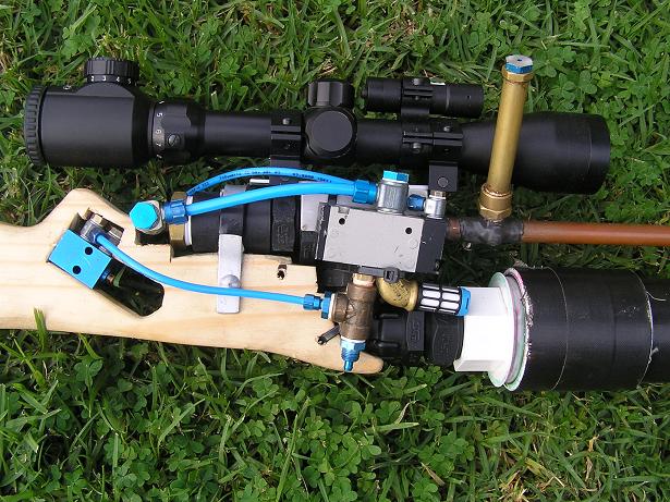

Main valve mech - Air enters from the bottom and permanenetly pressurises the chamber.  When the trigger valve is fired, it forces the solenoid valve to switch the old 'outlet' to vent via the air silencer (black and white thing)

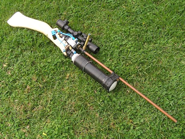

In all it's glory
In all it's glory

That my friend is TOTALLY AWESOME!! :D Thats really cool that you get to use ballistic gel. Isnt that really expencive?
SniperMan
Posts: 22
Joined: Wed Jul 12, 2006 7:39 pm
It's the 'poor mans' ballistics gel.
Get 9 parts water to 1 part gelatine by weight, mix it up, throw it in a container, let it set (in the fridge) for a few days and voilla!
There are official gels and they are more controlled etc. but they are still just gelatine. Buggere'd if i'm gunna blow $300 on some gel for a bit of fun.
This mix is still probably 90% accurate to the real stuff.
