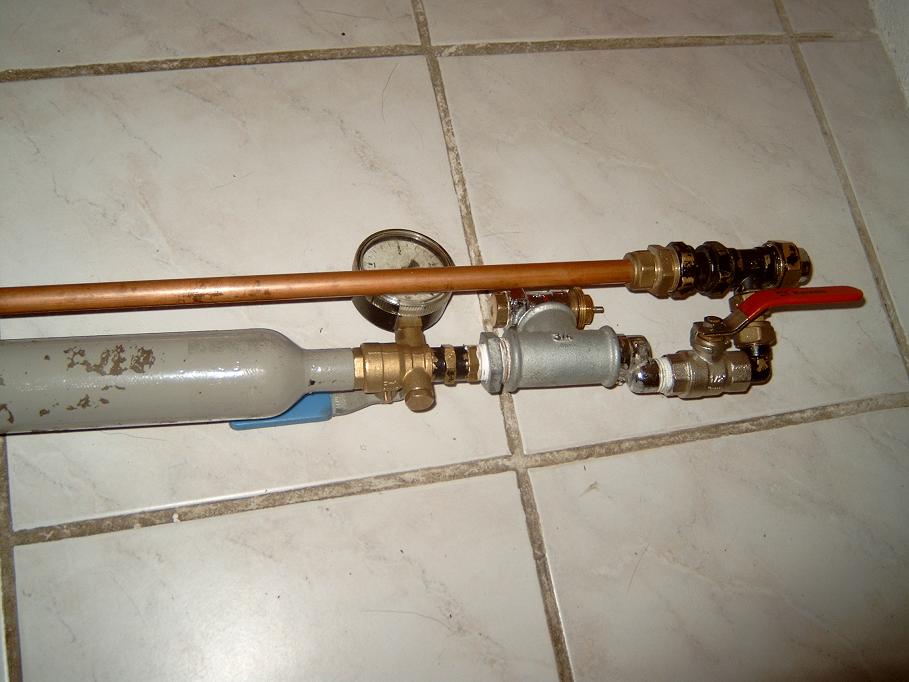

I'm currently working on a full metal hybrid. :D
I use a CO2 cilinder ( rated to over a 1000 Psi) as the chamber.
The ignition is a FIRST EVER percussion cap-striking pin!!
Normally used on blackpowder rifles.
I converted a strange inverted hammer valve( hit to close) into a persussion pin.
I have some percussion caps ( soon switch to the red caps in toy guns) and the ignition works!
The cap litterally detonates inside the Tee, wich is part of the chamber.
The gun is not finished yet, and I haven't yet added the starter-fuel meter.
It is at this stage a simple( well...simple..) combustion, until I get the shrader valve and the burst disk unit in place.
I tried lighter fuel( both spray and gasoline) but ofcourse the mix was too rich.( first time booboo nr 1)
I think the real challenge is getting the mix right in such a small chamber.
On to the pics...

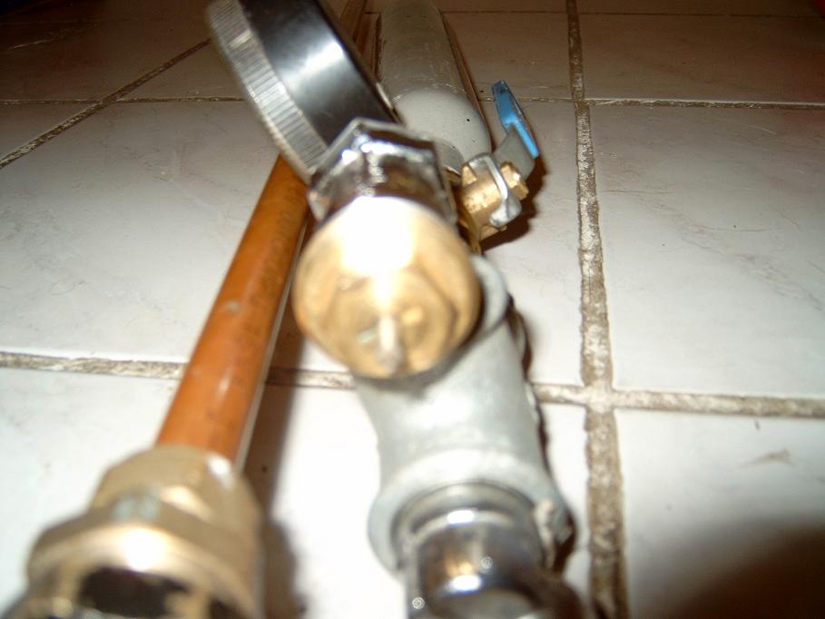

Close-up of the chamber and gauge.Shrader will go in the bottom fitting on the blue ballvalve.

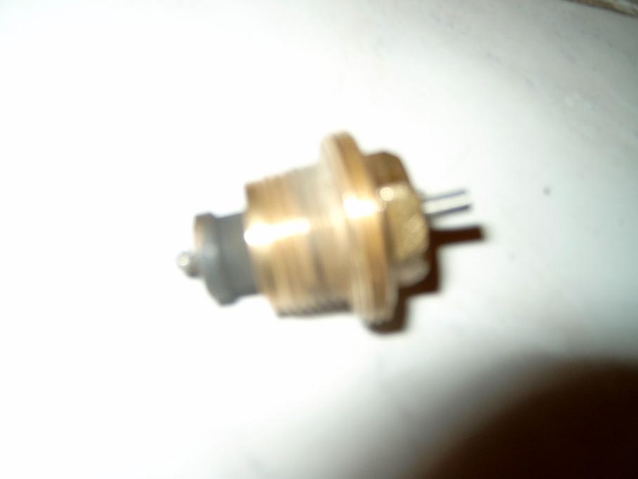

striker pin unit removed

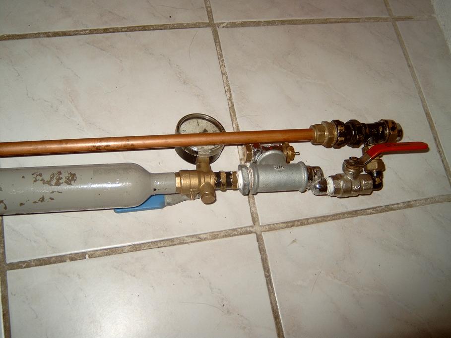

And here is the striker in place on the side of the gun

Damn it!, you beat me to my own idea. :( , In the theories section there is a designed special round that ignights gas with a cap from a toy gun. Just recently I designed a concept(drawn in scetch) grenade launcher which uses similar rounds. The difference between yours and mine is mine has no chamber, except the round which is self contained, and yours is a hybrid. Say the chamber on mine is 40mm pvc with a 20mm projectile. It has a breech barrel that is used to take rounds in and out. Each round has the perfect amount of propane in it and should be re-usable. Designed as a non leathal weapon, or airsoft. I don't plan to shoot anyone.
Well done with this. Toy caps work well and keep a long time in the right place. Hope you get this working.

I thought of the ignition a couple of years ago.Not because I'm a genius, but because I don't understand electronics!!!
Seemed like the simplest way to me then.I posted it on airpower, but that site is no more..

Oh, so how do you keep gasses from escaping from where the cap goes?
