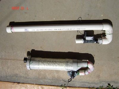

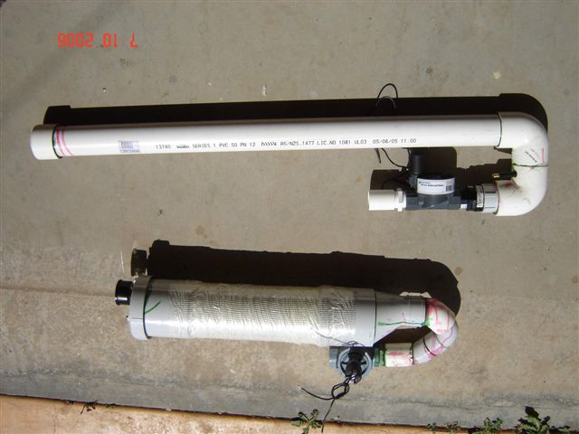

photos show first gun (big chamber) i have had it 40 psi but not sure on the rating of the 4 inch pipe so i woul duse it (cotst me $80)
oh well that the learning curve , shame as it has a gauge in it....
othe runit is PN 12 so once the glue drys (24 hours) will pump to 100 psi and try it
