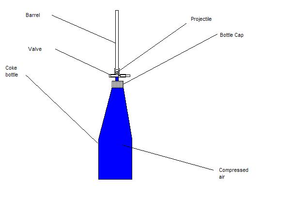

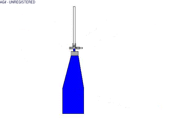

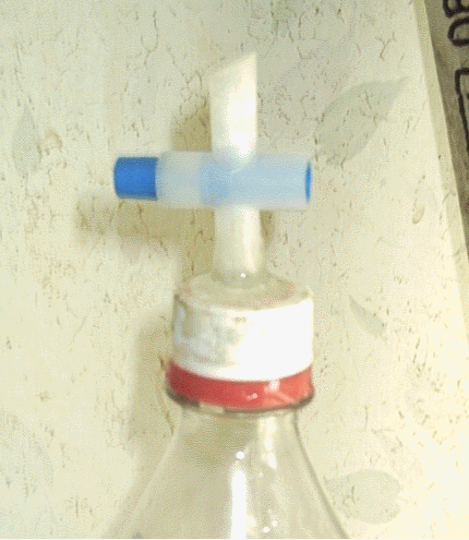

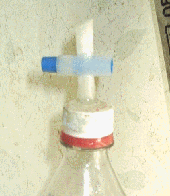

Made my first Pneumatic today out of a coke bottle and a valve i got off of some sort of bag that was made to hold water cant get any acuall pics at the moment but here is a diagram and a quick animation of how it works.
My ammo is anything from Airsoft bbs, spitballs, mini spud slugs.

Here is one it did manage to let me do ill get the other up as soon as i can.
Animation of how it works.
The Diagram
The Diagram

how are you gonna fill the chamber?

It is going to be pretty hard to move that valve because of the pressure acting on one side. Are you going to have a schrader on the side of the coke bottle or are you going to fill it using a different method?

forgot about all that rofl the barrel can come out and i have a tube with a schrader on the end of the tube so i open the valve take barrel off put on the filling tube pump it to desired psi close valve then take off the filling tube load ammo of choise in then replace barrel and fire so far an airsoft bb went through 2 layers of cardboard at 20 psi and the valve inst hard to push at that psi cant go above 20 because my air compressor is a POS lol.

Works fine for me and when i get a new air compressor im gonna be having fun lol anyone have any idea what kind of valve that is its works exactly as its drawn.

Where did you get the valve (as in store)? Looks interesting, wish we could see pictures.

I found it on some water holding thing but it seems to work fine for air to.
