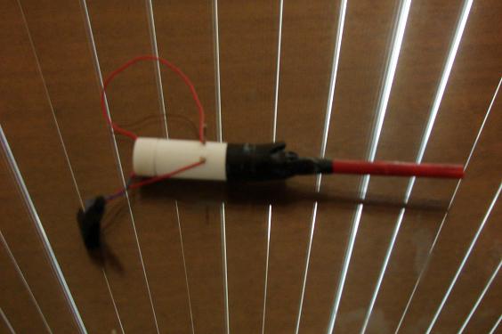

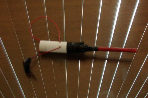

Hey I made this mini out of a tylenol bottle the size of a chapstick and noticed the nice flame-colored glow it gave off. Being one with an odd attraction to fire, I wondered if I could use a clearish 12 oz. coke bottle to see all the fun but keep my skin intact. Only tell me it's safe if you've tried it, I don't want a newbie telling me it's all good then having to explain to the doctor why I have plastic shards in my gut.
Here's my current mini; my sparker broke.
